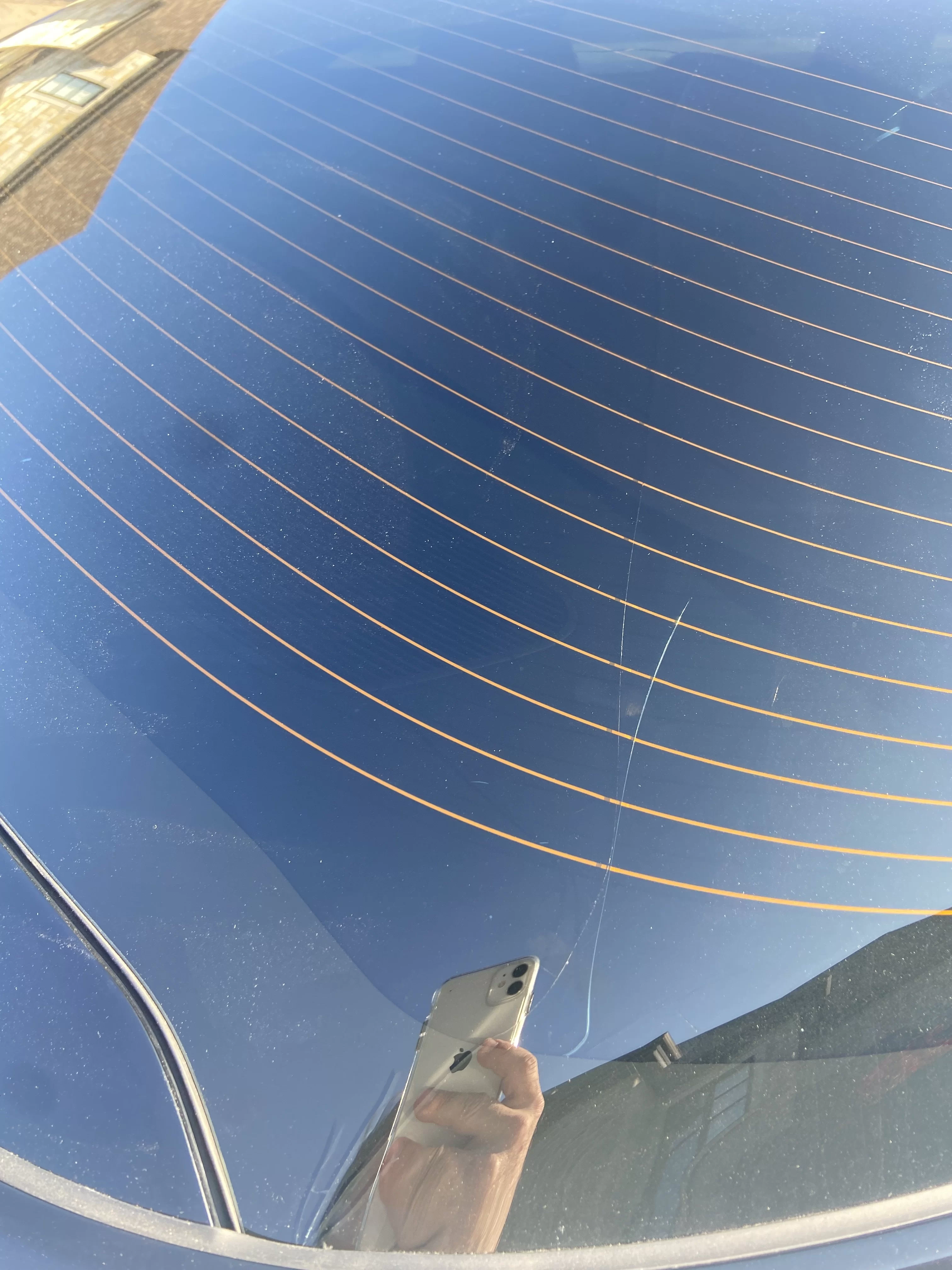

Damn this also just happened to me :(
Obviously no impact or anything to explain it. The car was sitting in front of my house all day in the hot sun and when I went to drive it to the grocery store I notice this massive crack.
Only thing I can think of is contracting and expanding materials due to the A/C and heat

Looks like where the trunk hinge is roughly located. Open your trunk and see if the hinge rubs the spot.
I looked at that and it doesn’t. Also I did not open or close the trunk recently. But it’s not really close to the hinge it’s further back in the "corner" of the glass.
Also if you look closely there are 2 cracks that approximate each other
One in the inside of the glass and one on the outside

Had the same thing happen within 2 weeks of taking delivery with nothing to explain the issue. I got quoted $1600 by Lucid to replace the glass.

Did you fight it? With no physical damage by an external factor, they won't cover it? Tesla had that issue before.

It’s gonna be way way more than that to replace the rear glass by the way
