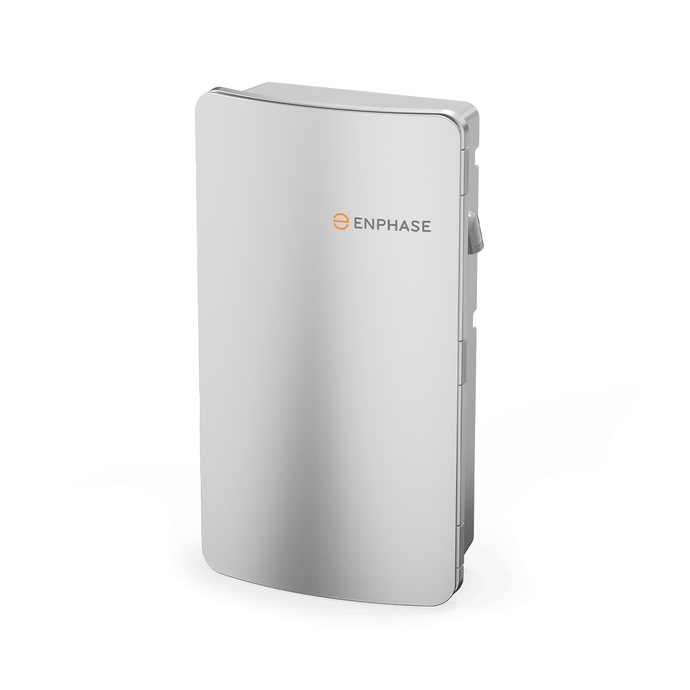

Both V2G and V2H will need something very similar to this $2K piece of equipment: a set of contactors, and an autotransformer, in an enclosure. It's standard stuff for battery-backed homes. The solar PV aspect of this particular box is incidental. PV just adds one more circuit breaker to the box. Installing this is quite a task for an electrician. It could take a day or two depending on your home's existing electricals.
