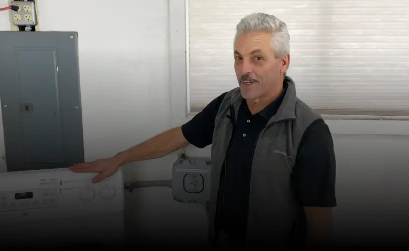

Won’t work with the dryer to split current as you would need full current for it, but perhaps the EVSE can pull current when the dryer is complete. Not an electrician and haven’t looked into it since we have plenty of space on our panel, but it might be worth exploring.
Edit: Found this. Might be your solution -
simpleSwitch | EV Energy Management System & Load Management
simpleSwitch is an EV energy management system with automatic load management that lets you add EV chargers and appliances without costly panel upgrades.simpleswitch.io
You can use a Wallbox Pulsar Plus for this along with their Power Boost CT in the sub panel.
