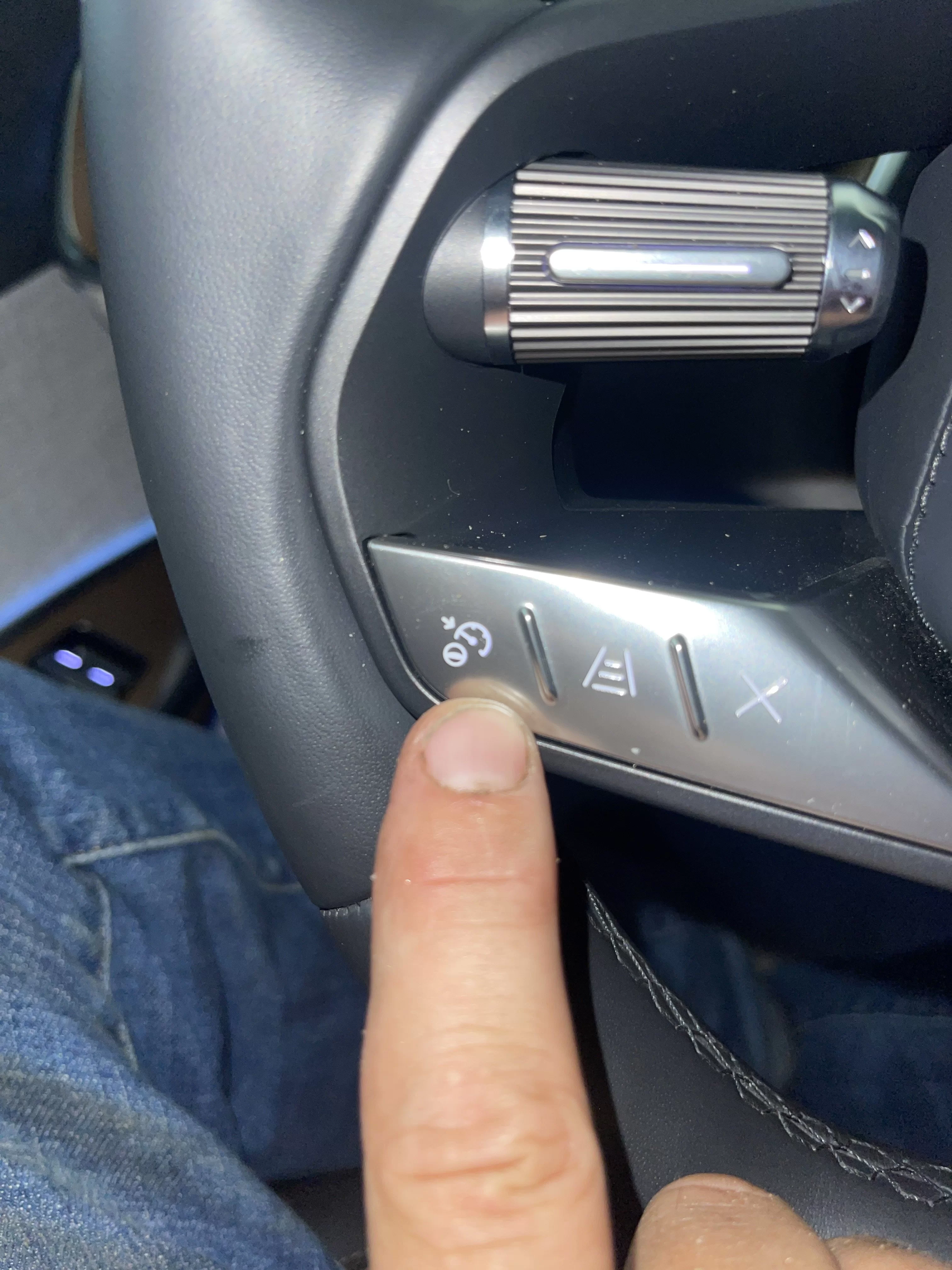

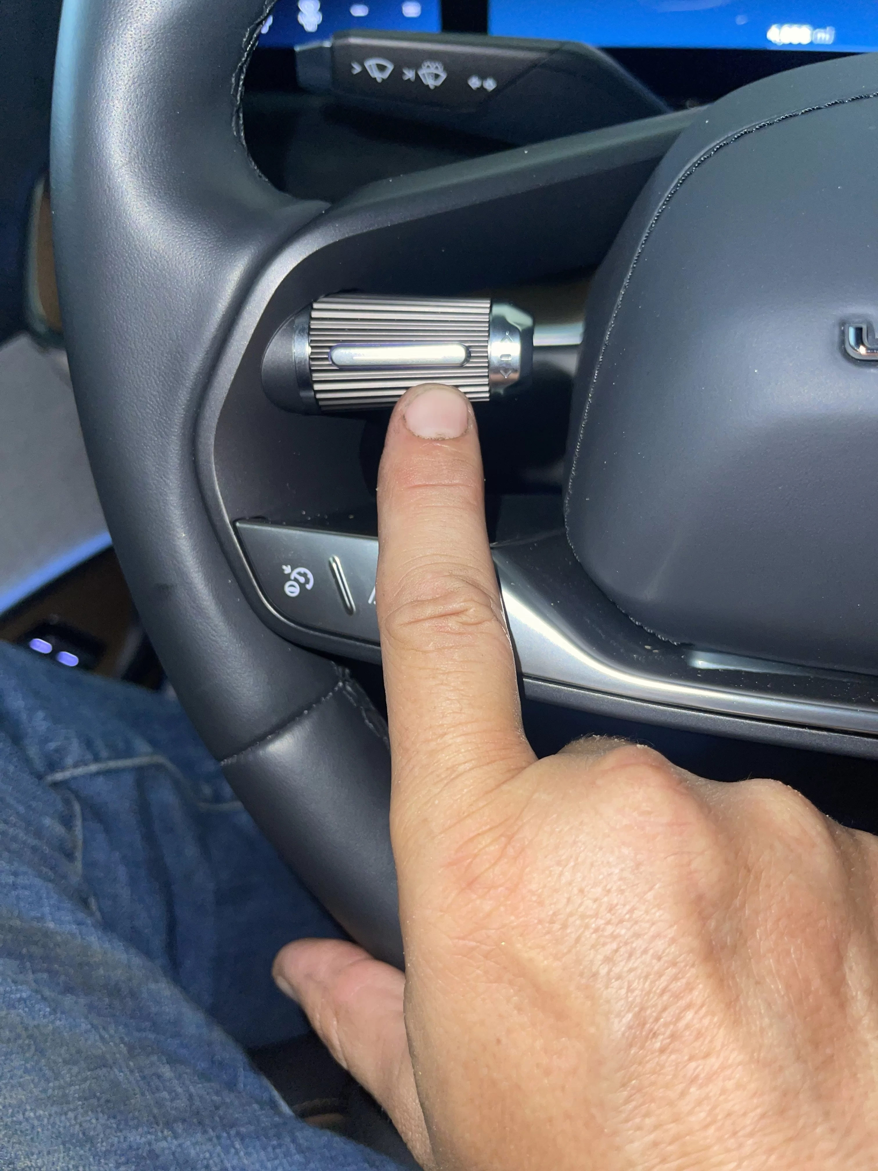

Tap the leftmost steering wheel button to put it into Highway Assist (if equipped) or Adaptive Cruise mode. The vehicle will indicate which mode you are in at the top of the dashboard just above the speed. If the title is shown as in the picture below, in white font only, it is on standby mode. When active, the title will have an amber background. To switch between the two of them, long press that leftmost button. If Highway Assist does not appear, either you are in an area where it is not available or you do not have this option on your vehicle. When you’re ready to activate whichever one, tap the button on the left hand roller. You can then adjust to speed using that roller.
Yes, Lane Departure Protection is the official name of what we often refer to Lane Keep Assist.
This is all covered in the manual, pages 96-101. Lucid Air Manual
The photos below are, respectfully, the activation button, the roller, and the display when active.
