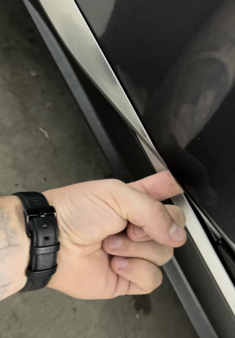

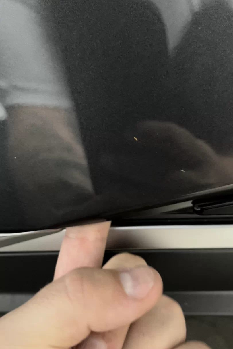

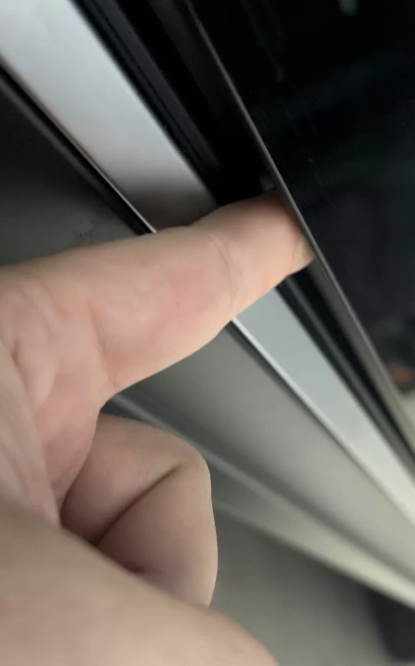

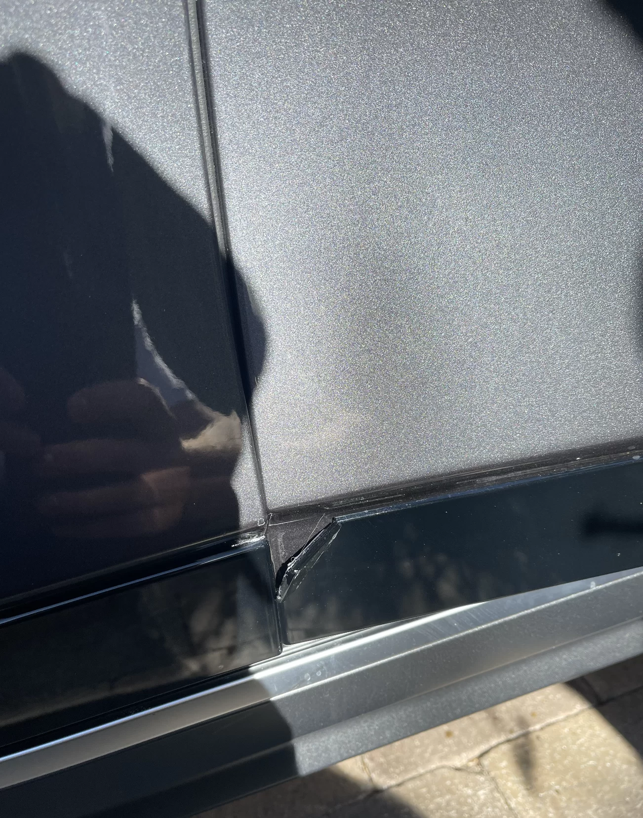

Where would this be acceptable.So I had a lower rocker panel trim piece snap today when opening my rear door as it collided with my front door. It has been fine and the door gap is the same. However, I took a closer look at all the trim down on the lower rocker from front to back and noticed alot.
1) Seems like most of the applique trim is all adhered with VHB tape and no locator pins / doghouses for tolerances. So my car was in the sun for about 5 hours today in 103 degrees and the VHB must of heated up and shifted the trim piece, along with the gap tolerances already being really tight.
2) The metallic trim on the front rocker panel and the rear bumper are really loose. When pushing on one end or the other the whole piece toggles front to back.
3) Right behind the front wheel, there are 4 pieces of trim that come together. Well further examining, I can fit my entire figher into the underside of my door and then continue to run in along my door towards the back of the car. This is not as prevalent on passenger side but still there. This could be a concern for those in wet climates or when winter arrives because there is a large cavity for water/salt/debris to build up in.
Has anyone seen any of these issues? If not might be worth a check as they are not something you see normally, until a piece breaks off like mine atleast.
Other than that the majority of my gaps are fine. No rubbing or clashing. Just your standard small misalignments you'll have with any car. This one just seems to have an abnormal amount of trim layers that when things don't line up it stacks up quickly.
View attachment 2916View attachment 2917View attachment 2918View attachment 2919
