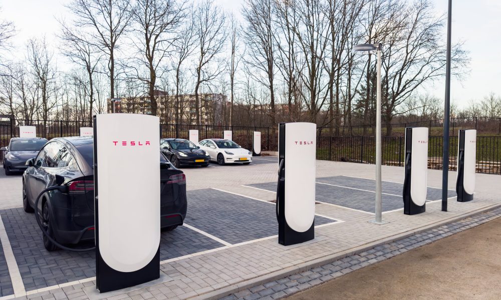

About waiting the proof that V4 Supercharger with 1,000V will work before an agreement: Technically, NACS is CCS compatible so the chance that V4 won't work with Lucid is very slim.
V4 is being rolled out in Europe:
Tesla Cybertruck has 1,000V architecture so V4 will certainly arrive in the US soon.
Those were just V4 dispensers, still being operated by v3 power conversion cabinets. No 1000v V4 power conversion cabinets have been installed anywhere yet.

This is why the “demand everyone go NACS” conversation is confusing to me. I thought once V4 was actually rolled out everyone, Tesla and non-Tesla alike would be able to use those stations, as they’re getting the NEVI funding for that, are they not?
There is no reason for Lucid to incorporate NACS port in their vehicles, as existing V3 superchargers cables will only reach if you park sideways and the voltage architecture is too slow. I know this as I’m one of the few Lucid owners to use the Tesla V3 MagicDock and it’s a pointless experience as even though the handshake and reliability of it is great, it’s rendered nearly useless because of the cable length and slow charging. Peter is correct that the V4 standard is what matters the most, but what this Ford/GM/Rivian decision is doing is spending $$$ and putting pressure on other automakers to spend $$$ to support an inferior standard. This also is a pointless conversation for Porsche Taycan, Ioniq/EV6 owners as well with their fasting charger architecture which has to down-convert to slower speeds to use Tesla NACS via adapter. The switch to current V3 superchargers means LONGER waits to charge and more stress on the chargers, as the charging will be slower for many many drivers than EA/EVGo/Chargepoint. The reliability is the only benefit I see for NACS but that may turn out to not true once you put a bunch of non-Tesla EVs on their network. The point should be to get the cars in and out of the charging stalls as quickly as possible. This switch to NACS will not achieve that.
To summarize, this conversation has no meaning for Lucid until 1000v plus NACS stations become a reality. I think that’s a much more informed rational view than @blueice89 demanding Lucid owners sell their vehicles in protest if Lucid doesn’t immediately commit to putting NACS ports on their cars.
