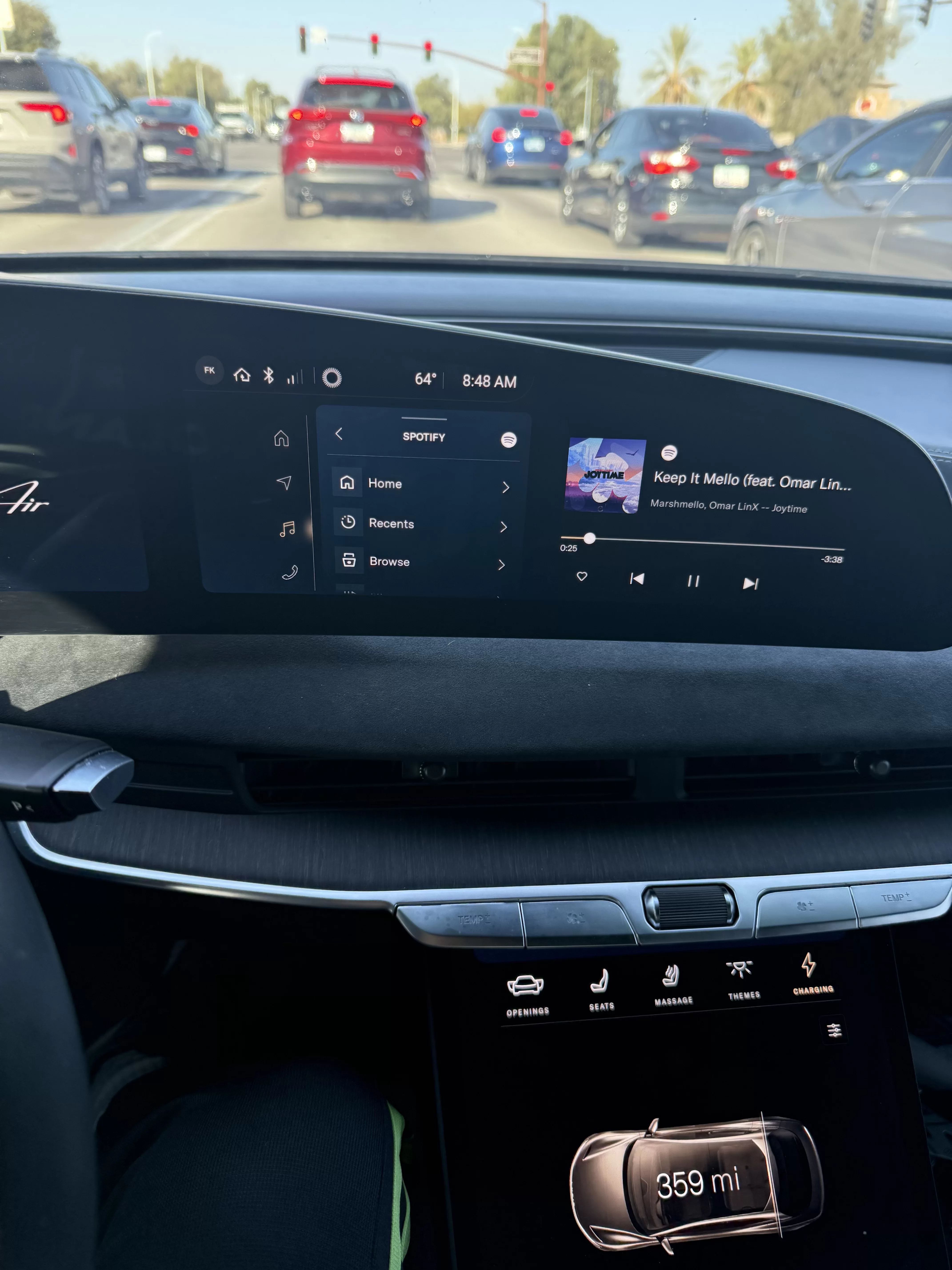

Logging outage: 6:45am Gilbert AZ, I was thinking wow my car is so quiet then noticed Spotify was playing but no sound, tune in had no sound, direct fm tune no sound. Per my routing I opened and closed my car couple times trunk included to load my tennis bag and then noticed while driving it’s offline. It’s still offline if lucid team can check it out now.
This outage recovered by me locking my car and going and playing tennis for 1.5 hours then when I came back to car audio worked again. So this particular incident did not require restart just a lock and leave alone

It happened near 2nd time this week around 8:40am
