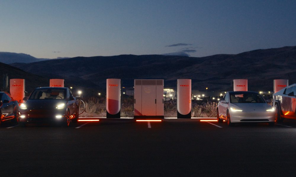

Looks like 1000V V4"s will start coming online in Q3. Probably also explains why Lucid was in no rush to get the Air on the SC network until Q2. If they can get adaptors available etc. then it would tie in to a Q3 launch of the true V4 supercharger given the limitations the Air has on the V3's.
Also, some other EV charging companies are beginning to roll out NACS connectors on their newer 1000V DCFC charging installations. We won't be limited to Tesla sites for 1000V NACS.
