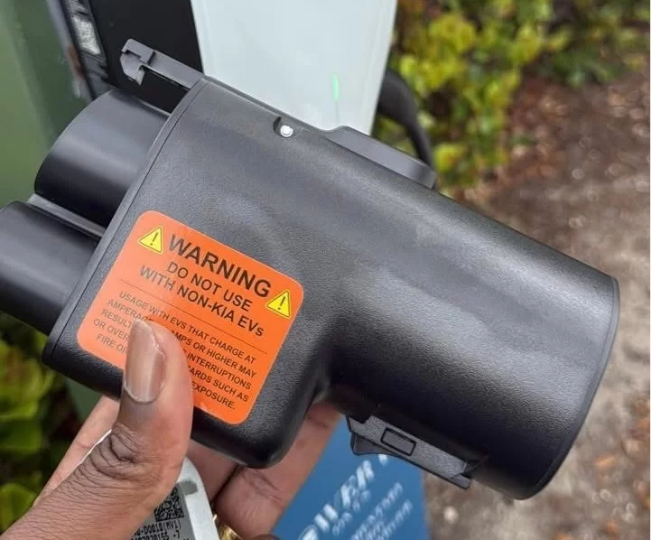

The Hyundai adapter is rated at 350A. It's actually a huge safety concern that there are adapters floating around that can't handle the maximum CCS current. It would be fine to use at a V3 supercharger (I = 50kW/400V = 125A) but unsafe to use at a high voltage/power NACS station.

They did put a sticker on it:

The risk you run of using a third-party adapter is melting components or overheating. For example, if you used the Ioniq 5 adapter, which is not rated for all the voltage/current a Gravity can pull, that would be a bad idea and I don’t recommend it.
