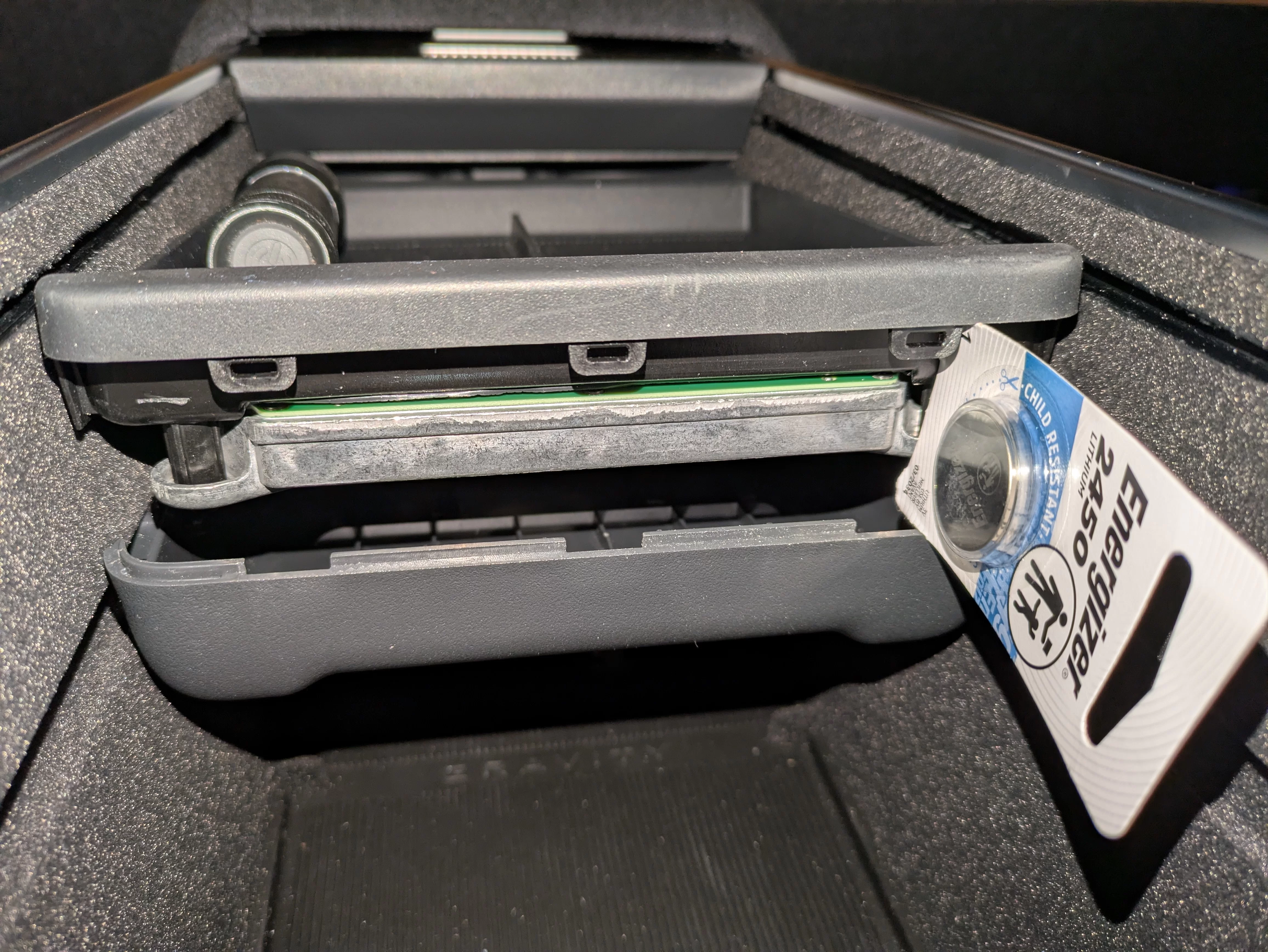

Well my center console has stopped recognizing the key card for driving.
I had the original console replaced last September; a month after delivery.
Not sure exactly when it stopped since I rarely use it.
I probably haven't used the key car for driving/moving the car in about a month. I usually use the key fob.
I'm not convinced this isn't related to the newest update because I don't think I've used the key card to drive since the newest update.
I do know it was working before the newest update.
I usually, out of habit, press the brake after getting seated, but sometimes I fiddle with the music or something else that goes beyond the two-minute window when you don't need to tap the key card. In the past, this hasn't been an issue, until last night. The two-minute window not requiring the card still works.
I exited the car, let is sit for 10 minutes, and tried again; same result.
Let it sit overnight, tried again this morning, same result.
This really isn't a big deal since, if I press the brake pedal upon entry (my norm), I can sit and fiddle for as long as I want and the car goes into gear.
The wireless charging pad still works.
I did notice shortly after the installation of this new console, the cupholders area seemed somewhat loose when removing drinks.
Didn't think much of it until last night, so I pulled on the rear edge of the console, below the charging pad and the tray came up with hardly any effort. See pic below.
Since it's not a big deal for me, I'm considering waiting until my 12-month service appointment to have it replaced; I'll notify them at least a month in advance to hopefully account for the time needed to have a new one at the time of my appointment.

There’s a service bulletin for the center console NFC area specifically. I know your console was replaced, but I am wondering if it’s still in need of being checked out.
At some point, my NFC in center console stopped working too. But, since the B pillar key card fix allows you to start the car if needed, I just put the center console issue on my list….

according to this picture, you've installed the battery without removing the packaging. Amateur mistake.
Too funny!
Thanks for catching that. :)
