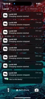

I've had exactly the same problem with my Touring for the last month or two, and never prior to that . My car is always plugged into a level 2 charger in my parking garage, with the charge limit set to 80%. Over the last month, the car has been initiating roughly 20-second long charging sessions every 20-30 minutes, all day and all night, with notifications coming to my app. It hasn't done this previously. I texted customer care and I got the following things to try:
  • Set the charging limit to a lower level for 90-120 minutes and then bring it back up to my original level (80%). See if the notifications continue. They did.
  • Unplug the car and plug it back in. See if the notifications continue. They did.
  • Reset the infotainment system by pressing the Air logo for 10-15 seconds. See if the notifications continue. I haven't tried this yet since my car is parked about a 20 minute walk away.
Customer care seemed pretty confused by the problem. After a while, they elevated it to the App department since they thought it was an app problem, but I informed them that these were not phantom charging sessions being recorded by the app - the car is actually charging (i saw it happen while I was in the garage). Hearing that, they seemed to change their tune. No service appointment as yet, and no answer from Lucid as to whether this behavior is unusual and/or harmful in any way to the battery and the car.
This problem is distinct from the other problem on this thread, that the car stops charging before reaching its charging limit. If anyone has any ideas or has heard more from Lucid, I'd love to hear it.

This sounds like something is waking your car up every 20 to 30 minutes. Since the prior charge took it to 80% and there is always a bit a phantom drain, when the car wakes up it will charge again to 80%. I think it should allow for some loss, like 1%, before starting to charge again. I also have no idea what would wake your car up a 20 minute walk away. Do you leave a fob near the car in the garage?
This has been discussed here on the forum numerous times. It boils down to three possibilities: your charger, the cable, or the car. Before calling customer service it’s a good idea to try to narrow it down. Perhaps use a friend’s charger and see if it has the same behavior. Many have found it to be an increased sensitivity the car has two poorly designed, installed, or selected outlets and wiring. Many have a tendency to call customer service as their first line of defense, but I have found you can get much better results if you do a little detective work first.
Thanks Bobby, I will try to narrow it down. It's just a challenge for me given that I park in a garage about 20 minutes walking from my apartment, so I have limited options when it comes to trying different level 2 chargers that I know to work. Since the garage installed and owns the level 2 charger that is dedicated to me (it is hardwired), I don't have the ability to really fiddle around with it or do my own investigations. But I will see if I can come up with some creative ways to get to an answer.
Previously, the only time the car would start a fresh charge to top itself off was when I opened the app and woke up the vehicle. Now it's doing it on its own. I do not leave a fob near the car - we use our phones as keys and the fobs and cards live in my apartment, a mile away!
Its not the plug since it's hardwired. What lvl2 evse are you using?
I am having the same issue. Car seems to want to top up the charge every time it falls by 1% triggering an alert on the phone when charging is complete. If I use the car and need to charge it, I do not get an alert until the car has fully charged. If it were an outlet issue causing intermittent charging then charging from say 50% to 80% would result in stops/starts and that is not happening. I just turned off charging complete alerts on my phone. Seems like Lucid should provide a bigger buffer before charging starts, maybe 5% instead of 1%.

My garage installed a ClipperCreek (enphase) HCS EVSE. Seems like @par11768 and @Wbo are having the same issue that I'm having.
Sounds like a software bug. Haven't had mine trigger that many warnings after it completed charging. Using a hardwired Lucid EVSE
I am using a ClipperCreek charger. Not sure that is the issue because if I charge from say 50% to 80%, I do not get these non stop announcements, only when fully charged it seems to keep topping up the charge. Seems like something is waking up the car and it sees it is not quite at 80%, charges for a minute then gives a charging complete notification.
Normal behavior. You told the car to charge to 80. If it drops down to just 79% because of some phantom drain or the car waking up by app usage, it will top off. To avoid this, you can always back the charge limit down to a lower number, say 75, after it reaches 80. Or just unplug. Also, many of us have found that turning off Wi-Fi will reduce the battery usage while sleeping.

I was ultimately able to get to the car to reset the infotainment system, as advised by Lucid, and that did not solve the problem. I then unplugged the car from my hardwired EVSE and used the Lucid-provided charger in a 240V outlet. The car continued to give me very frequent notifications of short charging sessions. As such, I was able to rule out the charger, outlet, or cable as being the problem, leaving only the car.
This past weekend, my wife took the car on a fairly long trip, coming home after covering roughly 300 miles with 5% battery remaining. She plugged it in using our hardwired EVSE. It charged directly to the 80% charging limit without interruption, and the rapid-fire charging notifications have NOT returned since then. I'm at a loss to explain why, but I'm glad that they've stopped for now at least!
I’m away for over a month and left the car in my garage plugged in. I’m now getting a message every ten minutes that the car has started charging and then finished charging. Tried lowering the charging level from 80% to 50% but that didn’t help — just got a message that “the current charging level is below the charge.” Lucid said to just turn off notifications which I tried in settings>push notifications but the messages keep coming. Any thoughts ?

Hello - For the last couple of days I keep getting charging started and stopped notifications from the Lucid application. It usually comes within an hour. Does anyone recently have this issue? I used to get this notification once a day earlier. Thanks!
I have been advised that I may have put my response in the wrong area, so here goes. I wrestled with the charger starting and stopping for weeks. I adjusted the charging amt on the pilot panel, I tried charging without scheduling, I tried charging with my app being closed, etc. I began to think the problem may be with my outlet overheating after reading this thread. After many failed attempts, I took my charger to the dealership to be replaced, and the person at the dealership immediately recognized that my charger was not plugged in all the way. Please look at the two photos I've included. Once I plugged in the charger all the way, the charging was not no longer a problem - a simple, quick solution! I suspect this becomes a problem when the charger starts to weigh on the outlet and works itself a little loose.
