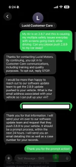

I'll summarize my issues with 2.8.7 and Lucid hasn't been able to push 2.8.9 to my vehicle since it lost cellular reception and won't scan wifi networks :(
  1. Screens randomly shutting off: All three screens (instrument cluster, center, and passenger) occasionally go dark in the middle of a drive. This is extremely dangerous as it leaves me without critical vehicle information or controls.
  2. Drive Assist malfunction: Both Drive Assist and Hands-Free Drive Assist are not functioning at all.
  3. Steering wheel button lag: The buttons on the steering wheel only respond after multiple presses, making them unreliable while driving.
  4. Software performance degradation: The overall software responsiveness has significantly declined over the last 6–8 months. I’m unsure if this is related to a hardware issue (e.g., chip performance) or a software update, but the experience has noticeably deteriorated.
  5. Multiple warning messages: The vehicle frequently displays various warning messages and alerts on the screen, even when no apparent issue exists.

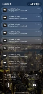

  6. Charging interruptions: The charging session starts and ends repeatedly—sometimes hundreds of times—overnight, even when connected to a stable charger.

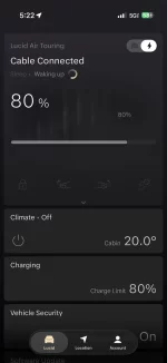

Ok I've been getting that app alert over and over too, once the car is done charging it starts sending that over and over again. Drives me nuts. I went to the App store to see if it was just me and noticed reiews are disabled on the Lucid app too. So hard to say if its the app version or the car.
