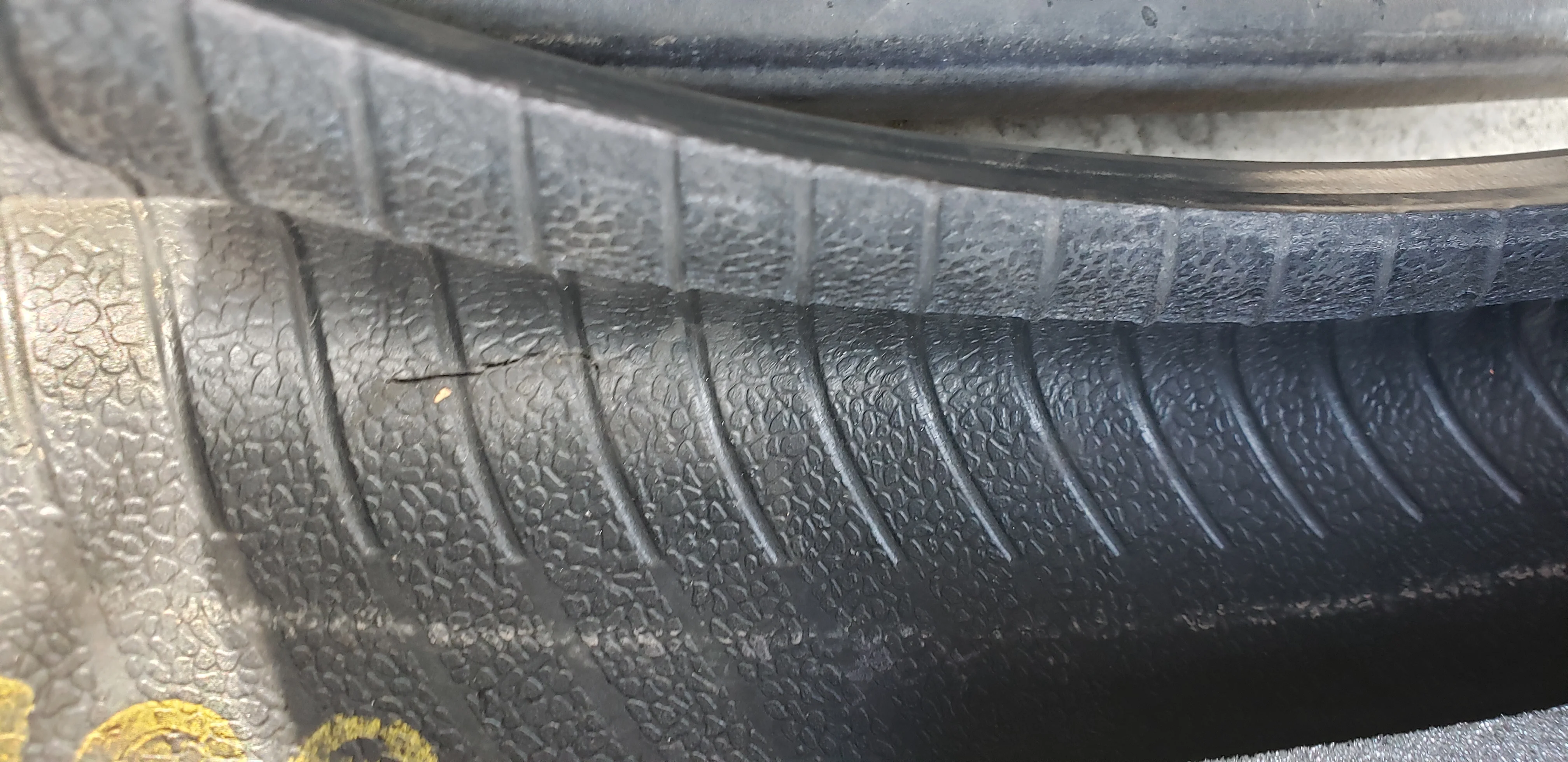

I had the same problem with a tire Bubble. I also have Pirelli PZero Tires. The front Drivers side 21" tire on my Lucid Air GT that had a bubble that recently popped. My Mileage was low and less that 10K Miles, so this also made no sense. So I had the tire taken off the rim to see what had happened, and I found that the tire had been sabotaged. This bubble problem with Pirelli Tires is extremely common with Lucid cars. The sabotage to the inside of the tire which was found was a gash made on the inside of the tire by a short knife or Box Cutter, between the two pieces of added foam lining. The knife cut was clearly intentional, as the gash was clearly made by multiple cuts made by a person, likely left handed, based on the depth being deeper at the start of the v. As can be seen by the photo I have attached, the knife was pressed in a second time in a manner that widened the gash in the tire. I believe someone should cover this under warranty. I don't drive in the Midwest, I drive only in California, and most of our roads are pretty good. High performance tires, like my P Zeros are also reinforced, so should not fail easily. New tires also should hold up. I am working on my warranty. Unfortunately this has happened so often to Lucid cars that Lucid no longer warrants the tires. They don't want to take responsibility. This kinda sucks for us owners. Hopefully they change their minds just due to the facts.

People are sabotaging Lucids?
It is possible I’m misunderstanding, so forgive me if I am… but am I correct in thinking that you want the *warranty* to cover *intentional damage* to your tire?
If so, that’s never going to happen, as it isn’t a defect. You will have to go through insurance if you want it covered.
And even if this is sabotage, how does the OP expect Lucid to cover it? How is this an issue with the tire or Lucid? It's time to call your insurance and file a police report, in case your insurance needs it.
