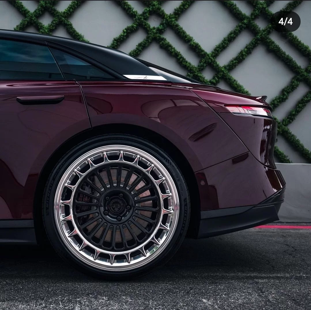

If you find any aftermarket lowering options let me know. I am ordering a set of 22s for mine tomorrow but I can care less about range. I have plenty. I don't take road trips.
Here is a real car. Not photoshopped on 22s

This may very well be (in my opinion) one of the worst visual aftermarket changes I've seen so far to a Lucid. It's just visually overpowering.
I... actually... don't hate it.
