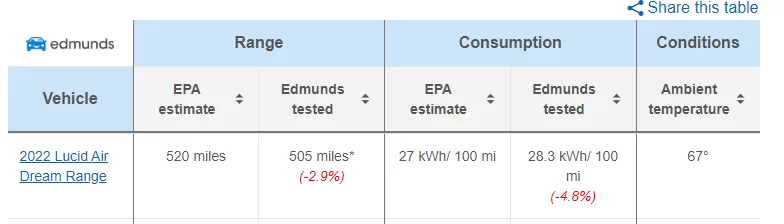

I don't understand the Edmund's data:
If the EPA is 27 kWh/100 mi with a range of 520 miles, that would require a 140.4 kWh battery.
Edmund's test showed 28.3 kWh/100 mi which would need a 143 kWh battery to get 505 total miles.
Not sure how a 118 kWh battery delivers 140+ kWh?
Those EPA numbers include charging losses. That is the difference between the 118 kWhr battery and the 140kWhr that went into charging it.

WOW!!! Lucid has achieved 100% charging efficiency according to your arithmetic. This was discussed when Tom did his fast charge test and the Tesla fanboys were making the exact same claim you just made. Tesla owners had no idea how much electricity was being pumped into their cars because the superchargers don't display that info and the car only showed what was going into the battery - not what was lost to heat, fans, AC to cool the batteries, etc.. And, Tesla was nice enough to only charge customers for what went into the battery. I don't know if EA charges the customer for the electricity required to cool their charging cable too.
The EPA figure is derived from charging the battery from 0 to 100 including the electricity that went into what I mentioned above along with inevitable charging inefficiency. So, yes, it takes 140 to charge the 118 battery. The 22 is lost to charging inefficiencies and supporting functions. This is true for all EVs. The percentage lost just changes a little.

I'm not sure what claim you think I am trying to make
This:
"If the EPA is 27 kWh/100 mi with a range of 520 miles, that would require a 140.4 kWh battery.
Not sure how a 118 kWh battery delivers 140+ kWh?"
You are claiming that if it takes 140 kwh to charge a battery, it must be a 140 kwh capacity battery which means it has 100% efficiency in charging. That isn't what Edmunds and the EPA are saying. You are correct that it takes 140 kwh to charge the 118 kwh battery. You aren't accounting for losses incurred in charging. When the EPA got 520 miles, they then divided 140 by 520 to get .2692 and multiplied by 100 and rounded to get 27 kwh per 100 miles. This is a very fair way of calculating mileage by cost. But that 140 is what needed to be input to fully charge the 118 kwh battery...it is not the capacity. It's the capacity plus the losses incurred during charging. Something I haven't seen discussed is that it seems the Wunderbox and 924V architecture may be a little less efficient than 400V systems in charging and that could be due to losses incurred in stepping voltage up to 924.
What I bolded of your text - the inverse should have been stated - it takes 140+ kwh to fully charge a Lucid 118 kwh battery. That is the fundamental misunderstanding you have stated. No one can charge a 118 kwh battery from 0 to 100% inputting only 118 kwh.
I don't dispute that owners are not achieving anywhere close to the efficiency we expect. I'm concerned too. My hope is that after you've put in a few thousand miles, the efficiency improves. This is why I'm really interested in @Sandvinsd 6000 mile roadtrip and if he experiences any improvements during the second half of his trip.
I was actually trying to claim that I didn't understand the Edmund's data. You know, like I said in the opening of my post.
