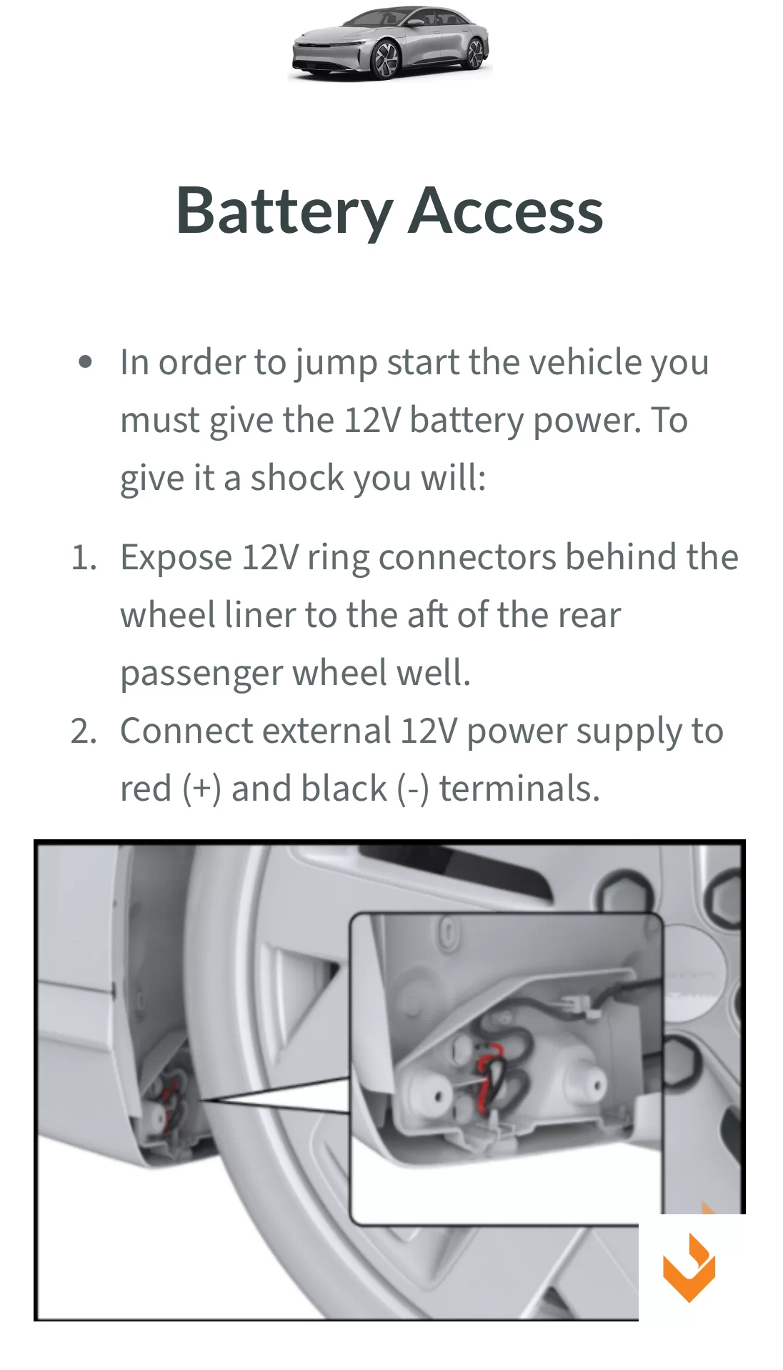

Playing out a scenario with the Rep, I said the Car is dead dead, how do I get in rep told me the tow driver can drag my car with dollies....I was ok then what do I do once I get there. She was like jump the 12v, I was ok cool how do I get to that? She was like uhhhh idk. Great, I looked it up its in the passenger footwell. BUT if you can't get into the car.....see the problem?
REP had No other solutions but to go fuck myself....great help....I'm livid. Kyle from out of spec went 25 miles after 0 way back when, that has to be 3kwh buffer, for fact they must have changed that in a recent update.
Left driver side wheel well underneath the front inside cover there is a 12v jumper. May have the wrong side, but there is one externally.
