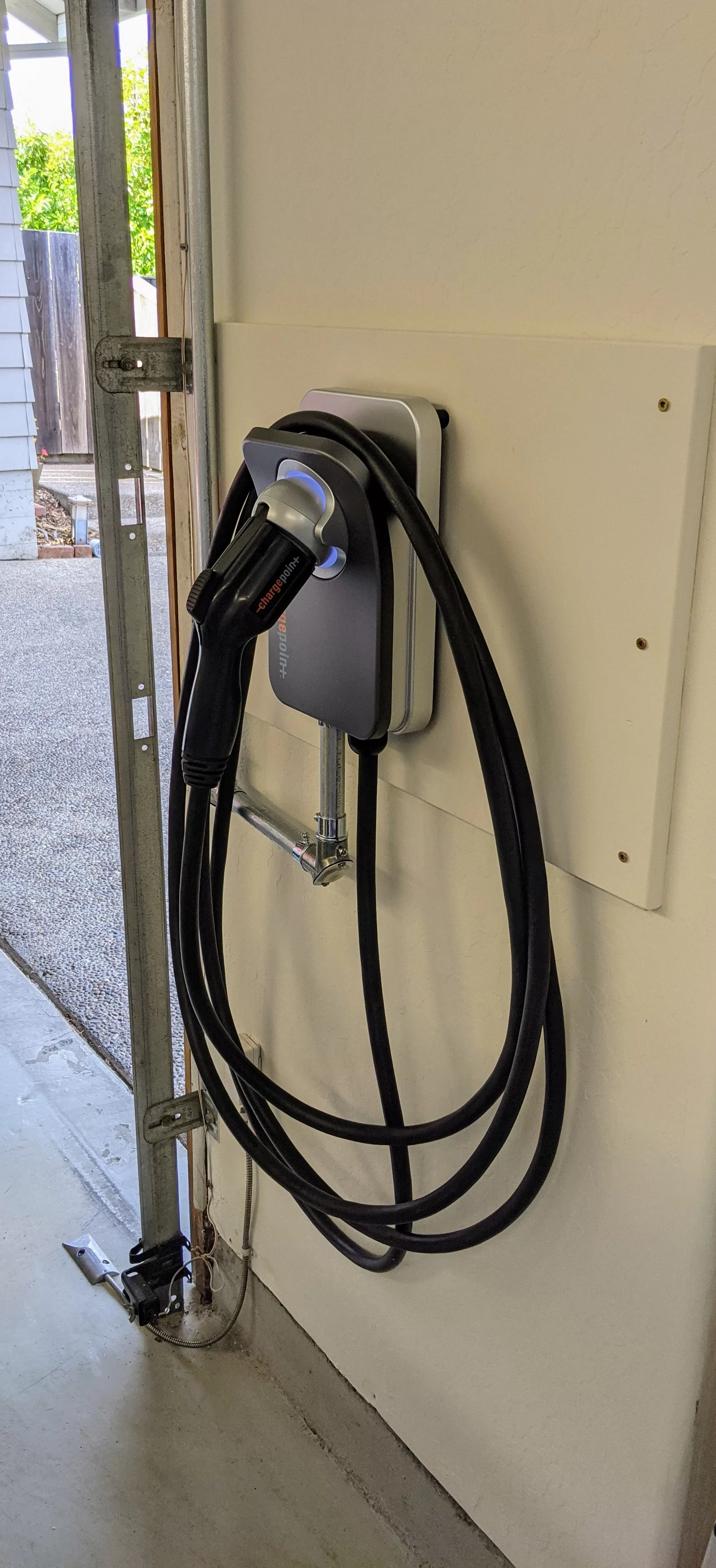

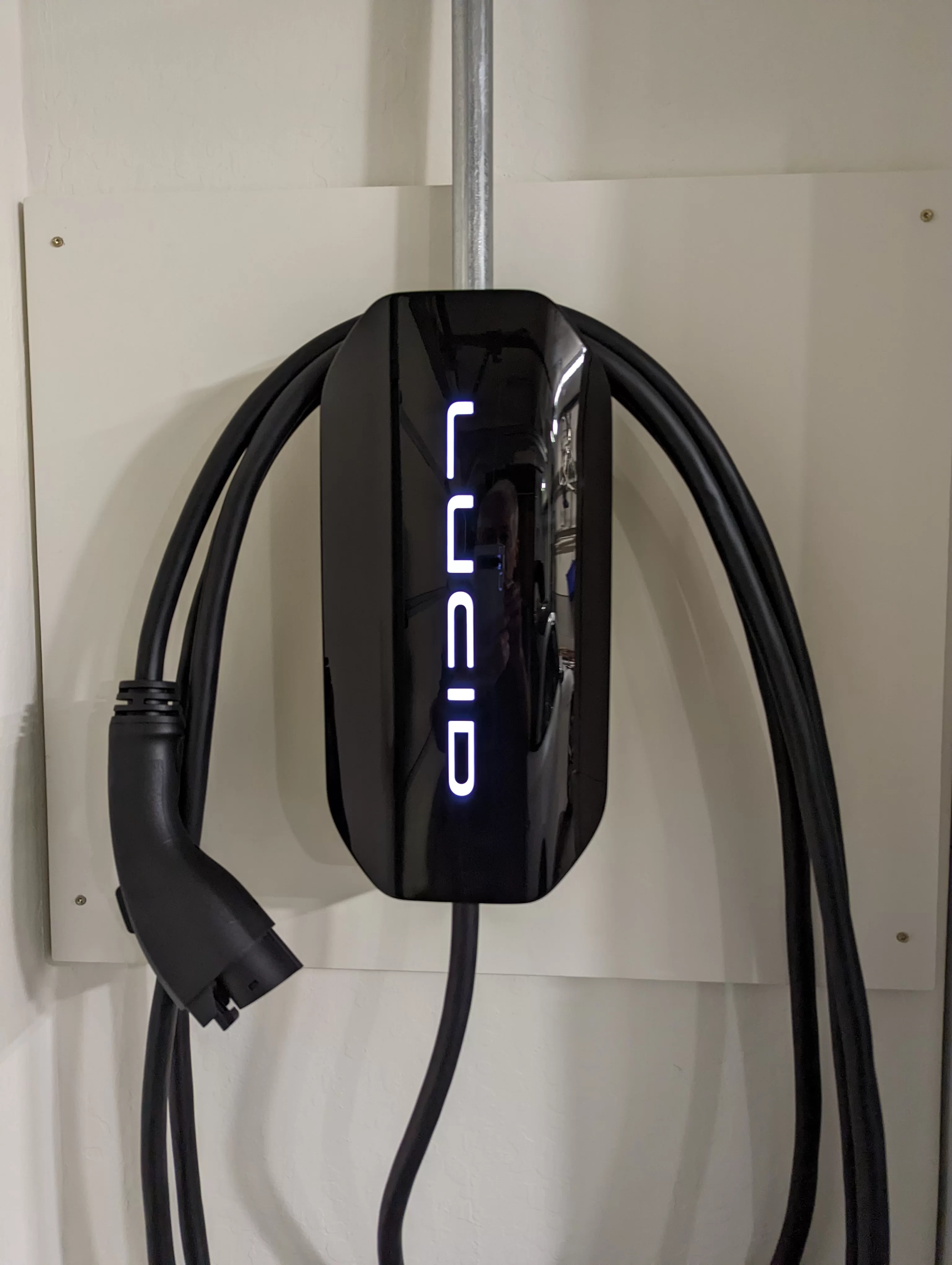

Our hardwired Chargepoint Home Flex and Lucid's LHCS:
That means you need 160 amp circuit breakers. Your panel is that big???
I have 200 amp service. The EVSE's aren't maxed out - the Chargepoint is on an old 40-amp circuit left over from our Leaf/Soul EV days and is adequate for my wife's XC40 EV. Lucid's EVSE is on an old 60-amp circuit repurposed after our Model 3 experience and is adequate for the Air. We'll see what we need to change when Lucid's V2H solution becomes available. In the meantime, costs were minimal.
