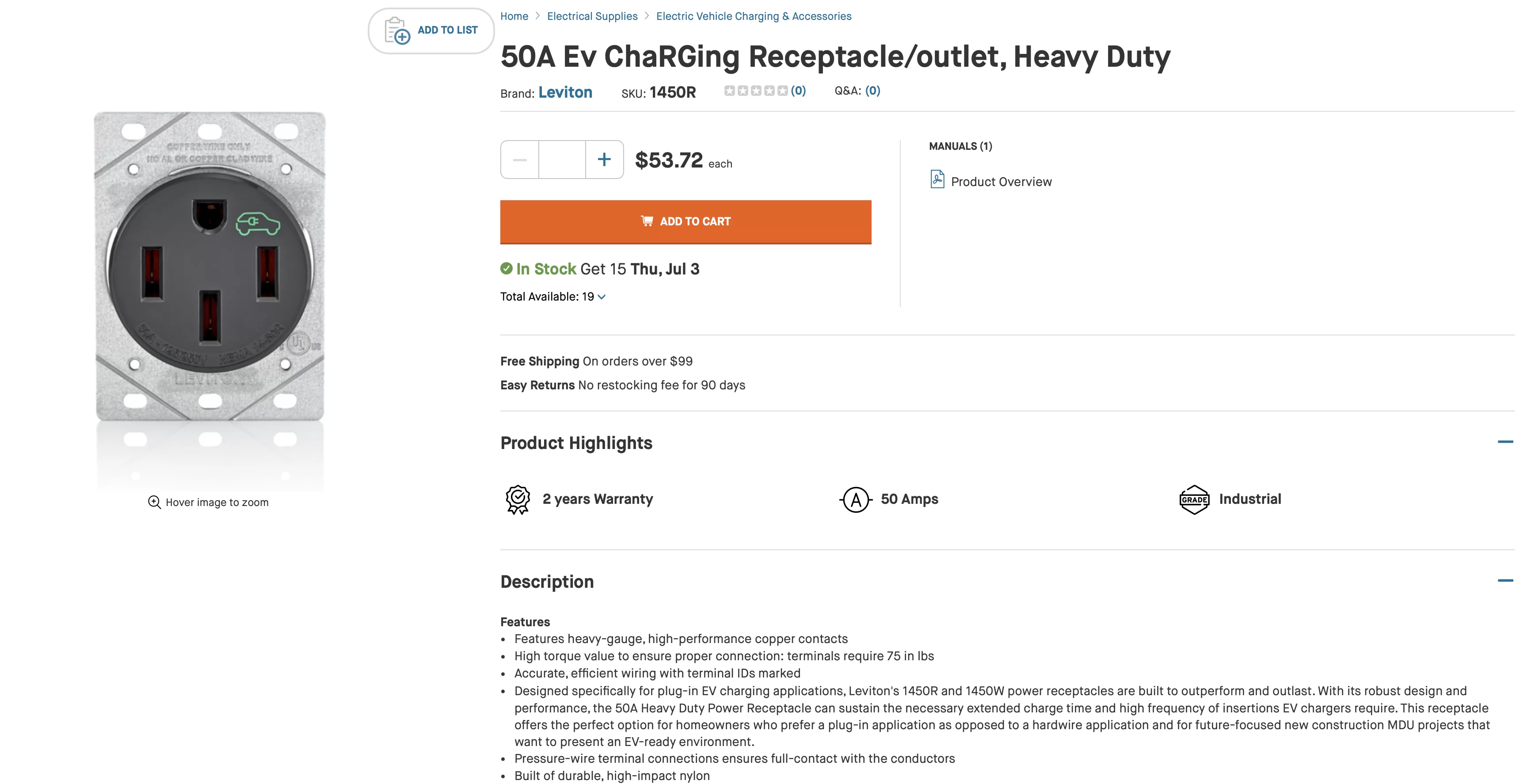

Make sure your receptacle is an industrial rated, continuous duty NEMA 14-50 by Hubbell, Bryant or the very new Leviton EV rated receptacle. If the receptacle costs less than $50, it's not the correct one
Thank you for your insight. My electrician is an EV charging expert but will make sure to ask about the receptacle specifics.
