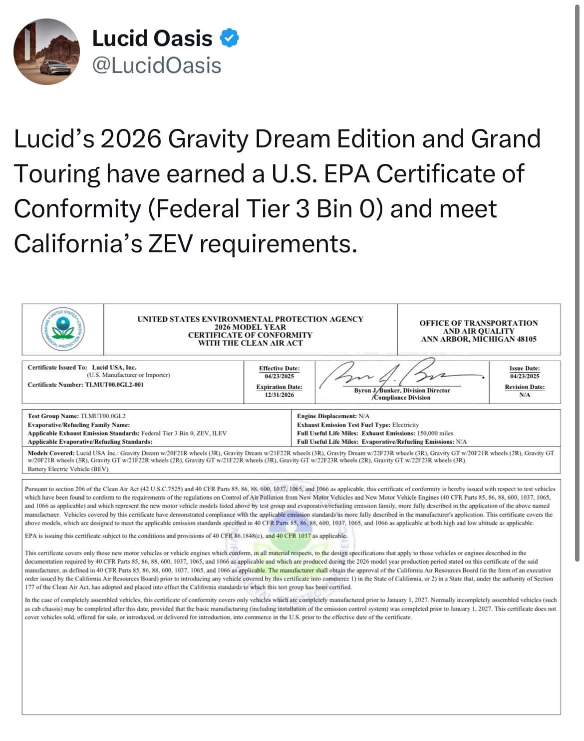

Gravity EPA docs are here.
Also the Performance wheels are staggered so at least the rear is wider.
Do you mean on the Gravity? If so, all three wheel sets have both staggered widths and diameters.

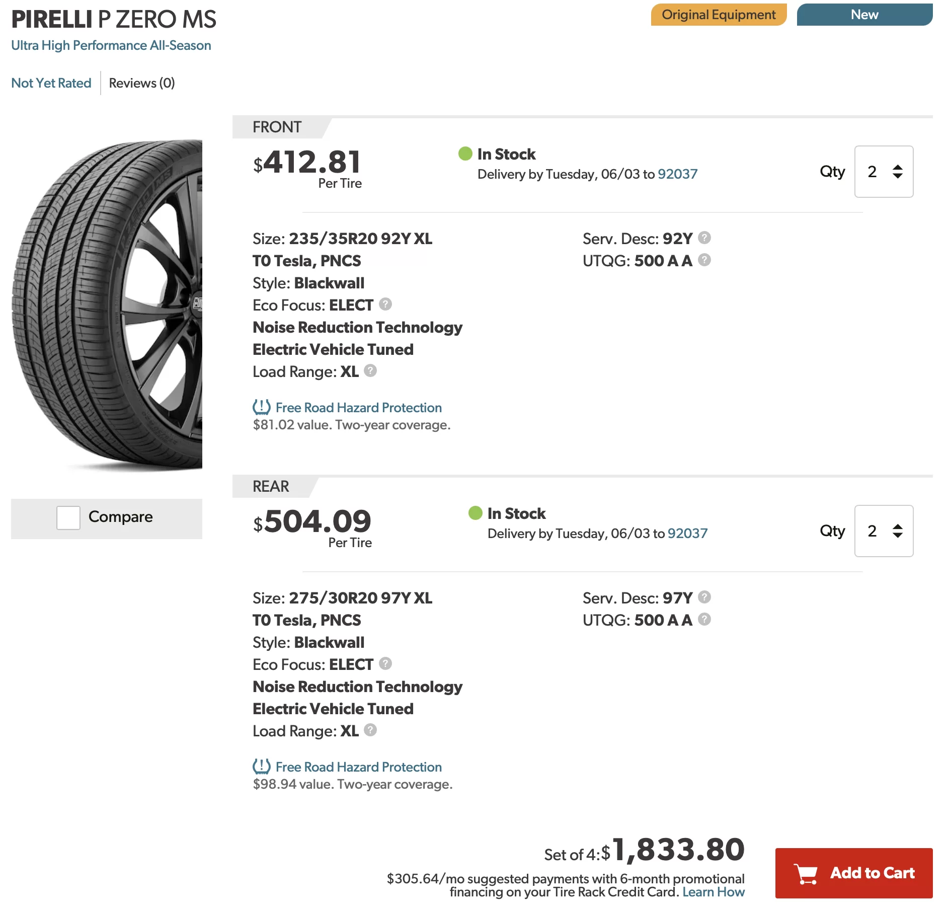

A small correction, the OEM 20" PZ4 tires are all season but they are wider and much stickier than the OEM 18" tires (70-0 braking 163ft vs. 178ft skidpad .92g vs. .84g)
I think the same will hold true for the Gravity, if you put sticky tires on the 20/21 rims it will get similar efficiency and performance to the 22/23 tires.

I agree with most of what you said but the 21/22 and 22/23 data is fake. There is a 0% chance that all three coefficients are exactly the same to 4 digits (F0 F1 F2 in post #19).
