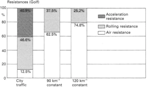

Wheel weight is generally the biggest factor, the road contact patch, rolling resistance, wind resistance, kind of in that order.
