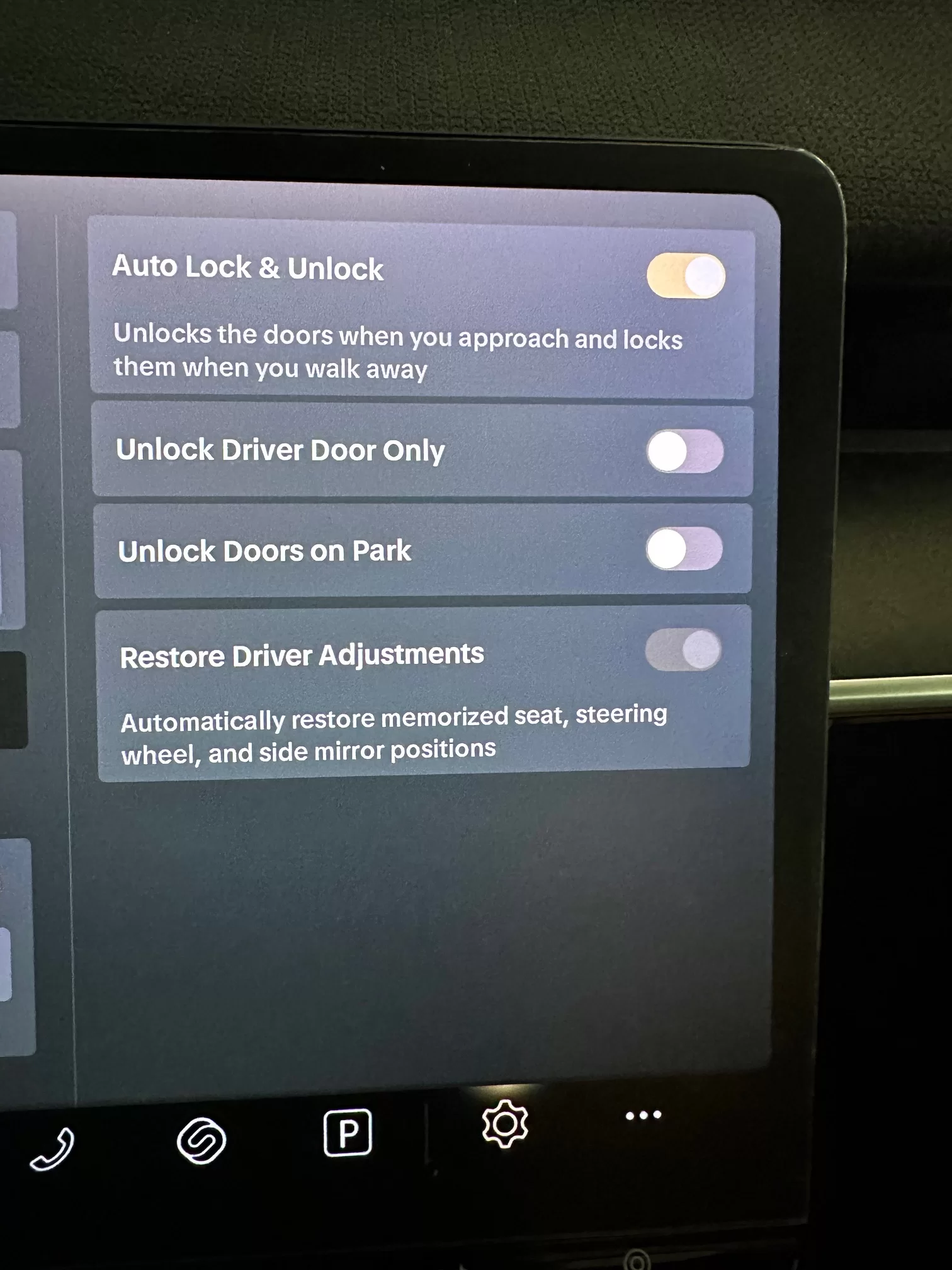

I posted earlier that our car will not hold a programmed setting for the outside rearview mirror and will not accept a "Save" when it's adjusted. (Both the "Save" and "Restore" buttons are grayed out no matter which menu I am in when adjusting the mirrors.)
Today I might have found why. Based on another poster's report that his key fob issues did not change whether he had auto lock engaged or not, I went into the menu to turn auto lock on to see what would happen. While there, I noticed that the function to restore mirror and other settings was grayed out and would not activate.
So yet another software bug . . . ? Is anyone else seeing this?
Incidentally, I had just done a UI soft reboot (X/Mic/Brake) before this exercise, because when I got in the car the left side of the glass cockpit was grayed out, and the Pilot Screen menu was frozen on the default setting and would not open any other menus.

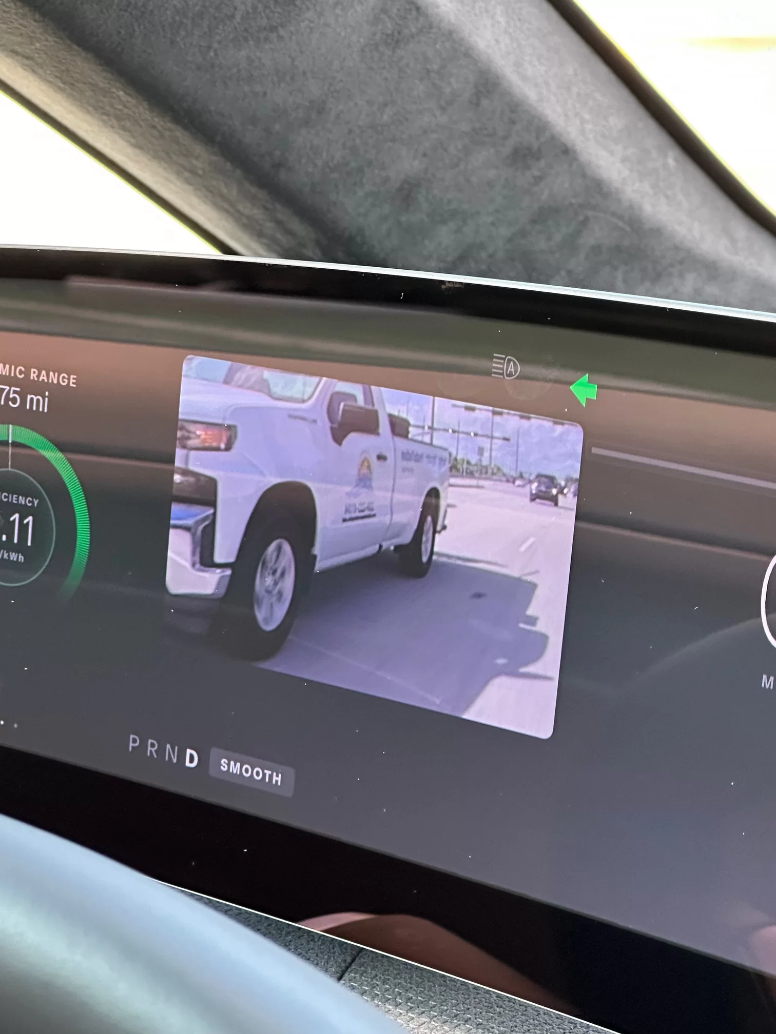

Those with Gravities, how are the blind spot and rear view cameras? I had two people tell me when they test drove, video quality was bad, and this was when the sun was shining brightly.
You wouldn't confuse the images with an 8K movie, but they are fine for the purpose. However, the rear view image at night is a little dimmer than in our Air, which may be more a function of the rear backup lights than the camera or display.
The blind spot images are both clear and fast enough in our car, although some software glitches have created intermittent bizarre behavior such as displaying a frozen frame from a right-side video in our left-side display when the left turn signal is activated.
Were you logged into your profile or guest profile when you were locked out of the restore driver adjustment screen?
On a related topic about outward visibility, I have found the supposed issues with the thick A-pillars that several reviewers have noted to be kind of a nothing burger -- perhaps because we are used to our beefy Air A-pillars.
That’s good to know, the blind spot camera images in my Gravity test drive were way worse quality than my air and looked like old Tesla model 3 qualify, but I attributed that to software that would fix it, so they must have fixed it.

My driver profile.
I think your profile is hosed. I’m guessing you’ve already deleted it and made a new one and re-synchronized fob/keycard after logging in to Lucid account?
To be honest, I don't put a lot of demand on image quality for a blindspot display as long as it lets me know whether the space is clear of obstacles or not. So it might not be up to more demanding standards.
Here's a shot from our right-side display that was weirdly showing as a freeze frame image on our left-side display for a while. It's not great quality perhaps but, to me, sufficient for the purpose:
No, I haven't. I'll try that, but I'm kind of getting exhausted from trying to chase so many issues to ground.
Haha yeah what have you got to lose? Maybe erasing your profile and making a new one will at least have a nice placebo effect if one of your issues goes away after doing it.
The blind spot camera, while resolution is low compared to others I've seen, is totally fine for what it needs to be for me. A very quick glance tells me all I need from it. Backup is much better than my Taycan?which isn't saying much as it was not good) and better than my wife's EV9. It's all relative.
