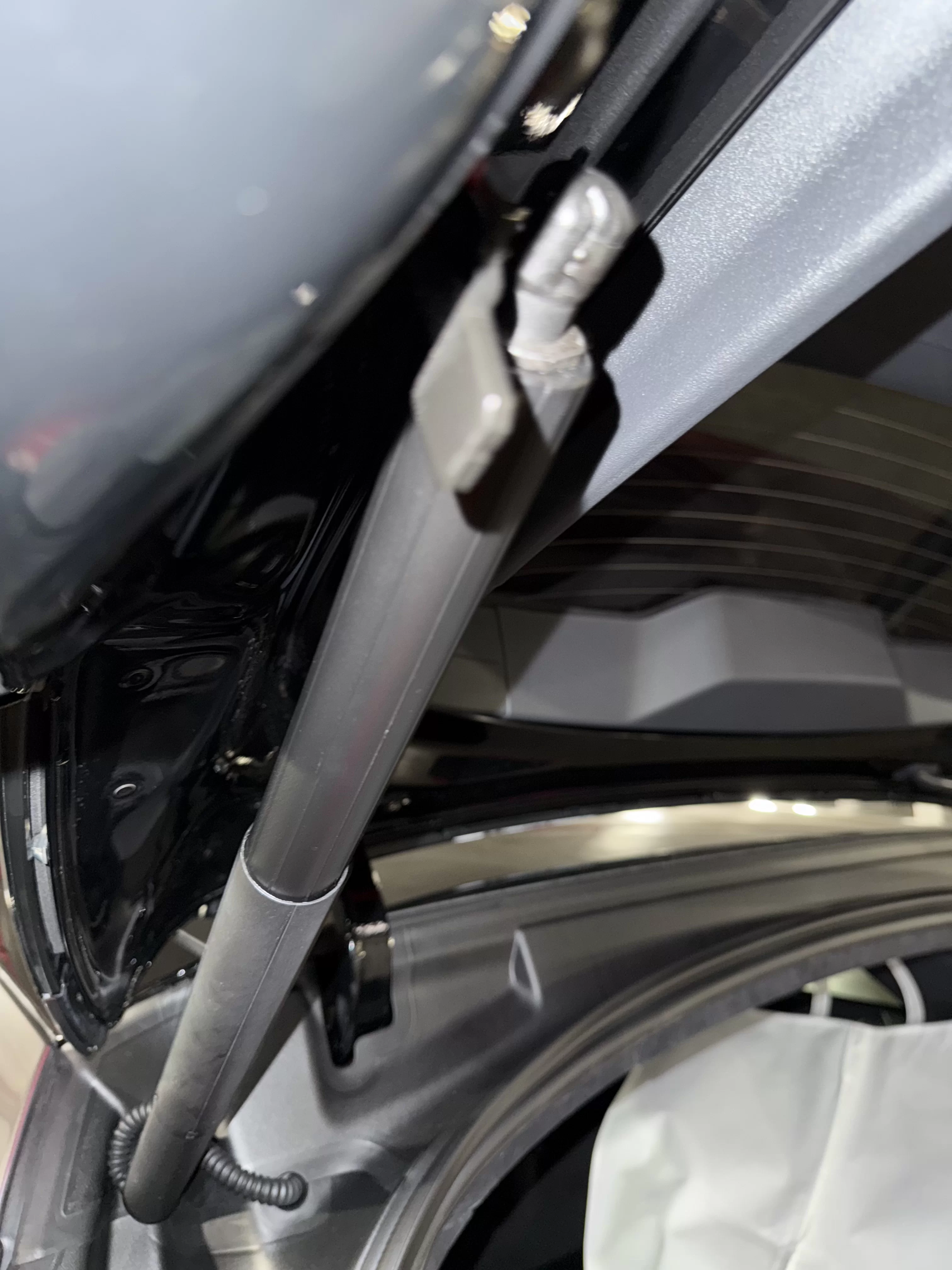

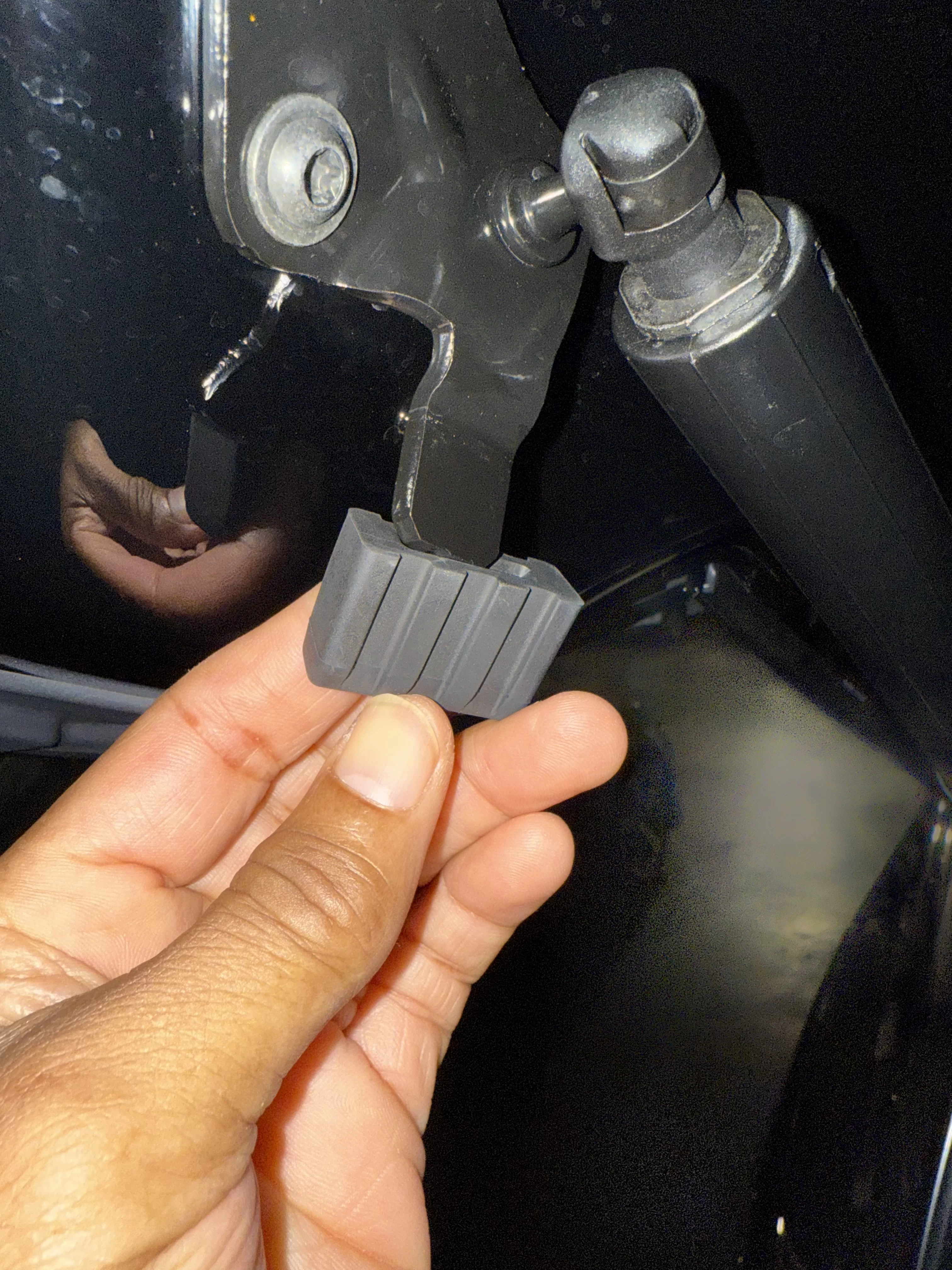

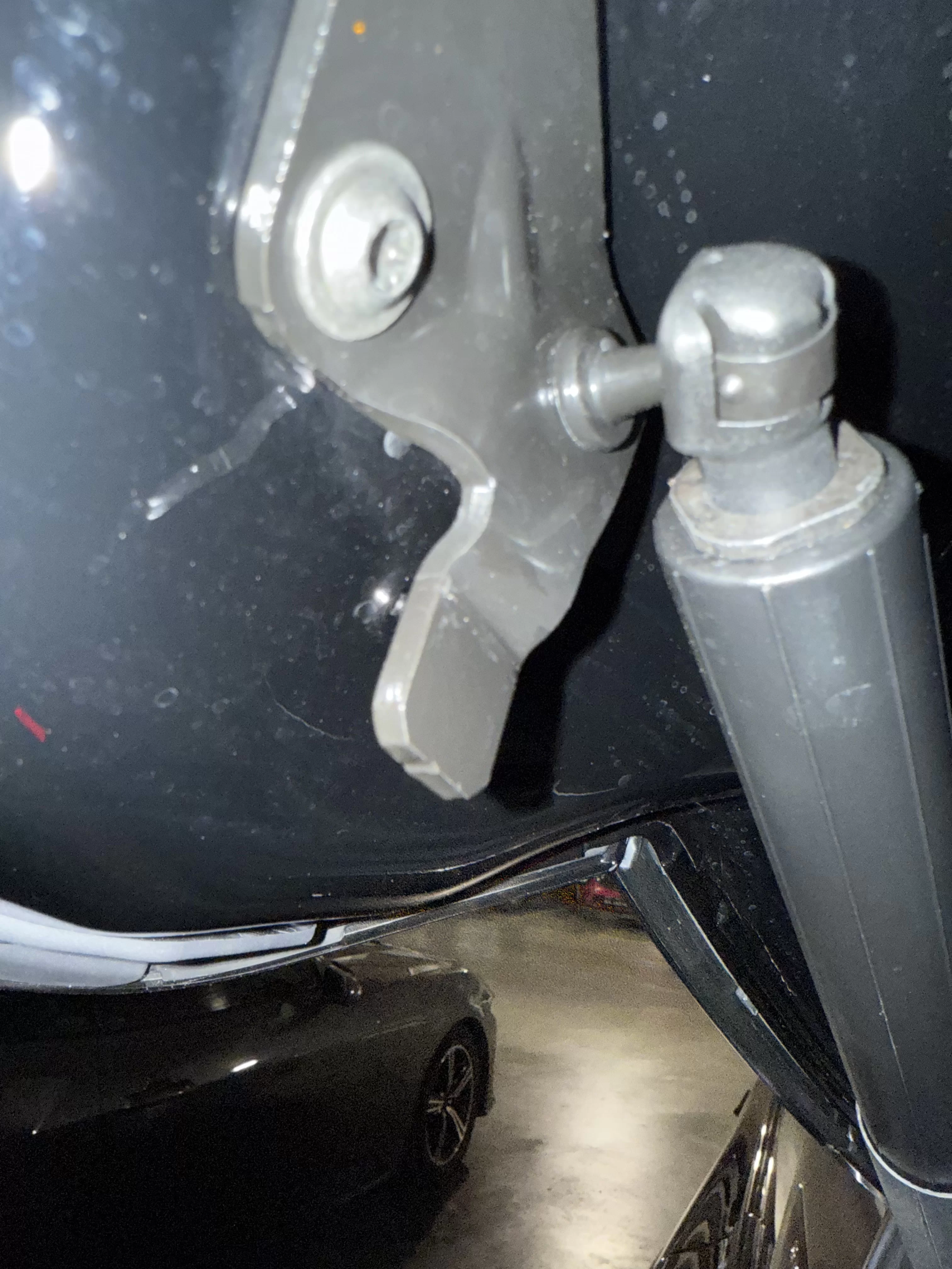

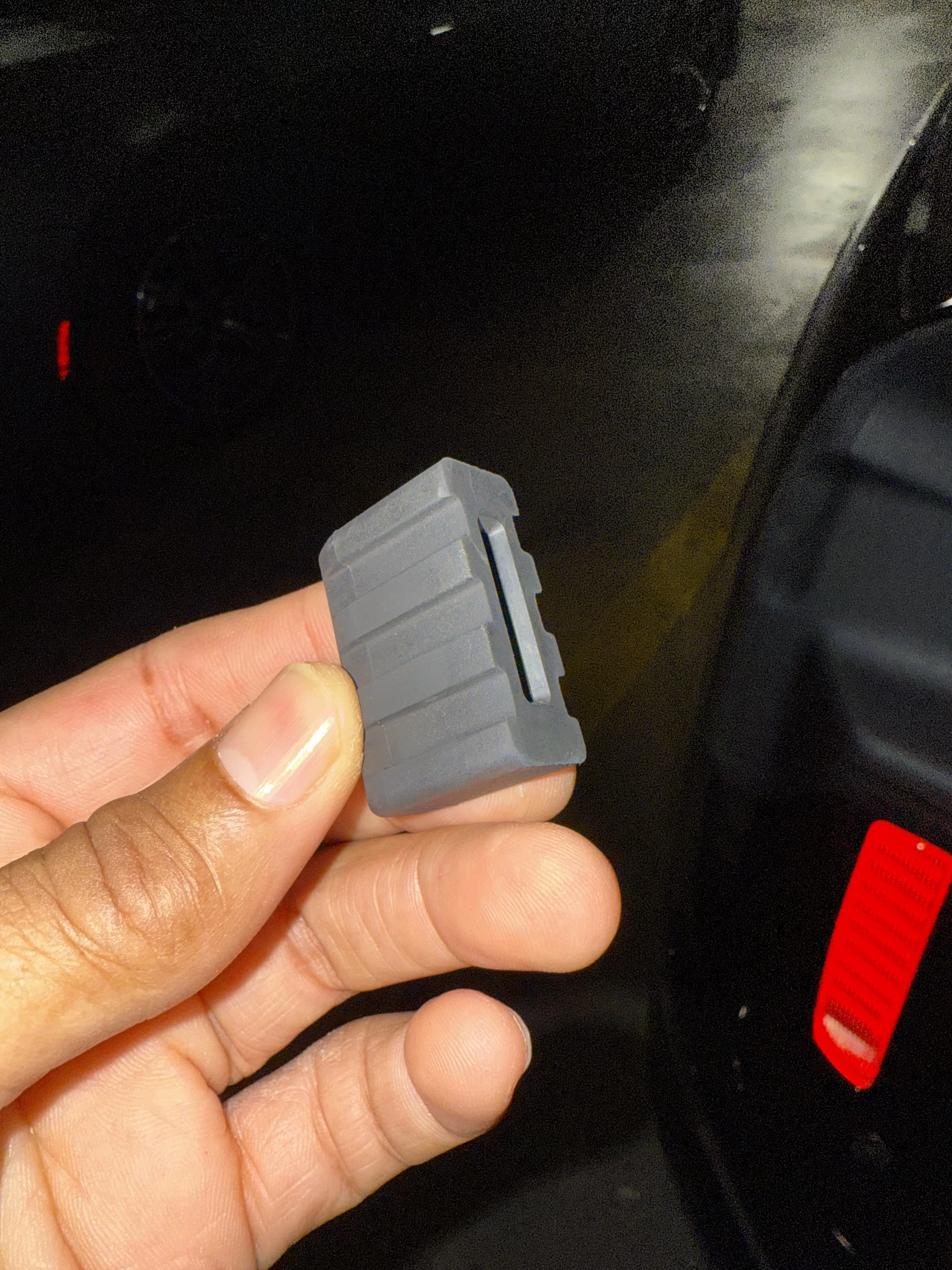

Can anyone explain how this piece on the gravity trunk is supposed to be secured?
It has become detached several times
Hmmm...Will need to look at my car to see. My immediate response was "with glue" but that's not helpful... :)
