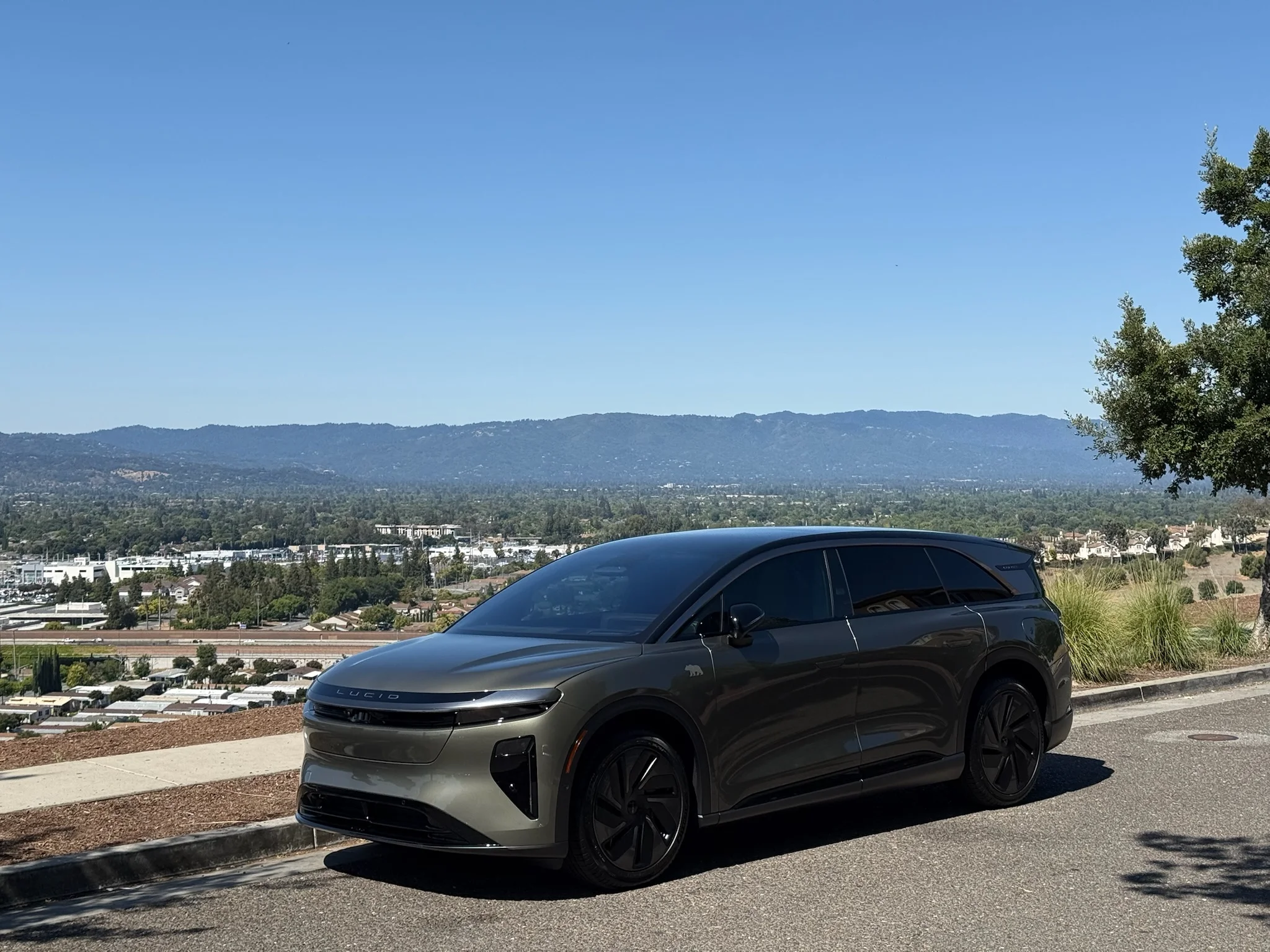

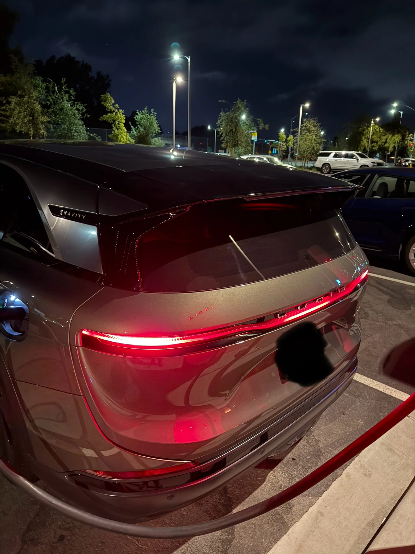

Also pictures of my DE after PPF, Ceramic Coating and Window Tints!
I had an issue where it kept saying sensors blocked after getting PPF + rest (Deep Reflections), the blind spot cameras and multiple other features stopped working for about half an hour
I called Alejandro and he said do a car reset, so after doing a "soft reset", click lock twice and walk away the warnings went away after driving about 15-20 miles!
My DE is Aurora Green, Tahoe, 21 / 22 mid size
Charging at Tesla Supercharger was absolutely seamless, my first time visiting one and first EV
