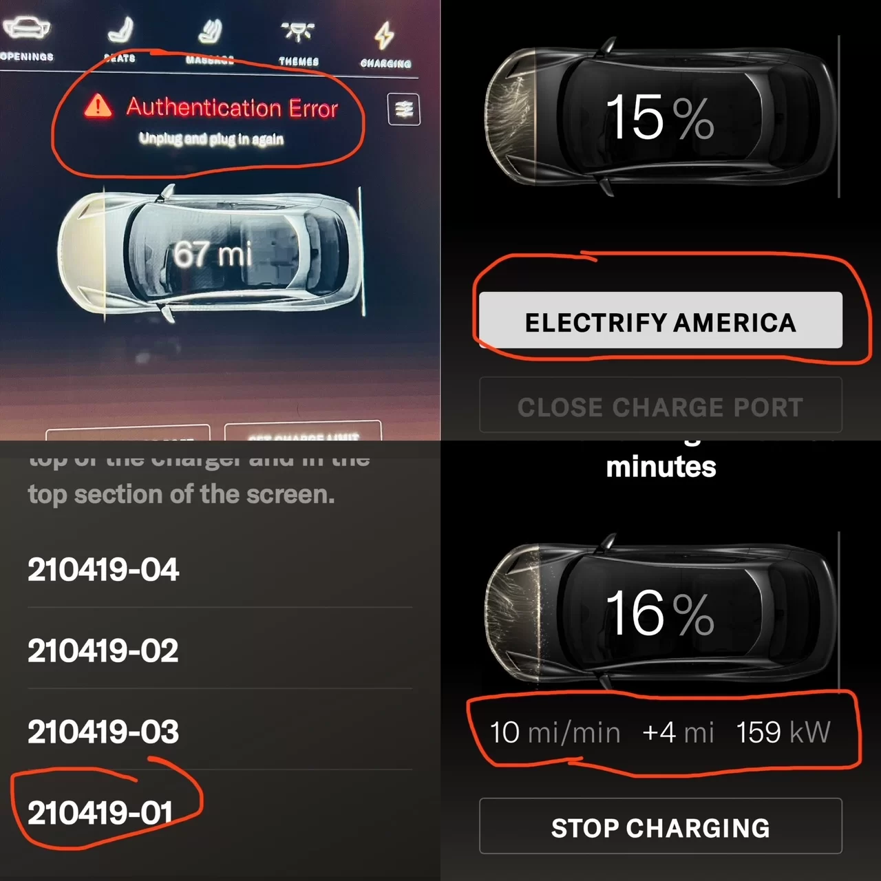

Heads up #LucidOwnersClub … Lucid has changed its app wrt Electrify America . No longer plug 🔌 &play (charge)! Now you have to open the app, tap the Electrify America icon then tap which charger you’re at. If you do not do that, you’ll get an authentication error 🚨 and won’t be able to charge! You cannot do it on the pilot panel, native to the car!
Sunday 1/28/24 was the last time I used EA without this issue and Tues. 1/30/24 is the first time I used EA and found this update.
Now I can bitch at how there are more steps, but I’m more concerned about loaning somebody my car who doesn’t have the app and won’t be able to free-charge!
This is exactly what’s happening to me!!!! Wtf how am I supposed to unlock it to pull it out?????
If you open your frunk there is a manual release lever right above the charge port if you really cannot pull out the cable while the car is unlocked. Hopefully that works!
Thank you!!!!! Learn something new errrryday! And today I learned a lot! I think 🤪

😅 they (EA service) were telling me to just pull the plug out… like wtf 😳 I was skerrr’d.
EA guy told me to call Lucid. Doing that when I get home. Long day already.

I was consistently having to use the app and finally on a call to Lucid while in a frustrating series of failure to authenticate. They reinstalled my license and no problems since With Plug n charge.
