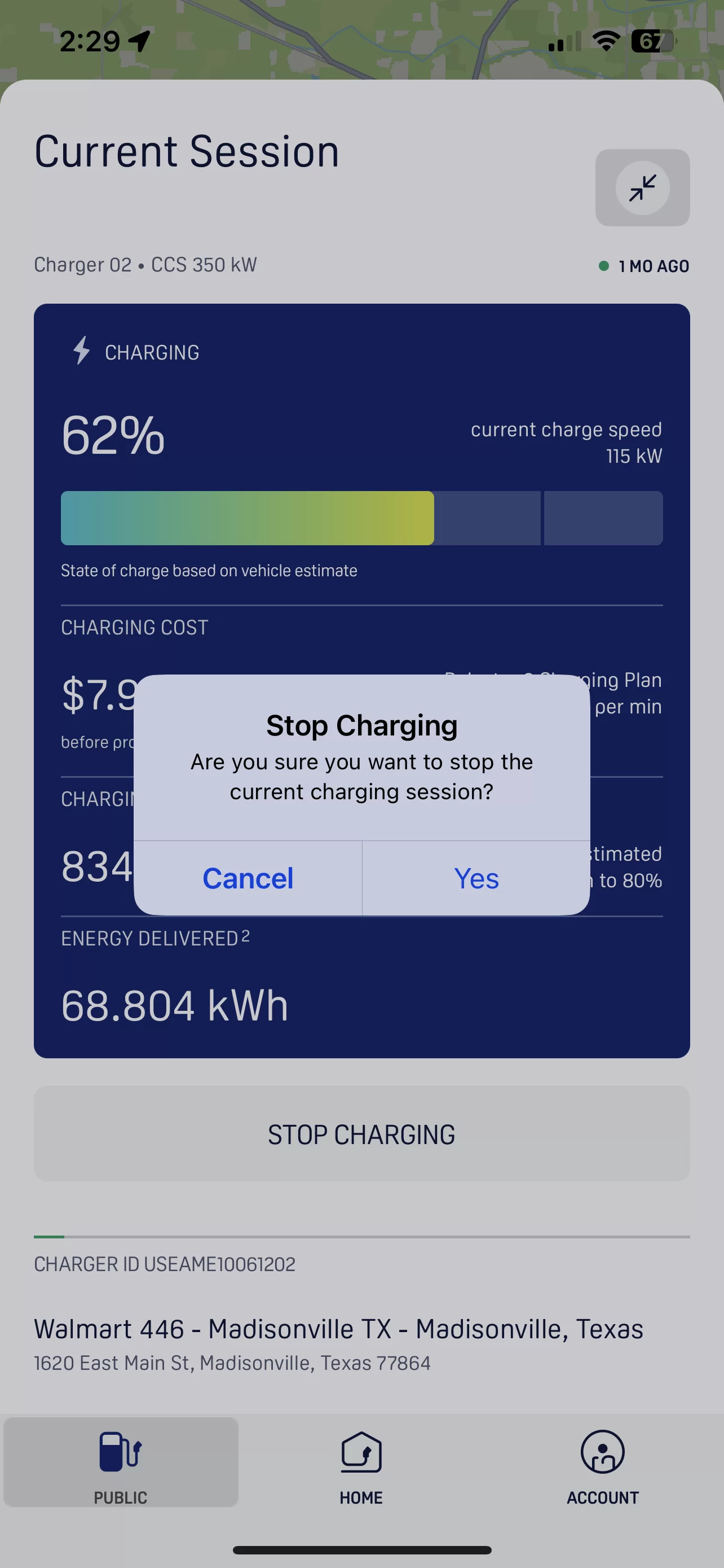

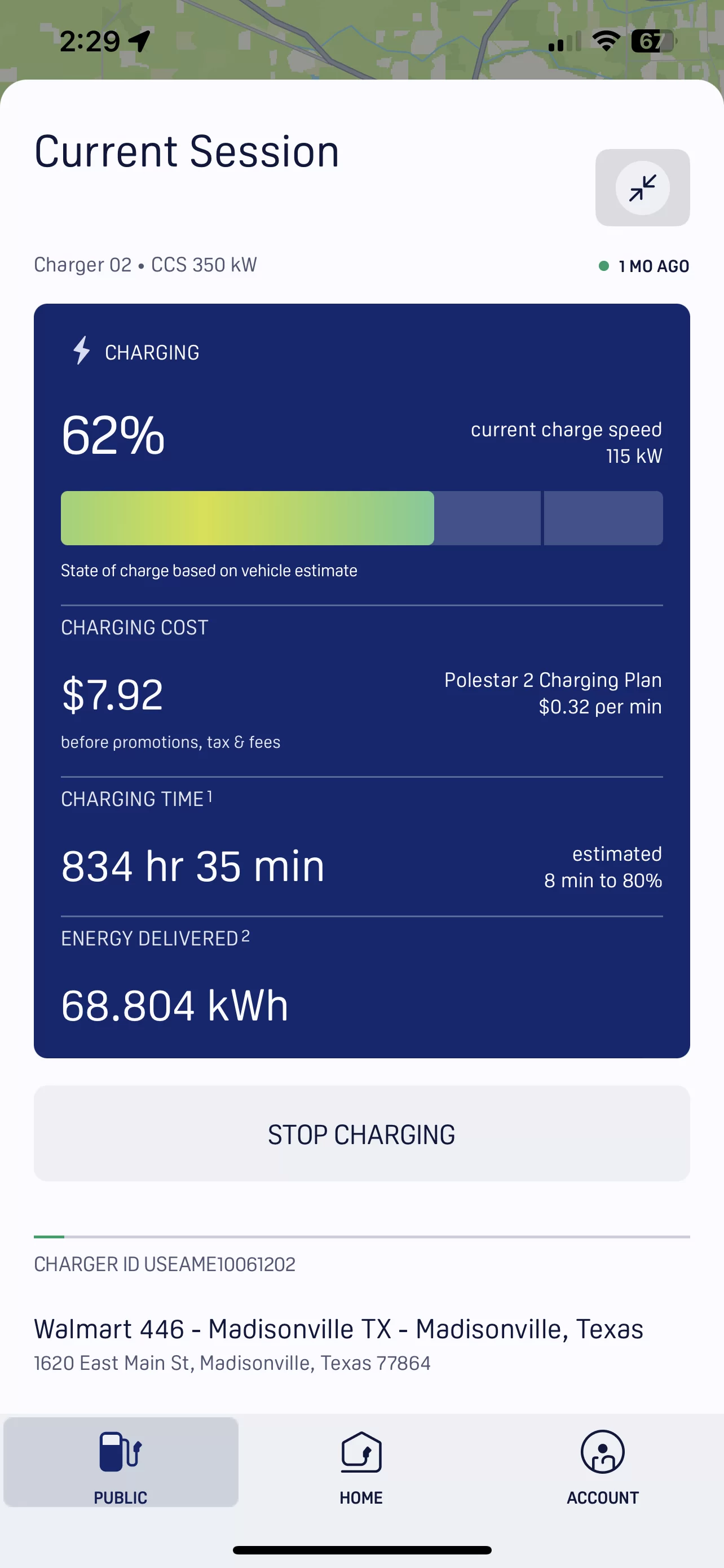

I don’t have a problem with EA, but I use EA app for my other EVs road tripping. I haven’t used the EA app for awhile, I now just opened the mobile app to plan an upcoming trip. It shows that I’m stilling charging from a month ago. 🤣
834 hours locked in to stall. Ok, I just “SURE” I want to stop charging to relinquish. Sorry ‘bout other EVs if seeing this stall as unavailable. 🤣
Now imagine this would be idle time and they actually charged you for it. 🤣
I know, right? EA software bug can brick its physical hardware stall. No wonder they need constant phone calls from customers to reset their dispensers. 😞
