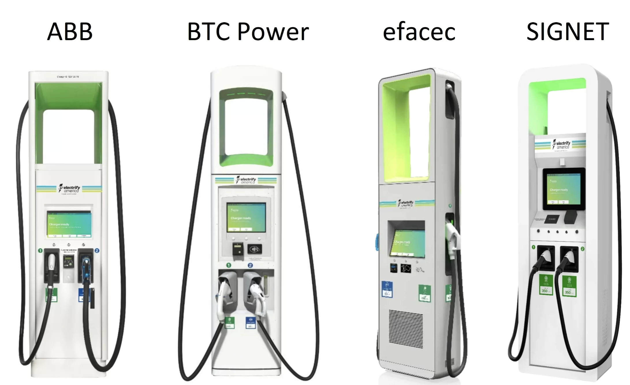

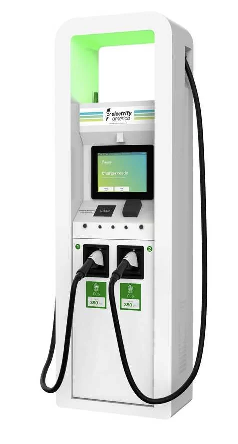

Apparently, a Signet type station looks like this (per https://insideevs.com/news/337684/u...bb-btc-power-efacec-and-signet-fast-chargers/)...
And their lineup looks like this...
The above are correct. However, AFAIK, EA has ripped out almost all or all of the Efacec. ABB have also been getting mostly replaced by something else (e.g. next gen units (see post 20). I've charged at https://www.plugshare.com/location/198205 and even encountered two Lucid test vehicles there when it was ABB. Now it's next gen.
I've charged at https://www.plugshare.com/location/169514 when it was ABB and now it's also next gen. https://www.plugshare.com/location/186852 was ABB and I charged there on next gen. Dispensers were definitely SK Signet.
https://www.plugshare.com/location/193054 was all original old BTC Power. 2 units were replaced w/next gen BTC Power (for sure) dispensers while the old BTC Power CCS + CHAdeMO unit remains. I also encountered a Lucid Air test vehicle there charging (https://mynissanleaf.com/threads/lucid-motors-air.23094/page-3#post-605533) when it was old BTC Power
What's in post 41 and another example are https://www.plugshare.com/location/296759 is what we on chevybolt.org and some other circles refer to as Signet "v2" as opposed to "v1" at the top. https://www.plugshare.com/location/198229 has a mix of Signet "v1" and "v2".
As I allude to in https://teslamotorsclub.com/tmc/thr...fast-chargers-huh.133558/page-43#post-8312759, the next gen dispensers can come from either BTC Power or SK Signet. I've personally seen both. Kyle in that video implies that the charger hardware (cabinets behind a fence) can come from either make. I watched that video long ago and I'm unclear if there can be mix and match (e.g. BTC Power dispenser attached to SK Signet charger or vice versa).
