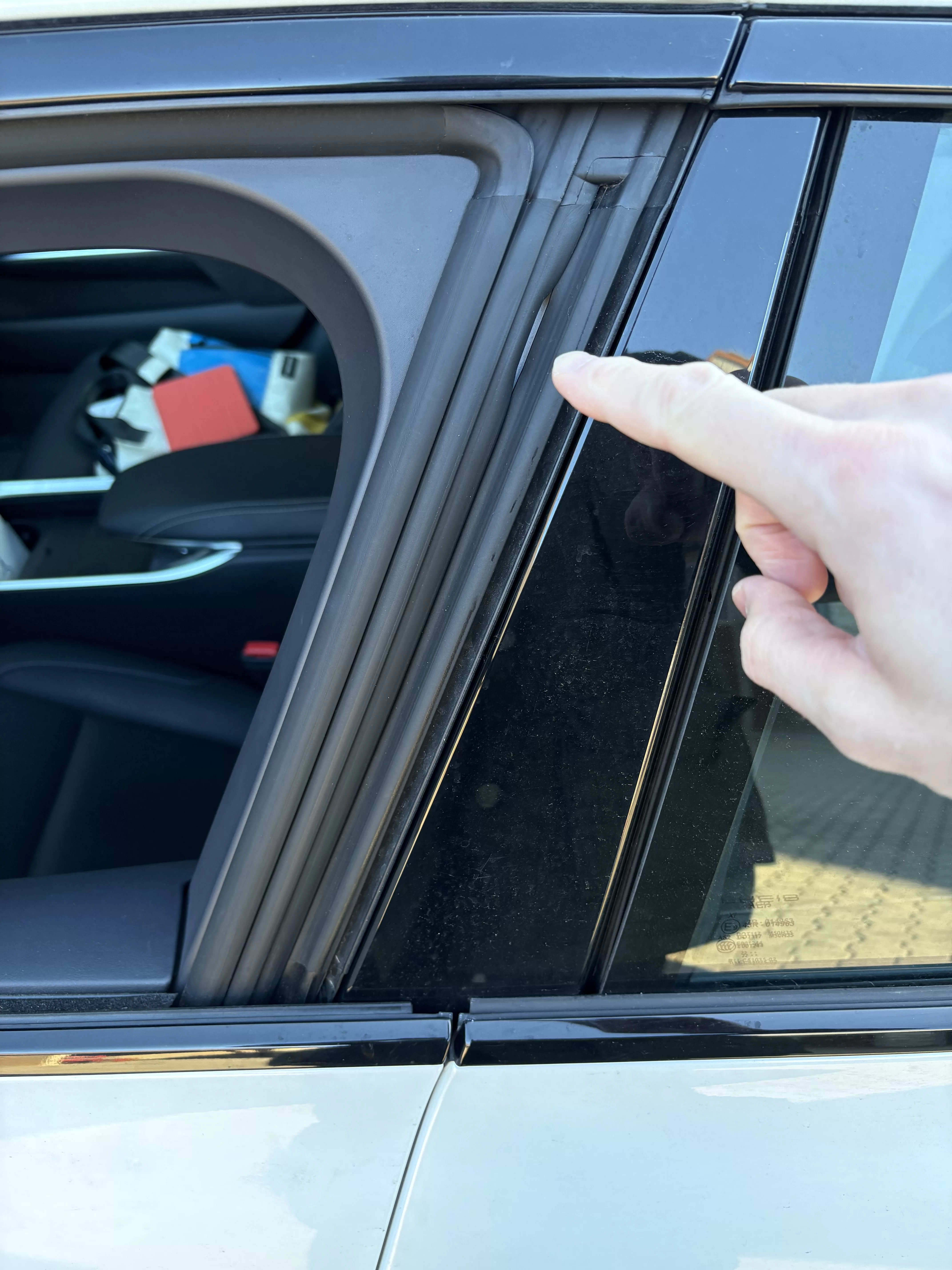

On my 23 Air Pure AWD the seals of the front side windows are partially bent inwards, see photos attached. The slats of the seal also feel quite hard and not like rubber.
When I complained about the air draft coming form the rear of the side windows I sent the photos attached to my Lucid service center. They said that the deformation of the seal is totally normal, which is hard to believe.
Does anybody here have the same deformation? Could you please post a photo of your window seal as a comparison?
Thanks!

View attachment 36441On my 23 Air Pure AWD the seals of the front side windows are partially bent inwards, see photos attached. The slats of the seal also feel quite hard and not like rubber.
Thanks!
Same on my driver's door window!
