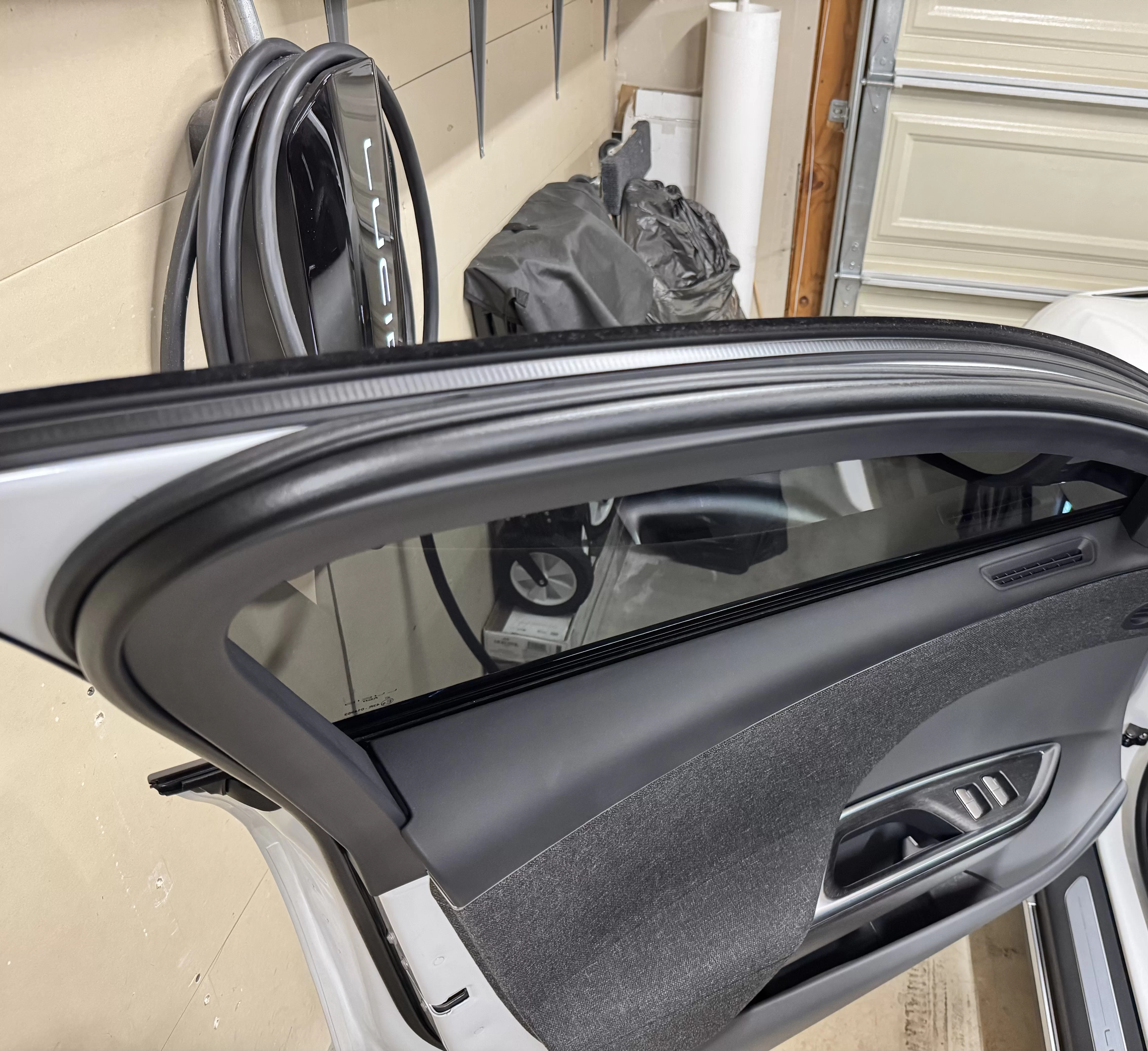

I ordered the weatherstrip material, and a decibel meter. Goal is to measure improvement in cabin noise at highway speeds as a proxy for the air draft.
I tried out the weatherstrip fix today. I have a 2023 pure without the soft close doors, so unfortunately many of the seal locations mentioned in Bobby's video increases the manual closing force for the doors. Because of the tolerances it was a lot of trial and error to figure out which pieces and locations would/wouldn't interfere with the door closing. For those of you looking to do the fix and running into the same issue, I actually found placing the seal directly on the door itself had the same effect and did not interfere with the closing force.
I already had service come out and fix the loose trim with the tooth clips that was causing wind draft, so while I have not experienced any more wind coming in even this winter, I still feel like there is a lot of wind noise at +70mph especially from my driver's side.
I don't have a decibel meter but after implementing the additional seals, it was a noticeable but small decrease in noise. Before I felt like the part of the wind noise was coming from the B-pillar, but now it "sounds like" its only coming from the wind going over the side mirror. I suspect that the seals are doing more to dampen sound coming into the car than actually closing any air gaps.

The door glass runner trim piece was loose and protruding outwards. Even if it was pushed back in, it could eventually become loose again. My technician installed trim clips to hold the glass runner firmly in place of the mounting channel. If I recall correctly for good measure I believe he installed them on the all 4 doors.
The original design had that top edge molding and gasket secured by just a pressure fit, but there is a fix that involves using positive attachment with clips. Lucid service calls these clips “claws,” and the part you’re specifically referring to as “door glass runner trim” is technically the “upper belt trim molding,” if I’m understanding you correctly.
