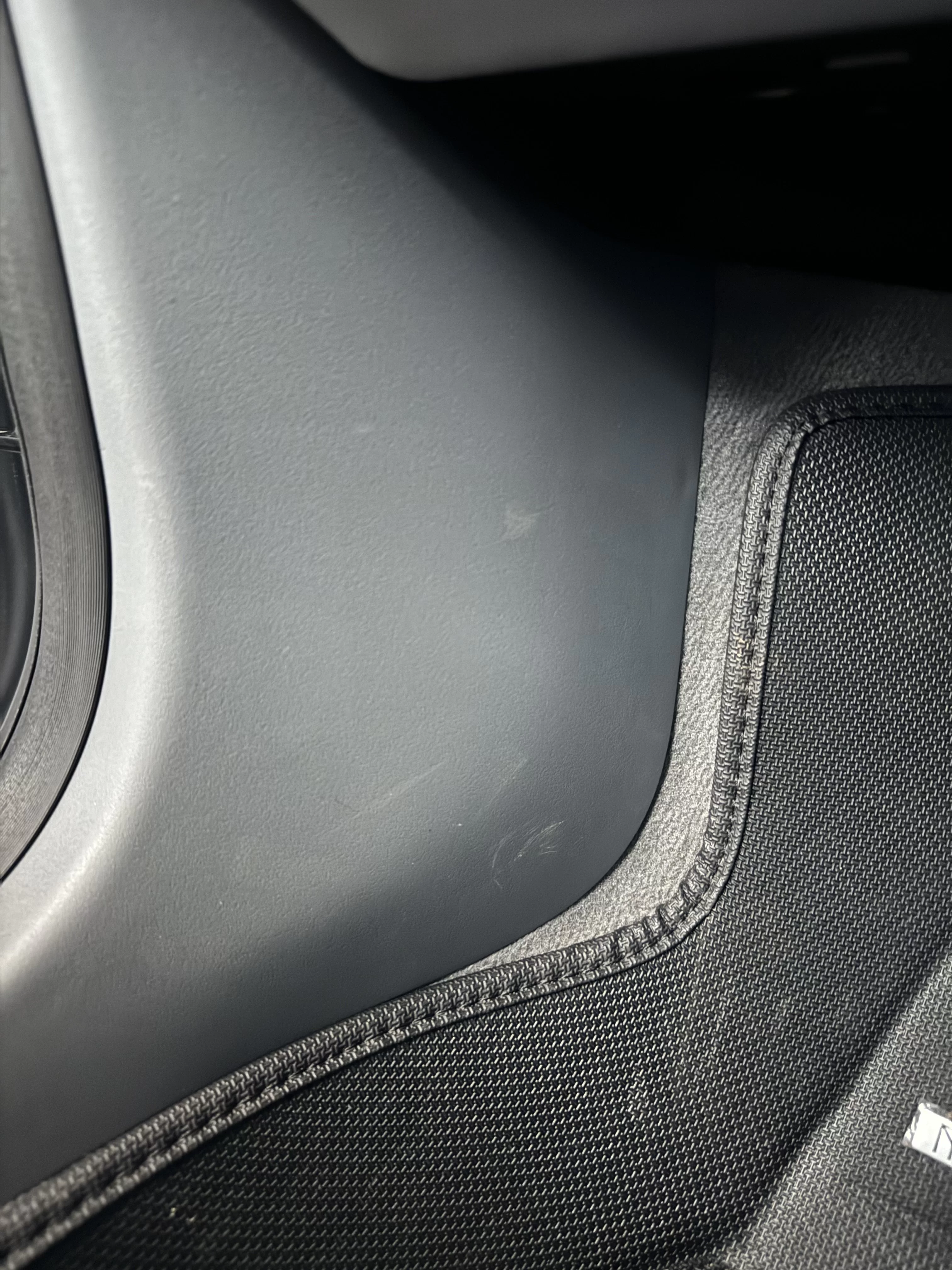

Thank you, that helps. Is there an external grill visible in the footwell, or are the woofers covered by carpet? Anybody got a picture of the footwell, without it taken apart?
No grill, covered extensively here: https://lucidowners.com/threads/res...footwell-woofer-work-properly.3326/post-96845Thank you, that helps. Is there an external grill visible in the footwell, or are the woofers covered by carpet? Anybody got a picture of the footwell, without it taken apart?
Wait so the speaker sits behind that plastic ?
Right, I didn't either - I had service come out to the house and they did everything.Looking under my dash, there is no way to see anything without disassembly. Maybe it is different with the SSP vs SS
