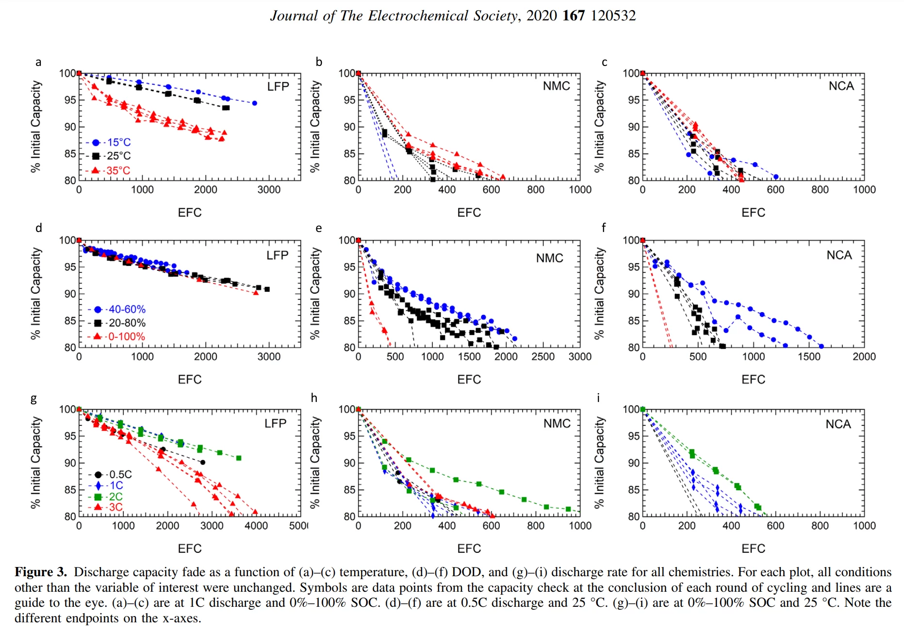

Here is a more detailed paper on battery degradation. See the middle chart in the screenshot below - this is for NMC batteries like ours, at 25C battery temp and 0.5C charge/discharge rate (a rate of charging or discharging that would go from 0-100% or 100% ro 0% in two hours), with three charge/discharge ranges:
Blue 40%-60% (longest battery life of about 2200 EFC - Equivalent Full Cycles - until only 80% capacity / 20% degradation)
Black 20%-80% (mid battery life of about 1800 EFC - Equivalent Full Cycles - until only 80% capacity / 20% degradation)
Red 0%-100%% (shortest battery life of about 450 EFC - Equivalent Full Cycles - until only 80% capacity / 20% degradation)
Each Equivalent Full Cycle (EFC) is charging or discharging by the amount of energy to completely fill and discharge the battery - like charging the car one time from 0% to 100% then driving until the car reaches 0% again. Or repeating five times: charge the car from 40% to 60%, drive until the car again hits 40%.
1000 EFC for a Dream or Grand Touring car would be about 400,000 miles. This huge number is a side benefit of driving a highly efficient car with a huge battery - one EFC takes you a long distance.

Ok so if I use the 20%-80% charging (or my 25% - 85%) charging pattern I should be able to drive ~ 720,000 miles (1.8*400,000) and at that point I will have realized a 20% degradation?? So if I drive 10,000 miles/year, then I only have 71 years left (I've already driven the car for one year) before my range drops by 20%?? Well that seems pretty good; I just hope the seats hold up that long.

In the center column of that 9-chart screenshot above, the center-top chart shows the effect of battery temperature while charging. Warmer is better for battery longevity - this is why EVs can charge at higher rates after "preconditioning" (generally warming) the battery. The center-bottom chart shows the effect of charge rate on battery longevity. Interestingly this chart shows better battry life at high rates of charge (3C would be about 350kW for our Dream/GT). I suspect this data anomaly is due to increased warming of the battery at high charge rates. If the battery were held at 35-40C ("preconditioned"), I think the result would be that lower charge rates give longer battery life.

In addition to battery degradation due to choice of charging SOC range, there is also calendar degradation which varies with SOC and temperature. And degradation from DC fast charging. It's reasonable to expect our car's batteries to retain 80+ % of their capacity after ten years with normal care.
