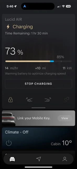

You/we can, on the charging screen in the car schedule a time for the car to charge, if the battery is cold at that scheduled time the car will precondition the the battery before charging and during charging.
See the screenshot below from my phone.

In cold weather when the car has a cold battery it preconditions the battery before and during the charging process.

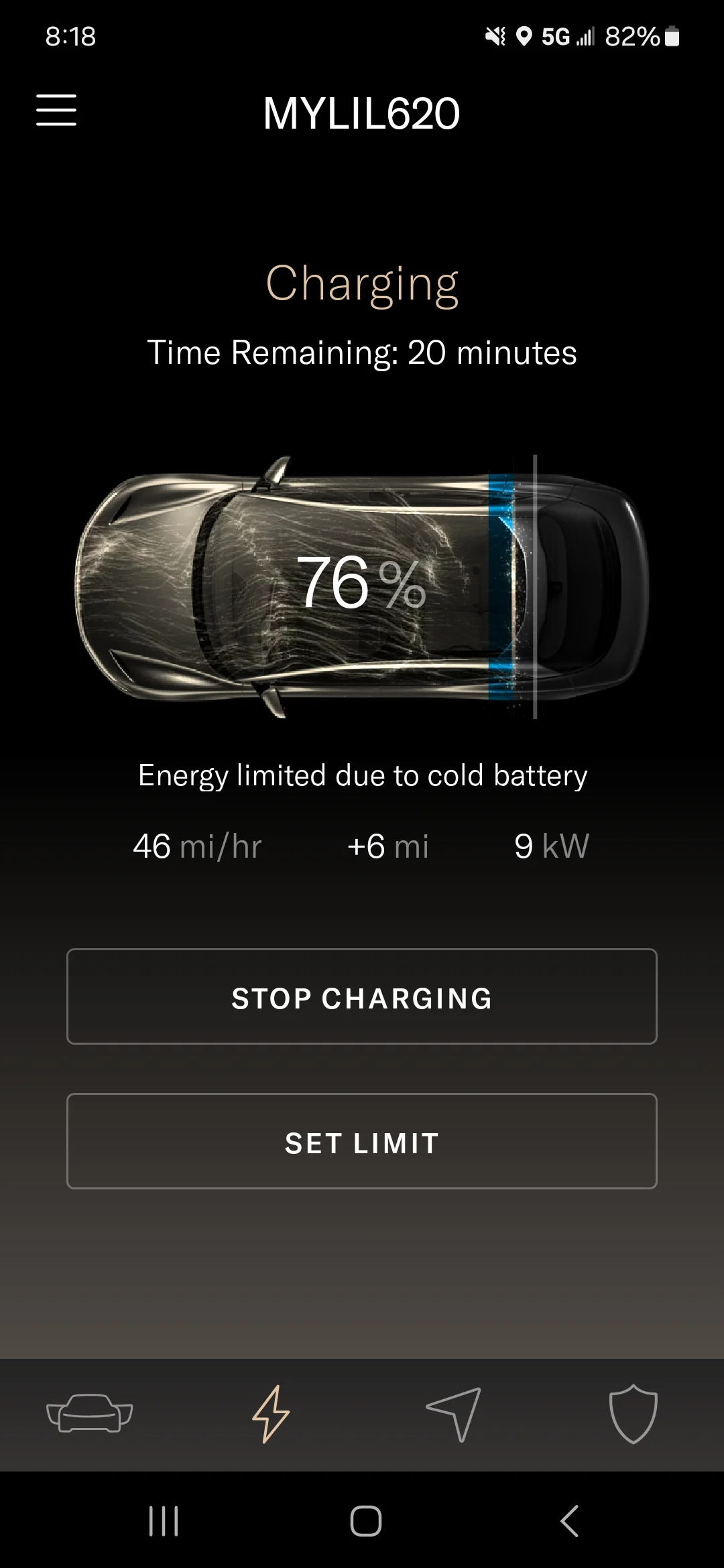

As mentioned above, the L2 preconditioning and even running the defrost are not enough to get rid of the blue bar. The car reconditioned for 10 minutes and then started charging. But it had been charging for close to an hour when I took this picture
That's the old app screen, ask Lucid why your screen hasn't updated yet. Take a look at one of my screenshots and that's how the new charging screen looks.
What was the temperature when you started charging?
It's not the old app screen for android. It's the most current one. I just checked again Thursday. The temp was Probably high teens °F
