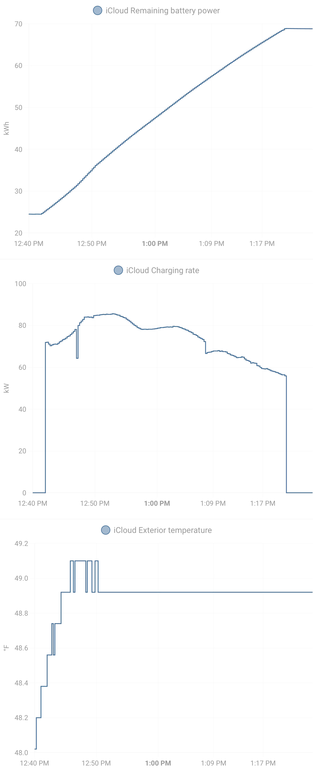

I was going to share a Touring charging curve today, but captured this absolutely unhelpful data instead. 31-80%, 25 minutes of preconditioning, 350kW EA charger, but yeah... maxed out just over 80 kW. To be clear, this is not normal. I hadn't used this station before.

Almost 40 minutes for 30-80% yikes! That definitely seems like a bad charger. I’ve seen better rates on a completely cold battery tbh
