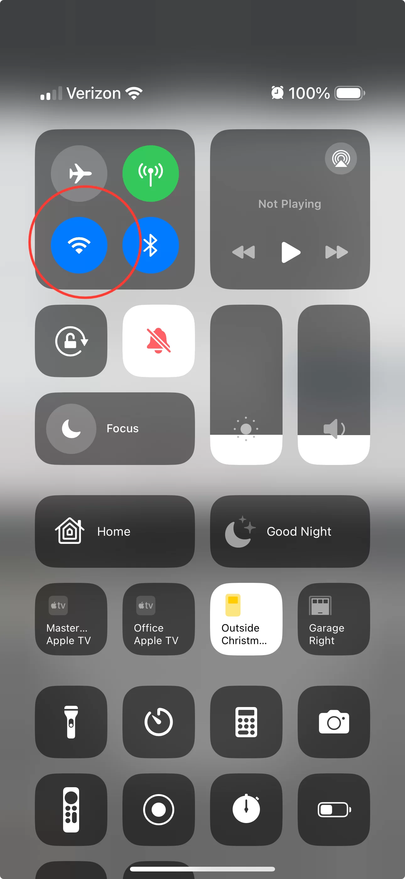

Interesting. I never quite understood what the WiFi has to do with CarPlay. Maybe the wireless CarPlay issues I’m having is due to the WiFi being on? Maybe I should disable WiFi on my phone while in the car… and then see if CarPlay is still glitchy and disconnects randomly. Worth a shot. I really want to have a reliable CarPlay and not have it quit on me during a drive on the highway while navigating and then I have to pull over on the highway and waste 5-10 minutes repairing my phone again to get CarPlay to work. I will try the disabling/enabling the WiFi on my phone trick.Next time it simply disconnects, go into the control center on your iPhone. You will see that the Wi-Fi indicator is white, which indicates the phones still thinks the CarPlay is on despite the car not thinking so. Tap indicator Wi-Fi. You will get a warning on your phone saying “this will disconnect CarPlay.“ Tap OKthen wait a couple seconds and the car will reconnect to the phone automatically. This works about 90% of the time. For the other 10%, you may need to go into the connectivity menu in the car and tap the CarPlay icon to force a reconnect.
