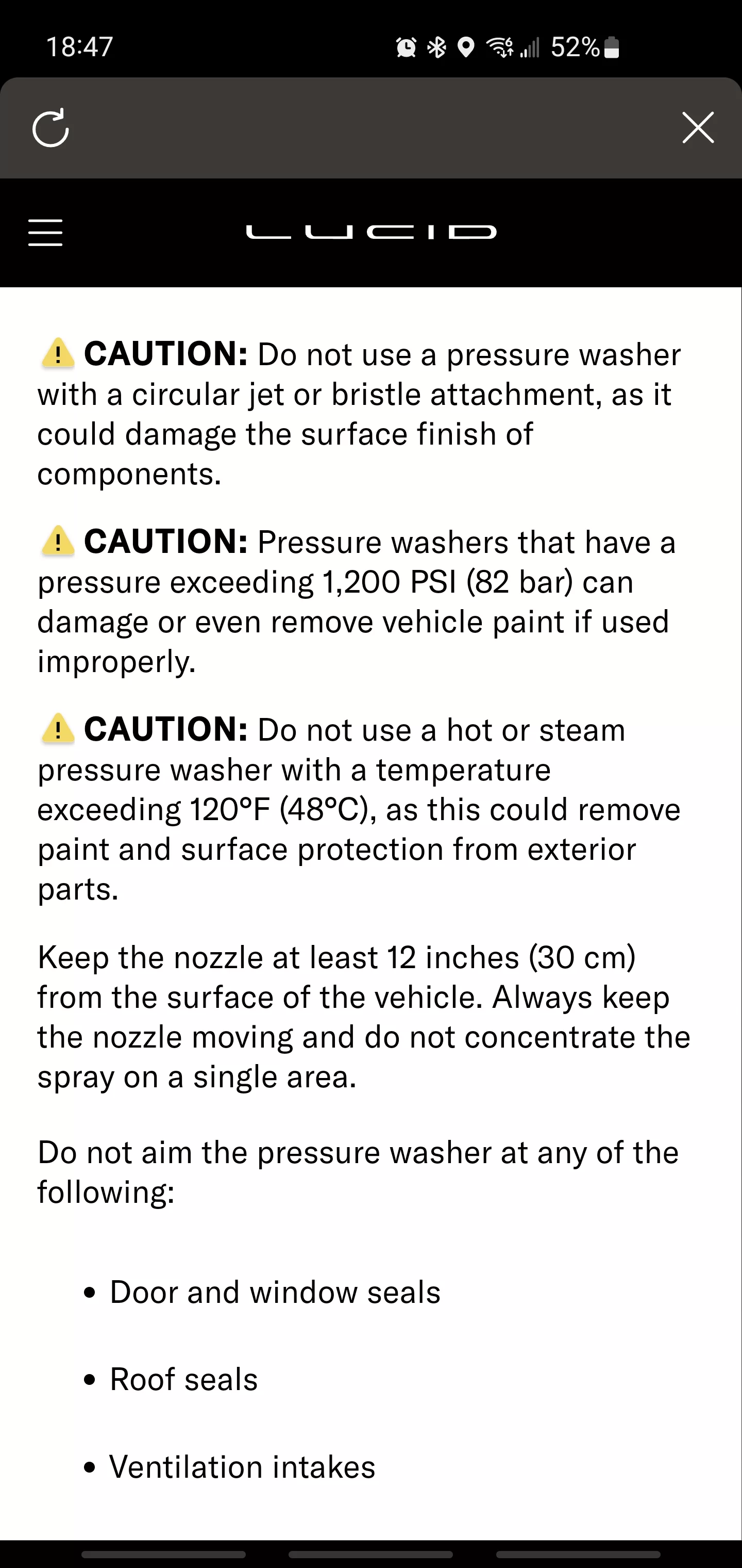

Echo hydbob on the Honeydew wash; it's terrific. Trinova makes a nice foam cannon that won't break the bank. Nice machined brass fittings. Bought cheap de-ionizer from Costco on sale. Also a cheap pressurized washer from Home Depot with a nozzle that "twirls" the water. The water here in Vegas is extremely hard. I don't pre-rinse, waste of water. I spray the foam on and let it work.
I think in the manual it says not to use that type of nozzle on a pressure washer.

What manual?
Paper or on the app. Someone with more knowledge would have to say whether circular jet is the same as spinning...
