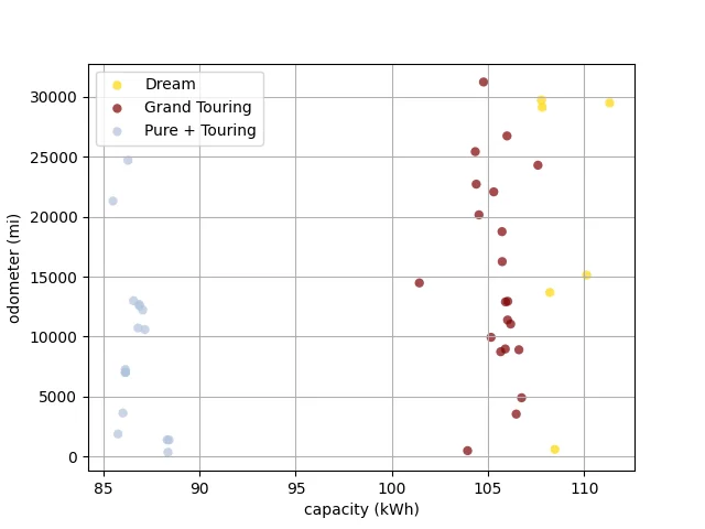

I posted something similar previously but am now asking for feedback from the group on this subject particularly from those who have driven EVs for many years and those who have ties to Lucid. What is the best way to determine loss of usable battery accurately? The only information I have is the obvious data provided by the car displays. This morning, for example, I left the house at 100% and drove (on the highway) nonstop. When my range was at 50% remaining, the 'since last charge' reading displayed that I had used 40 kWh. Assuming the readings are accurate, this implies that my usable battery is only 80 kWh. If this is the case, I've lost about 13% of the initial usable 92 kWh.
So my follow up questions are:
1) Is this the best way to quantify the loss?
2) Does anyone know if this is how Lucid calculates loss of battery capacity as it applies to the warranty?
Thanks in advance for your input.

Gents, is this the actual battery capacity information?
"capacityKwHr": 86.26999807171524
So, I have just over 86 kWh at 100% currently?
Also, the page is still open. What is the submit option? Is that something I should do? Will that information help us somehow?
More than likely "capacityKwHr": 86.26999807171524 is showing usable battery not total capacity. So the max is ~88.3. You can see this in the other thread, not 92. So you would have 2kwh of degradation not 6. Out of curiosity, how many miles do you have on your car so far?

Submit saves the info you see where only @borski and I can read it. This was originally for us to just map out the API and see what all the different values in different cars are, but we may also use this to plot the capacity data vs mileage and other factors, since that’s come up on here a lot lately.

Can I ask why you say the initial usable capacity is 88 and not 92? I was told by Lucid it was 92. And/Or can you point me to the correct spot in the other thread you referred to?
