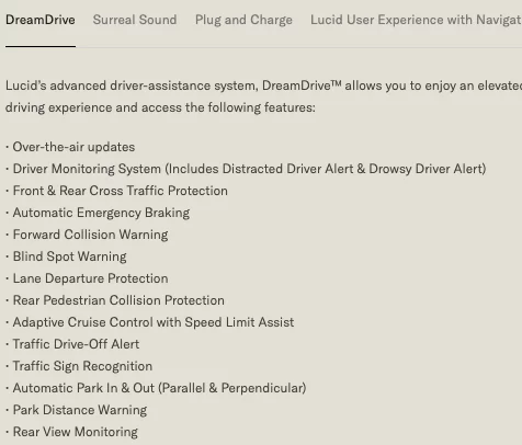

Wait, am I just stupid or does autopark not come with DD?
Wait, am I just stupid or does Auto park not come with DD?
It does. It's kind of funny that surround cameras and lane keep don't but autopark does. 😂 Most companies have it the other way. Auto Park is the "premium feature". Lane keep assist is the base feature lol

Because Auto Park uses USS and unlike some other company, Lucid includes USS on all it's cars.
