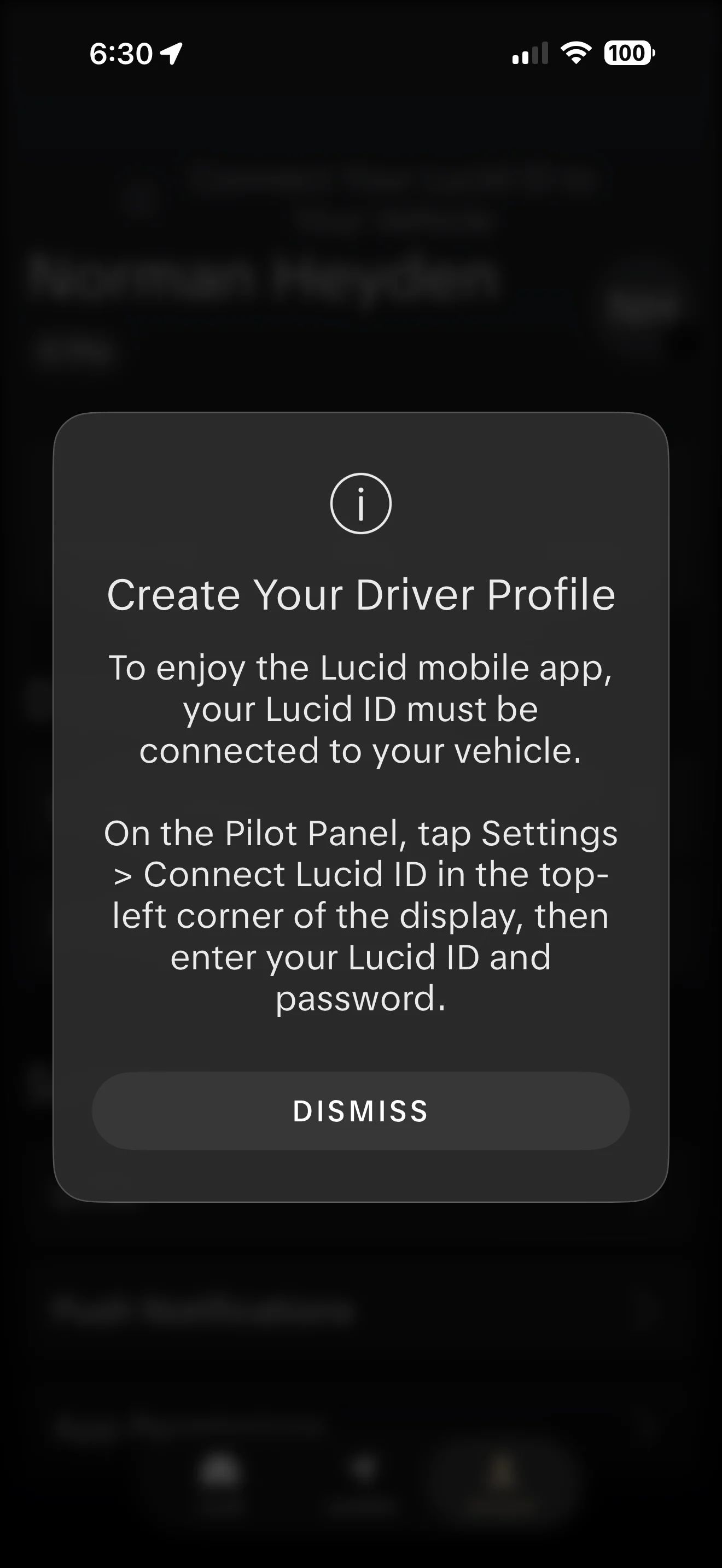

Updated to 2.9 without issue. Everything seems fine with my Mobil app yet I’m getting the following message. When I go to settings I don’t see a “Connect Lucid ID” in the top left corner of the display” or anywhere else. Thoughts?
View attachment 38687View attachment 38687
In the car, log out and log back in. It may fail first time you try to log back in. Be persistent. All settings will restore.
