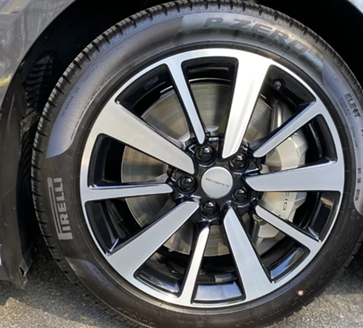

I looked more closely at my aero inserts; the center black cap is glued onto the insert, so I can see how this whole assembly would just pop off and on. When I picked up my car I had them install the black lugnuts and silver center caps (see pic). I didn't see the silver caps before they were installed, but it appears the silver caps actually pop into the center wheel hub on the car. In order to snap on the black aero inserts, I need to have the silver caps removed. I'm thinking this might require removing the wheel and pushing the cap from the reverse side (just a guess). I really like the look with silver center cap, but if I'm right about getting the silver caps off to install the aero inserts, it certainly complicates the issue.
No. I just did it. I used a razor blade to pop the center cap. They just pop out. Then you can insert the aero caps.
As you can see these caps can be popped out easily.

The silver caps will pop off. Just need something like a flathead screwdriver to pry them. Or a good small suction cup.
No need to take any wheels off.

Nope. Can leave them in place. Just need to pop off the plastic silver center cap and pop in the aero

The aero inserts are easy to snap off and reinsert. The silver cap and black lug nuts can be bought from Lucid directly for around $120 ( can’t remember exact price). You do not need to remove the wheels when putting on or replacing inserts. I put all four back on while it was parked in my garage and only took about 5 minutes. Just need to line up the hole in the insert with the stem of the tire so it fits right and you can inflate if necessary in future.
