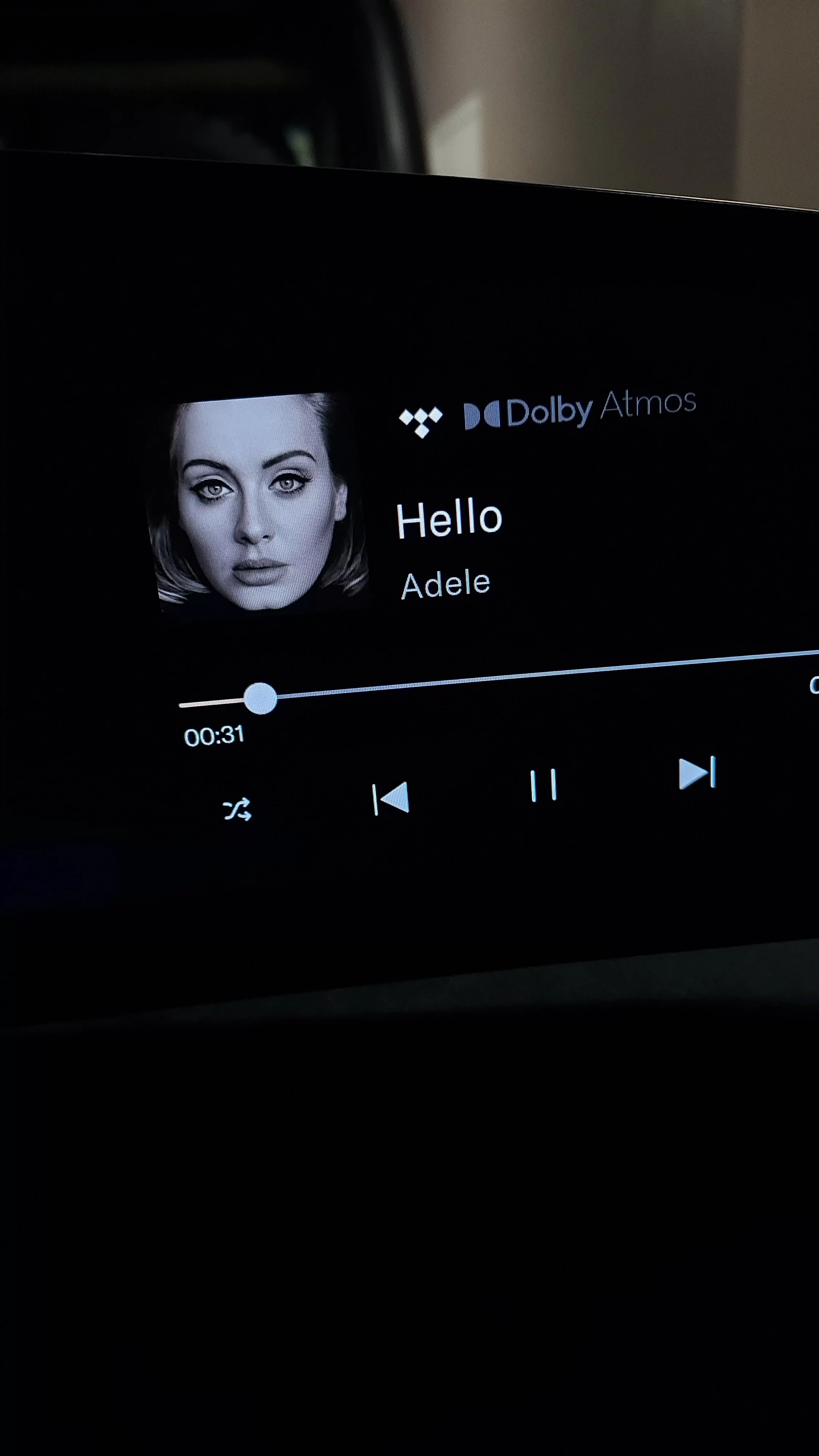

I don't want to derail this thread too much, but I think there's confusion between encoding and decoding. In order to have a recording IN Dolby Atmos it minimally has to have 5.1.4 ENCODED. You can take ANY signal even 2 channel stereo and upsample it to play on a Dolby Atmos system. You can easily take any CD recorded in 1995 and play it on a Dolby 7.2.4 and it will be decoded to utilize all the channels and sound awesome for example. Bluetooth does not support 5.1.4 encoding however the cars Dolby Atmos processor will upsample. I am looking to use Dolby Atmos ENCODED material which will require either the transport built in Tidal as an example or my own Player connected over USB. I don't want the EFFECT. Dolby 3.1 is fuzzy logic where center channel is created using info that is both Left and Right and using a crossover frequency to separate out the low frequency. That's how the Dolby Atmos soundbars work.
