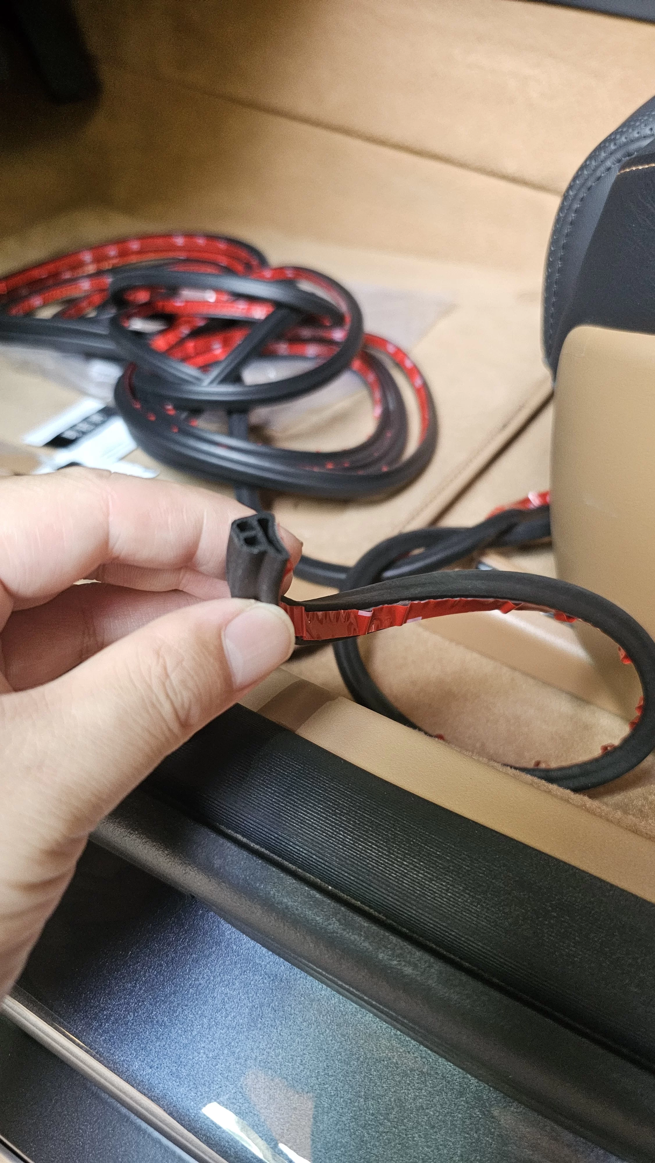

I had tried this same fix myself awhile back and didnt have much success. Hopefully you have better results!View attachment 31884
Bought this seal, sort of L shaped and fits under the original seal.
First run to meansure the cut but its holding in place ok without double sided tape.
Will commute to work tonight to see if it works before sticking it on.
Video link is how it looks complimenting the orginal seal.
Yes Yes totally feel on a $150k car we shouldn't need to do this, but other brand $150k car doesn't have the EV tech Lucid has.
I just want my car to be better without being too judgemental, my son said with music he couldn't hear the wind so why bother with seal.
The trim pieces, particularly the curved ones follow the lines of the car, are problematic. Most of them don’t seem to sit quite exactly right in my car. Coming from Tesla I’ve learned not to let it bother me but I can see them redesigning a few pieces down the road. The little clips that you can remove for roof rack install are hilariously flimsy.I had Lucid mobile service come out and they adjusted all my window seals so now I took all my additional stripping off and the car is quiet.
It's clear to me now that it was not the weather stripping that was the issue, it was the black trim pieces not sitting correctly.
