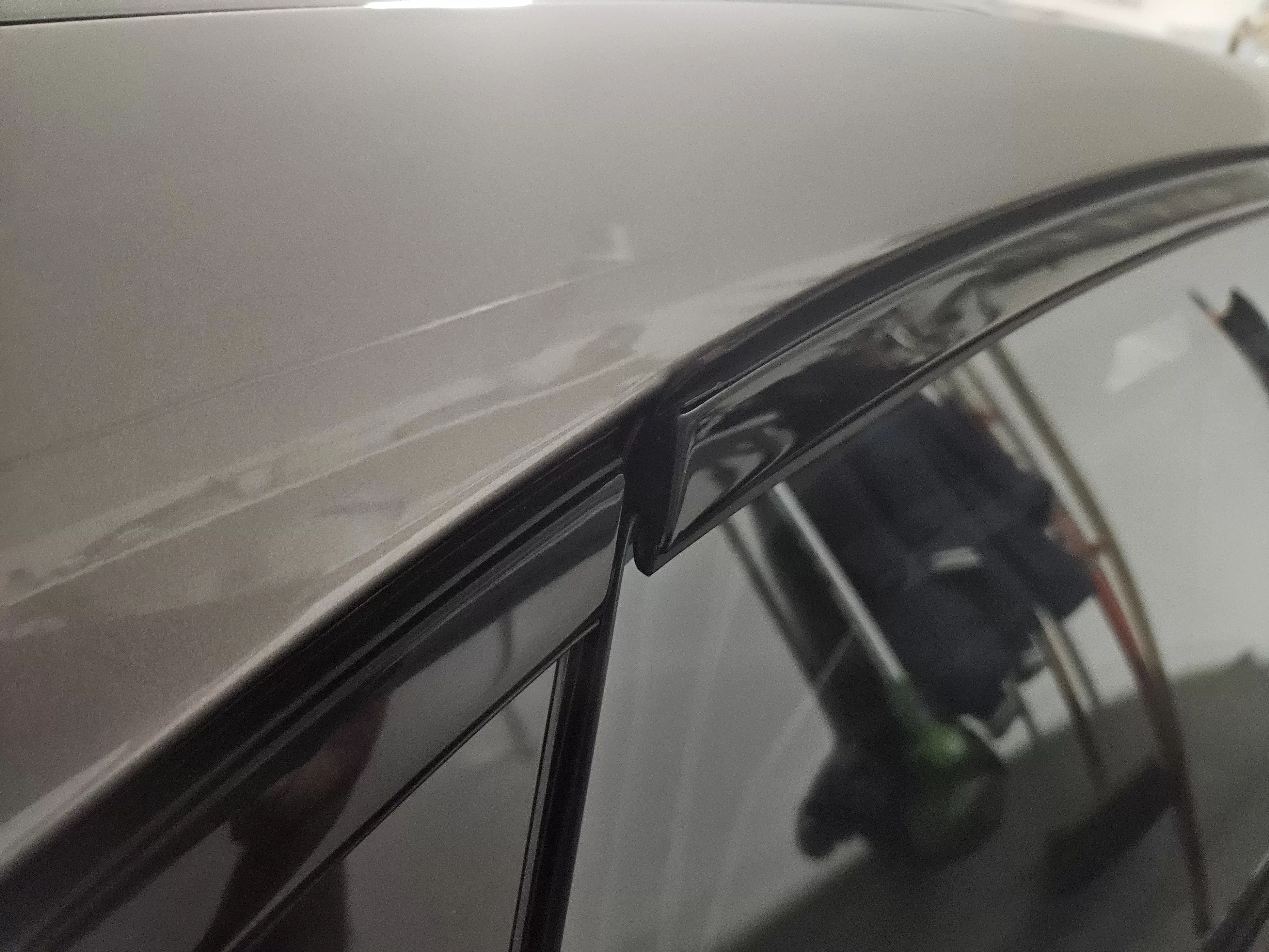

I have wind noise from RR window on 2024 Touring.
Pic shows gap in trim above RR window. Much larger gap than LR.
Have appt at Svc on Sat.

Work summary states: Replaced right rear glass run. Okay at this time
I can tell that wind noise is reduced.
Rep would not have trim on LR replaced because it is "within spec".

It is obvious from pic that trim above RR window is not "within spec".
A test drive is a waste of everyone's time. I don't know why rep took the car to service area & returned with
nothing having been done.
