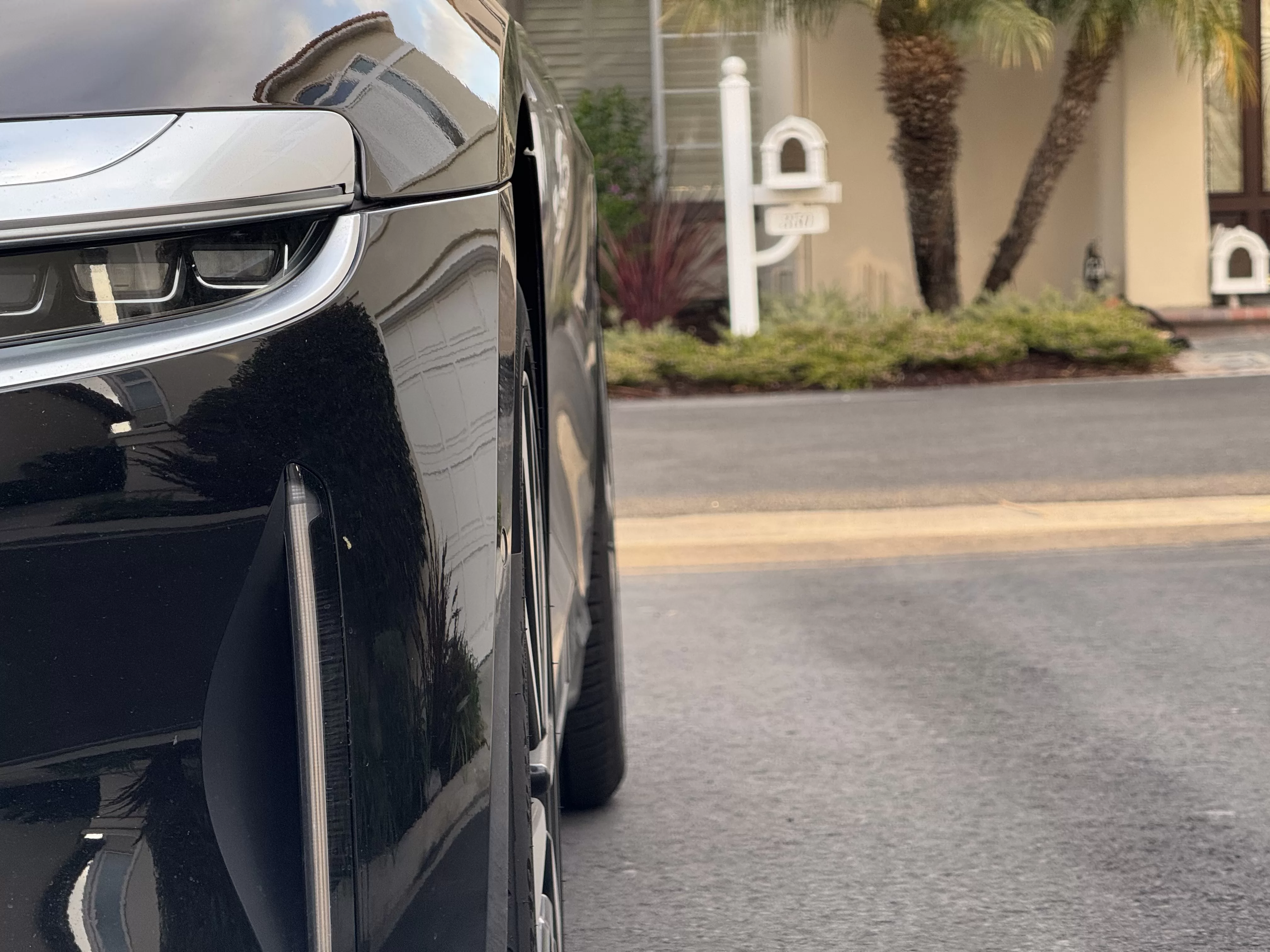

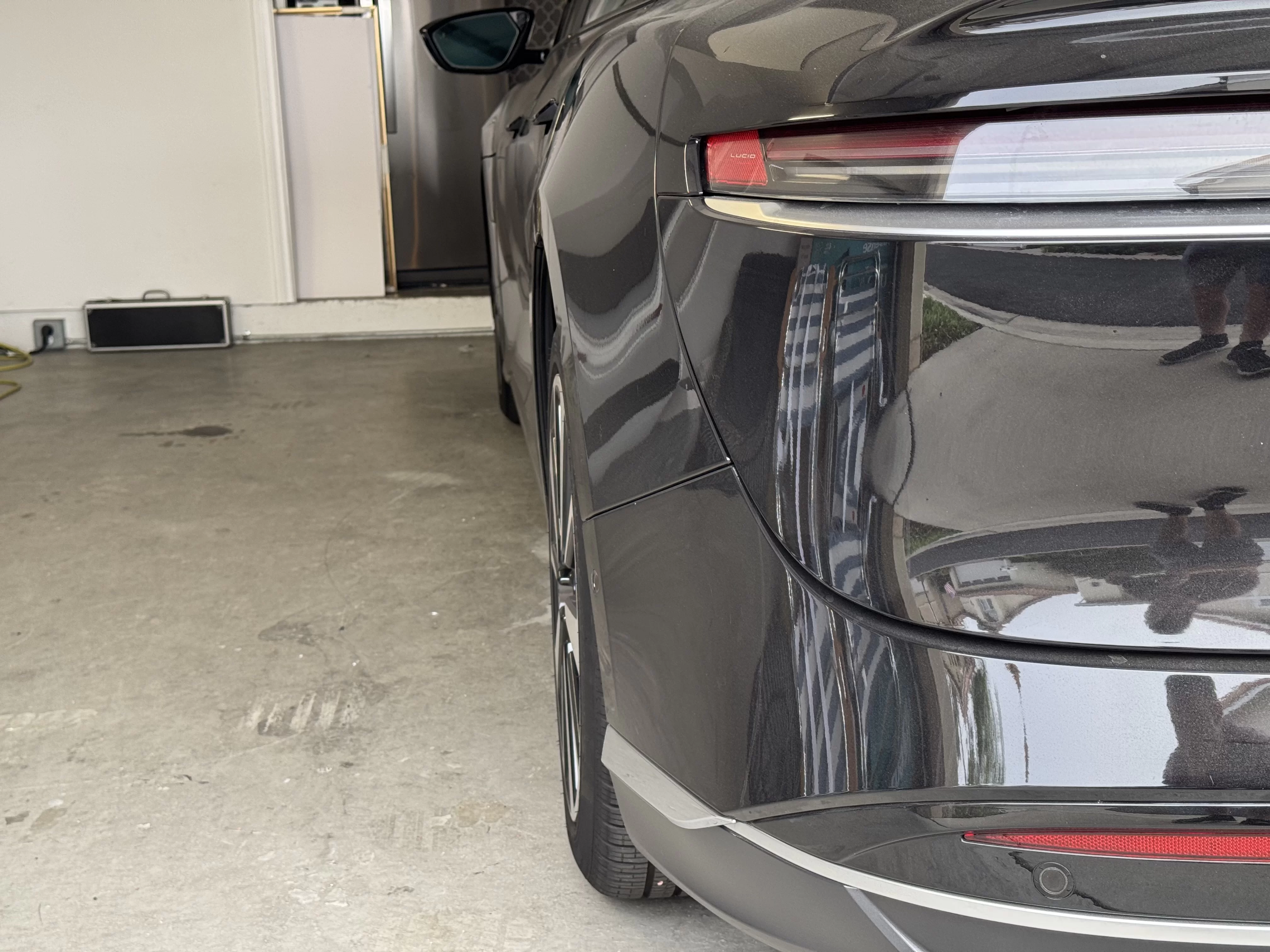

Before:

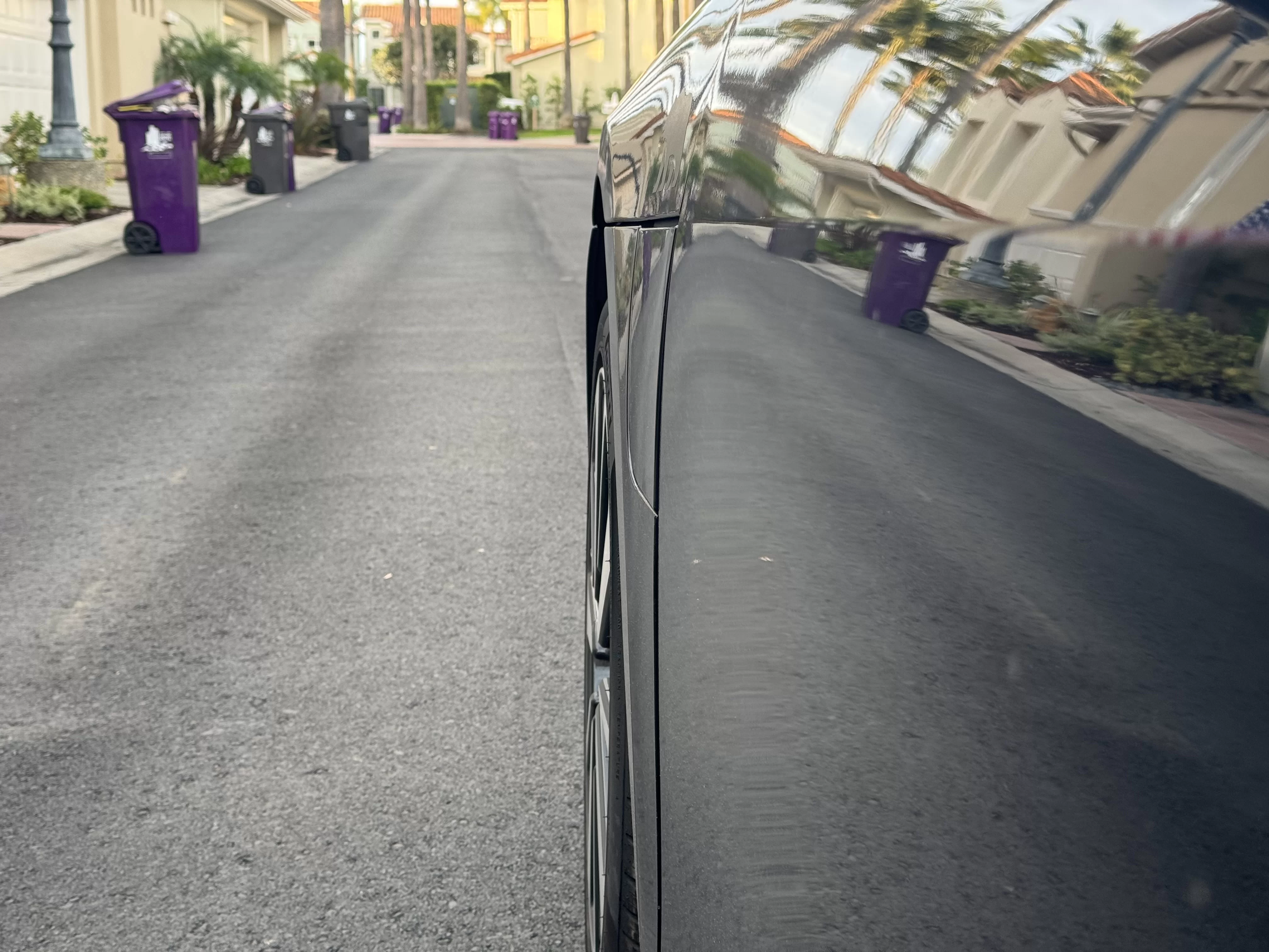

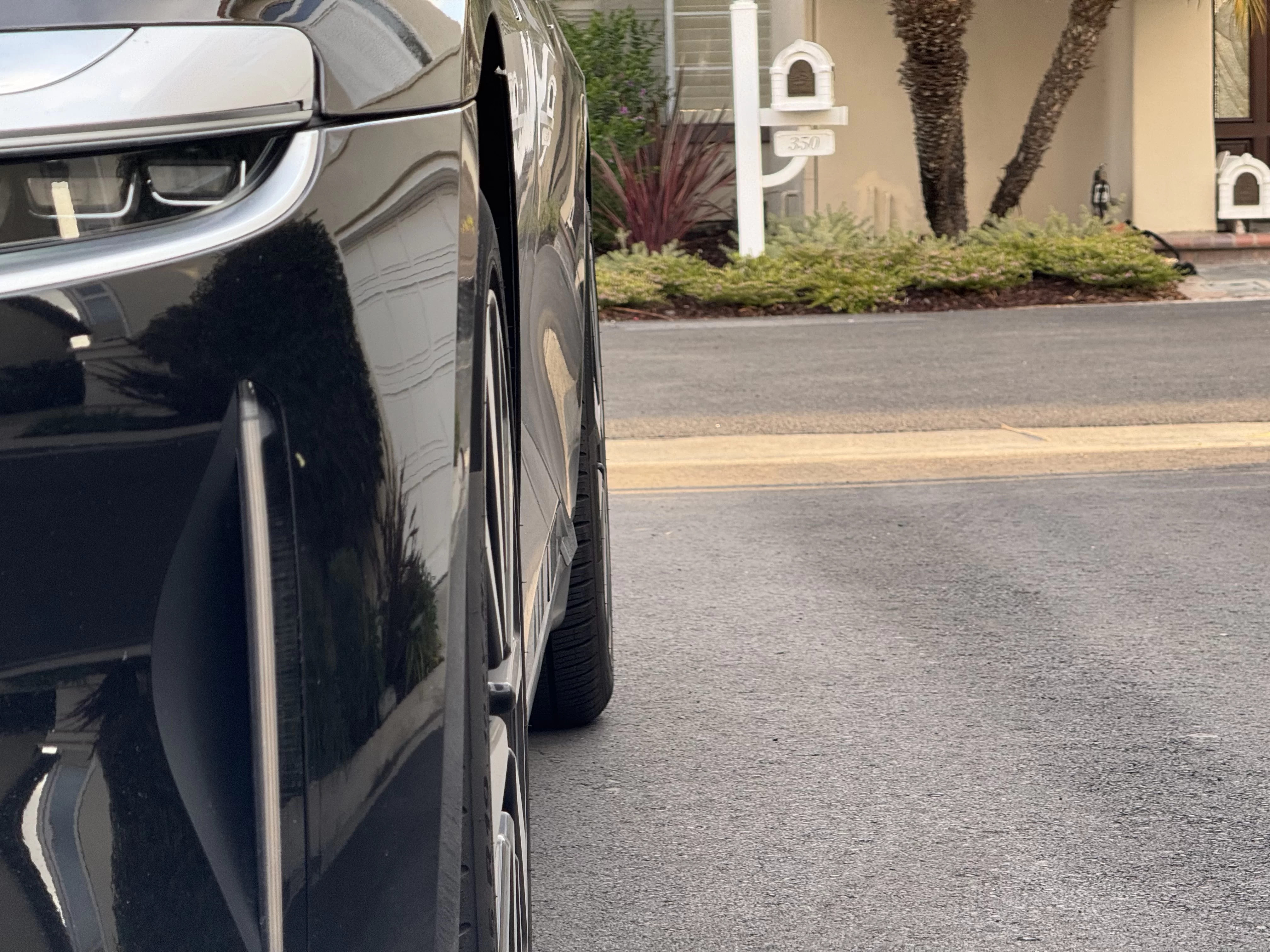

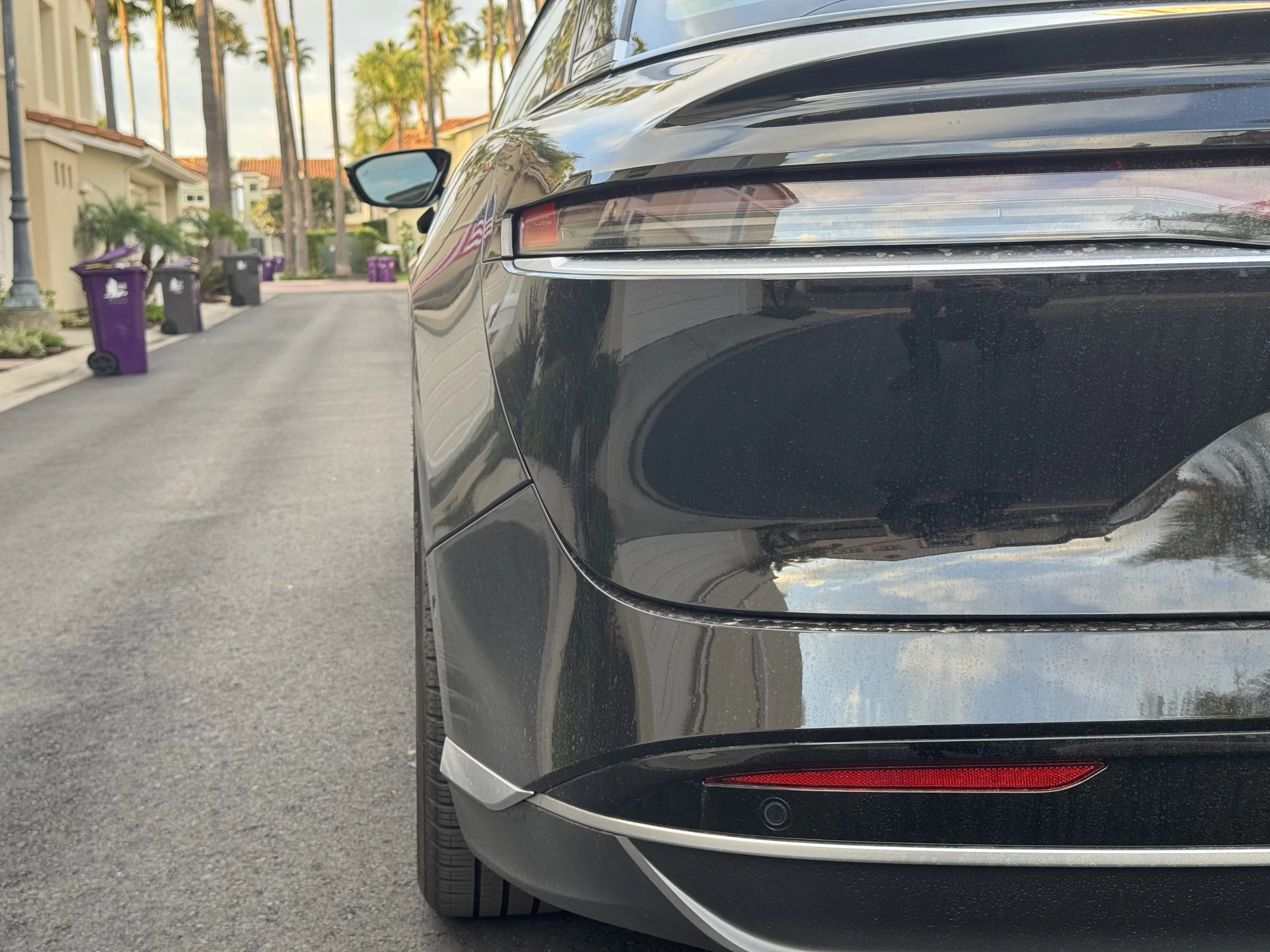

After:
Sorry. I'm being dense here. Is the objective to have the wheels extend a little further beyond the body?
I had put 1/2" spacers on my 1999 Pontiac SLP Firehawk for the rears because I couldn't fit 315 width. I find you'll get a little understeer but overall a better RWD experience and the car will be less twitchy. I'm curious how the dynamics change it! You could likely put a wider rear 19" tire.

Before:
After:
Much better stance!!! More pictures please.

That said, it looks like the rear wheels stick out a bit (hard to tell from the angle), if so that's an issue and should be corrected. Wheels should be flush at most with the fender lip.
