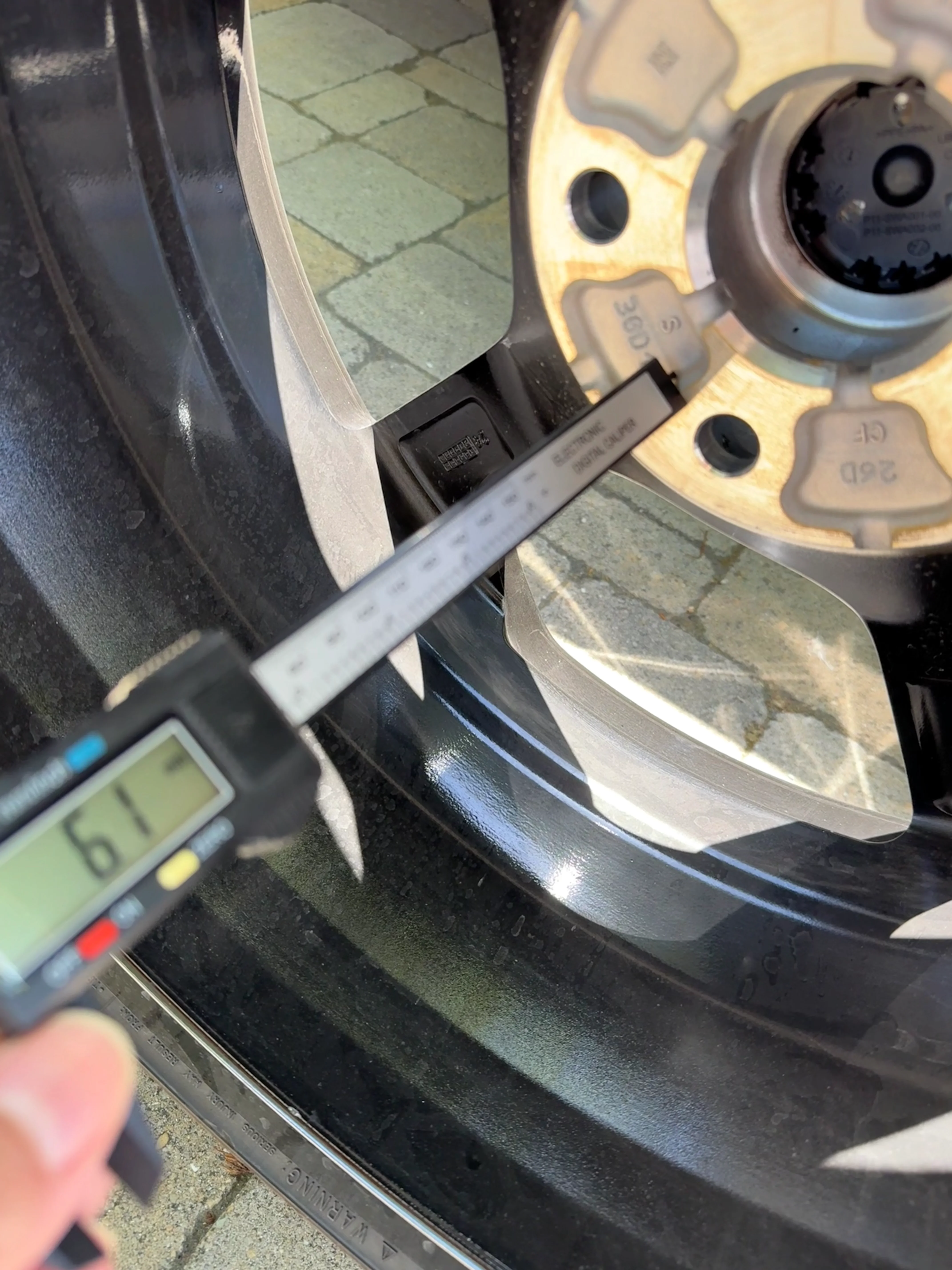

Also just fyi the backs of the wheels have pockets as you described. At least on my AeroSports:
Correct … thread engagement is important so the only time the factory studs can be used to secure both spacer and wheel is if the spacer is thin enough.
A 20mm spacer is almost an inch thick so he’s probably using spacers similar to the ones you have linked.

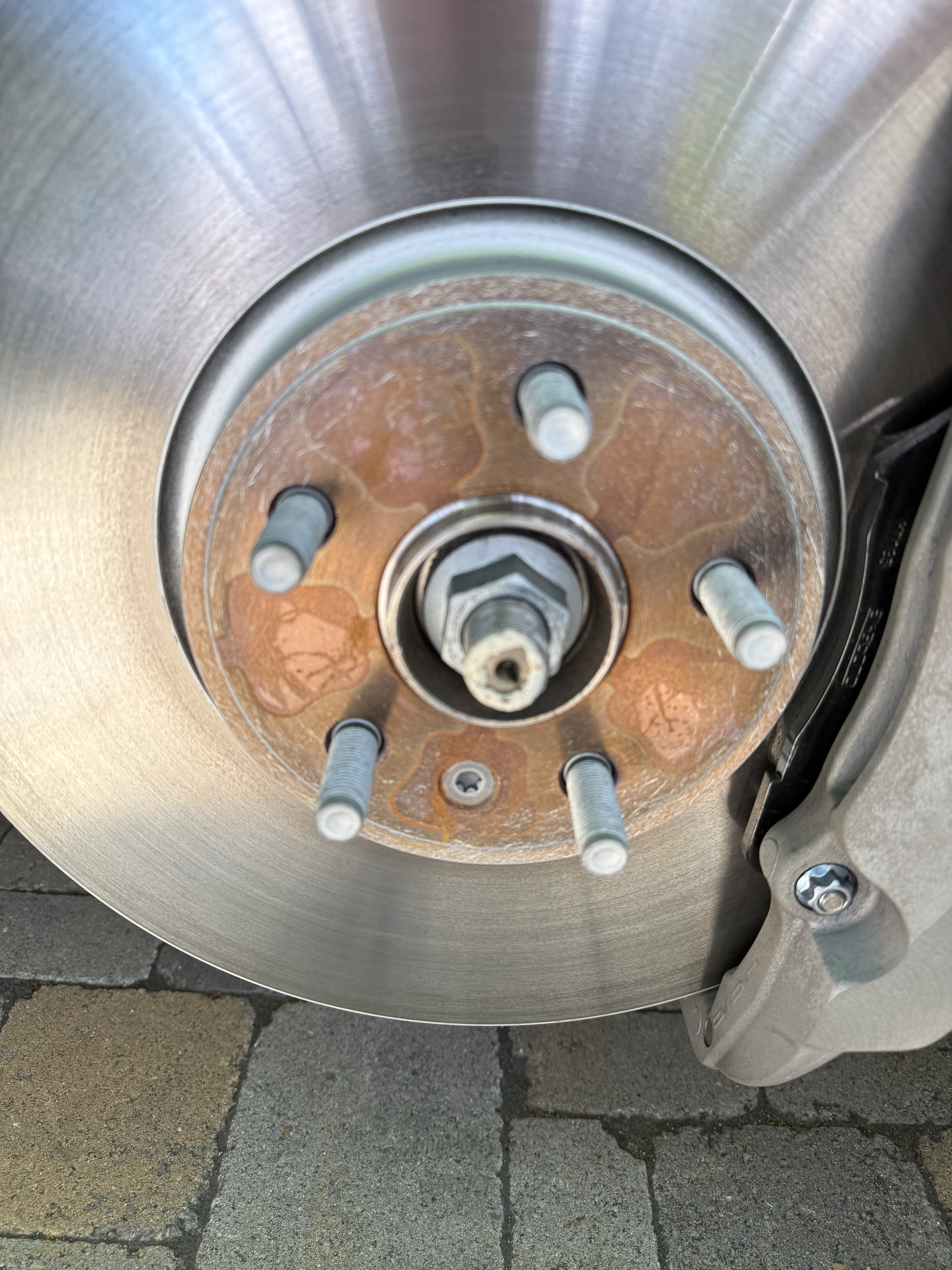

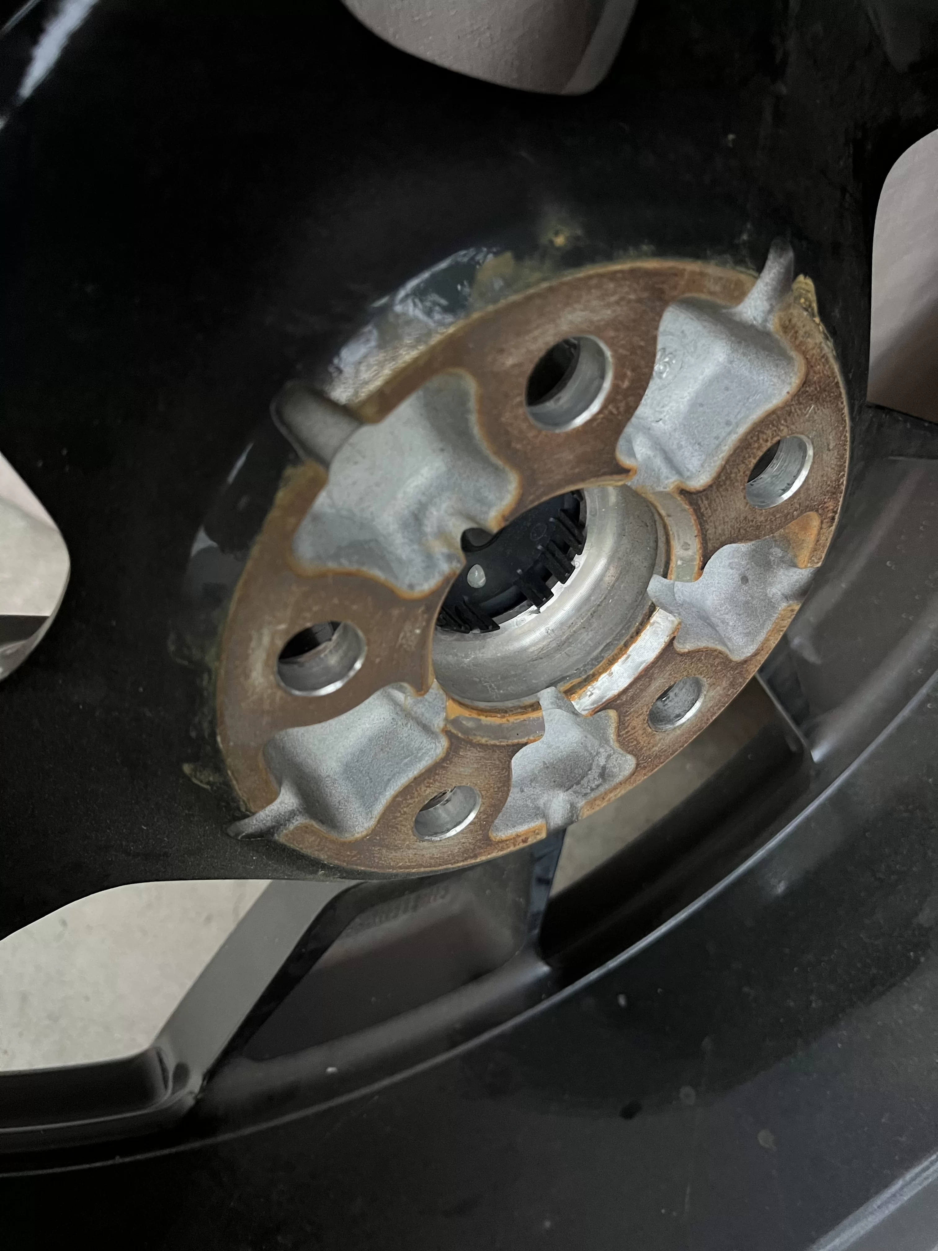

So you inspired me to go take my front wheel off and take a look for myself, and indeed the 20" wheels have the pockets as well. The pockets are 6mm deep at the shallowest point. Your 21" aero sport wheel pockets look much deeper, maybe 10-15mm!
That being said... I forgot to measure the length of the stud which would inform you the minimum spacer width required to fit the wheel over the stud, accounting for your particular pocket depth. Based on the image and counting the M14x1.5 threads + the end of the stud, I'm arriving around 30mm in total stud length, but it's hard to tell because I do believe a few threads go below the rotor surface.
So I think for me (with the 20" aero lite wheels)... because the pockets are so shallow, I would need at minimum 25mm spacers, which would cause the wheels to poke out way too far for my liking, which only leaves me with the 2 options I mentioned earlier. Sadly, I may just have to deal with the fitment as it is since I'm leasing.

The Lug studs measure 1.5 inches in length. I have a winter wheel and tire package from my EQE (255/45R19, 48 offset) that I'm trying to fit onto my Air Touring. I am using wheel adapters since the PCDs don't match (5x120 vs 5x112), but the 25 mm adapters I initially ordered didn't work since the studs protruded too far past the adapter and my wheels do not have deep pockets in the back.
So my solution is ordering 1.25" (31.75 mm) hubcentric adapters, which should leave much less of the stud exposed and allow me to install the wheels. They will poke out a bit, but they also did so on my EQE with spacers, and it actually didn't look bad and improved the stance.
Thanks for the confirmation - I did end up messaging the company I linked above and they confirmed that the studs are indeed 1.5" and any spacers less than 35mm on the 20" wheels would require the studs to be cut (at that point, seems easier to just switch the studs out IMO).
