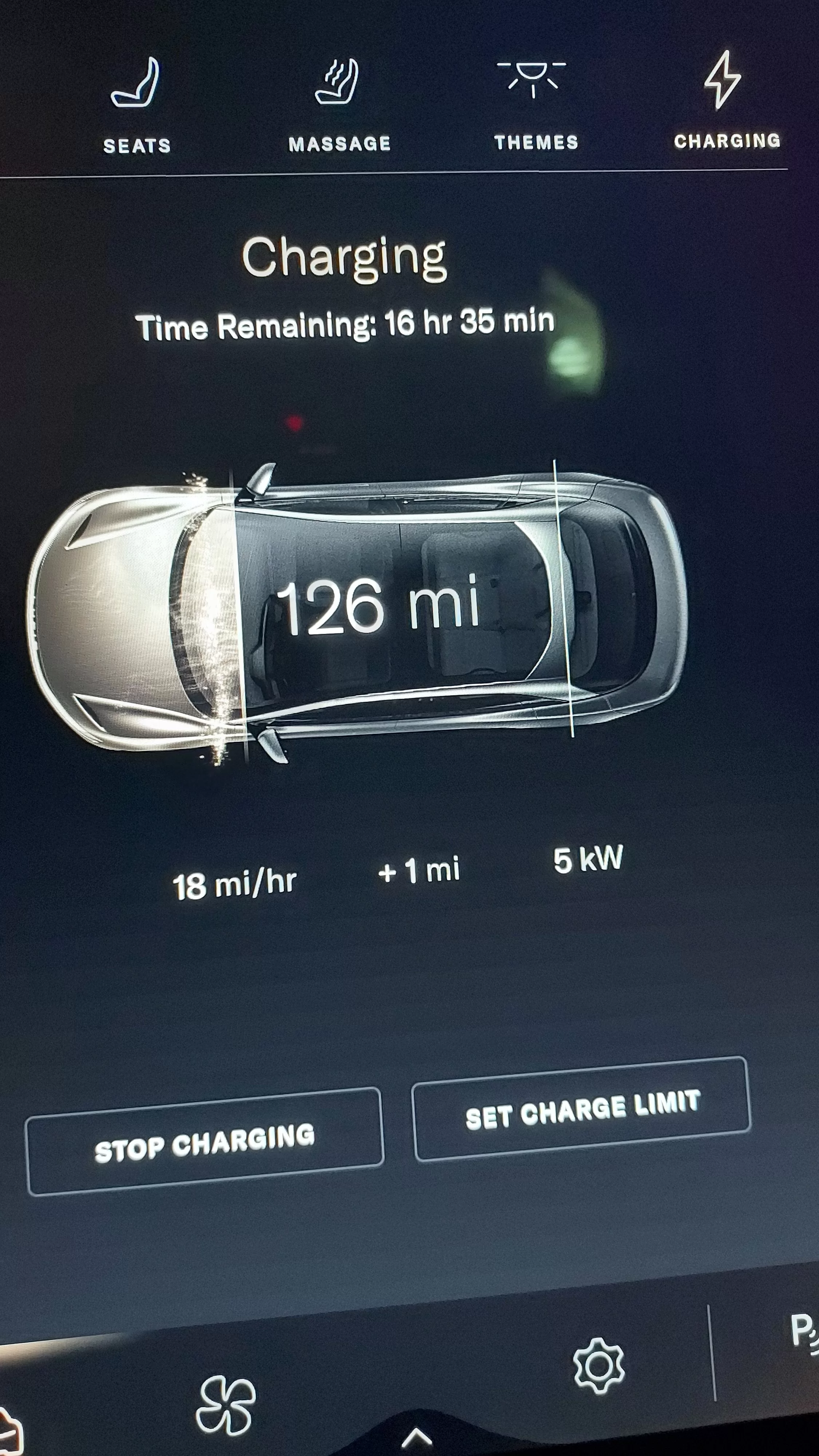

I decided to plug in and see what the rate ended up being. I have a Chargepoint home flex on a 30 amp breaker.
@hydbob, If your charge rate is 5kW, then the car is drawing about 5kW/240V = 20.8amps. It's below the limit of 24amps that you should not exceed (for the 30amp breaker you have). Although, I'm curious why it did not go up to 24amps and what is setting/limiting that. I think after the recent updates, it is showing the power being drawn from the wall (not going into the battery).
I believe it shows the power into the battery, which doesn’t account for power loss. My 48A/11.5kW charger only supplies about 10.6kW of real power.
