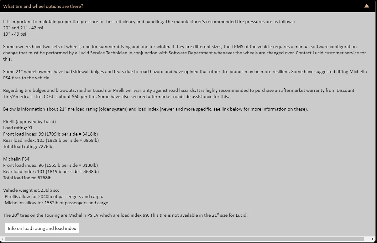

They won't come up for the Lucid if you search from them. And you'll need to find a tire shop that mount and balance despite the rating not matching OEM specs. Would recommend reading the FAQ here (https://www.lucidupdates.com/faq.html) to alleviate any concerns around the lack of rating.

This is exactly what I needed to dive into. Post the initial pop I experienced, the Pirelli's have been fairly solid. I hate to say this, but it doesn't seem like a good time to switch away with the weight rating differences... Not until more appropriately HL tires hit the market for this sizing.
I'd feel better about getting Pirelli's that are properly manufacture registered under warranty.
You can explore going up in width slightly to 255/35ZR21 and 275/35ZR21 Michelins respectively, and find the correct speed and weight ratings. Those are common on the Model X, which has similar power and weight as the Lucid. The HL rating that Lucid attaches to the OEM tires is only available from Pirelli.
