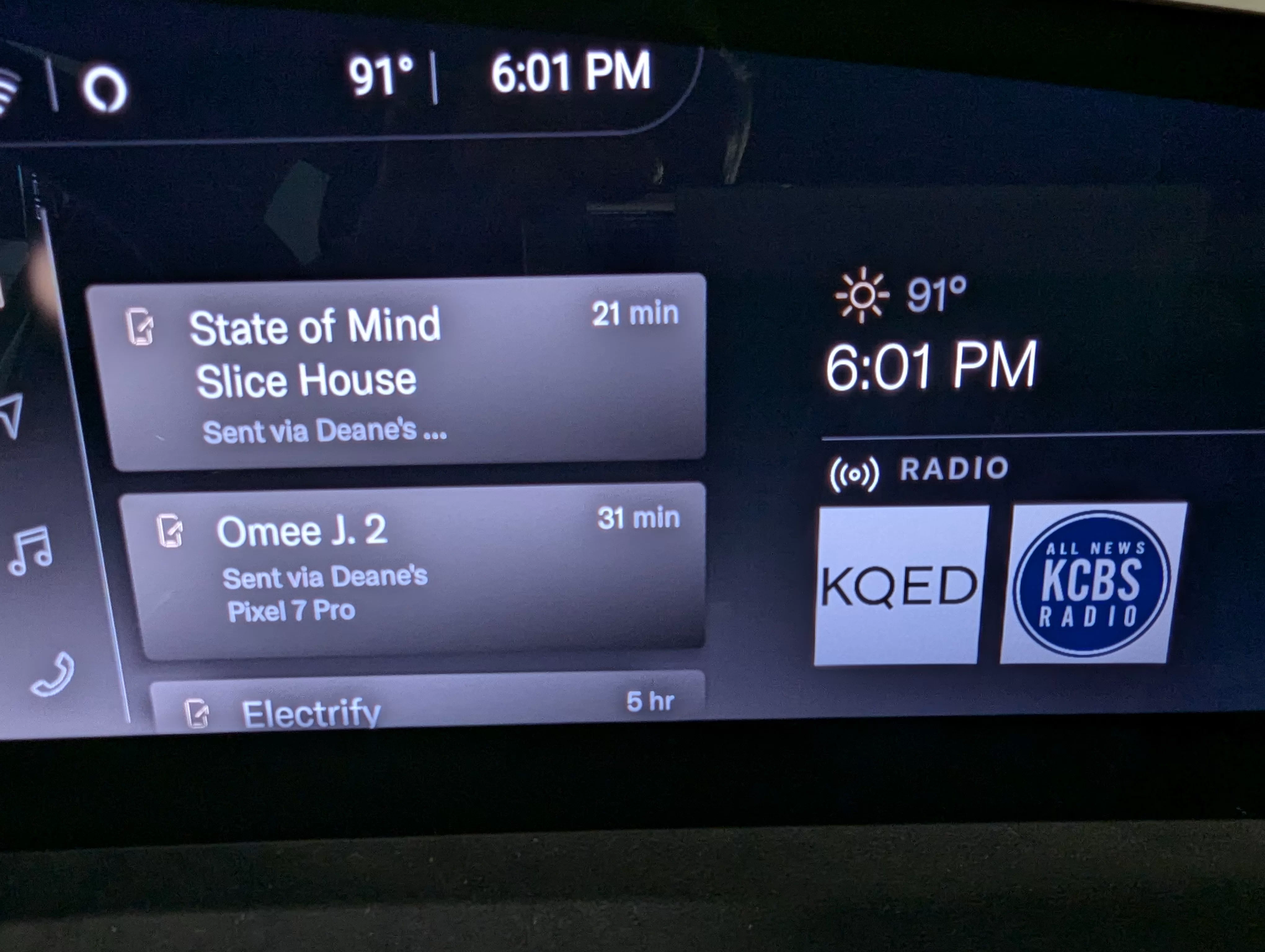

Just curious, why don't you use the Lucid app. I've never has a problem sending the route from there...I had a fairly serious and repeatable error with sending a destination from Google Maps to my car this evening.

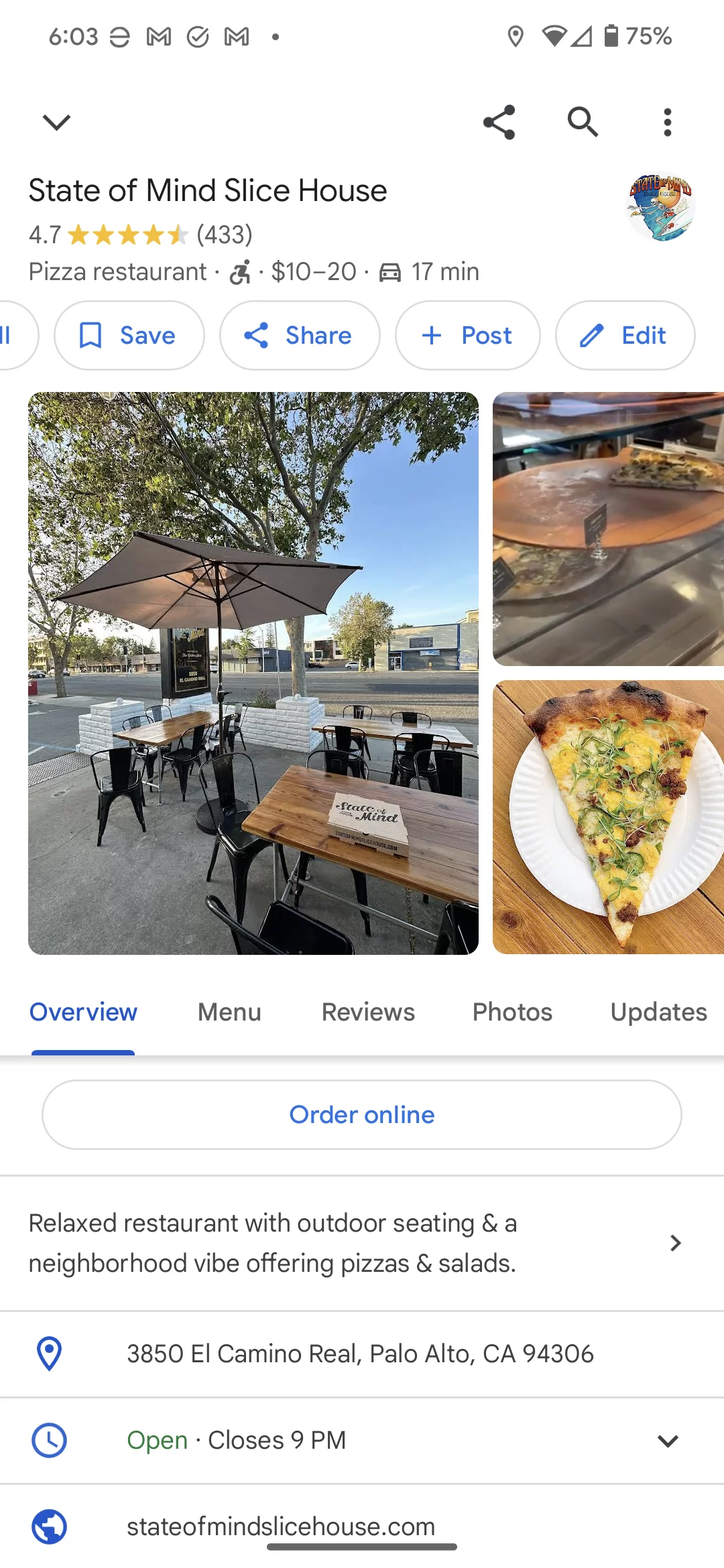

I found my destination on Google Maps on my phone, used its "share" button to send the location to my Lucid. Got in the car, pressed the corresponding destination popup, and started driving. We were about two blocks away from the nav's destination when we realized it wasn't our destination. Instead of the Palo Alto eatery we were aiming for, the nav tried to take us to a bus stop in front of City Hall, about three miles away.
The correct destination on Google Maps on my phone was:
State of Mind Slice House, 3850 El Camino Real, Palo Alto, CA 94306
But the car's nav took us to a location near the center of Palo Alto, nowhere near El Camino Real. Photos attached of the inputs to the car.
There were no error messages from my phone or the car while this happened. It's easy to repeat.
This isn't the first time we've had this issue. I will now 100% verify the destination the car thinks it's driving to, even though I was certain I had the correct location showing on my phone when I sent the destination to the car.

Late to the conversation but I have this happen all the time. Instead I use the Lucid app to punch in the address that I copied from Google maps and then hit "send to vehicle"I had a fairly serious and repeatable error with sending a destination from Google Maps to my car this evening.
