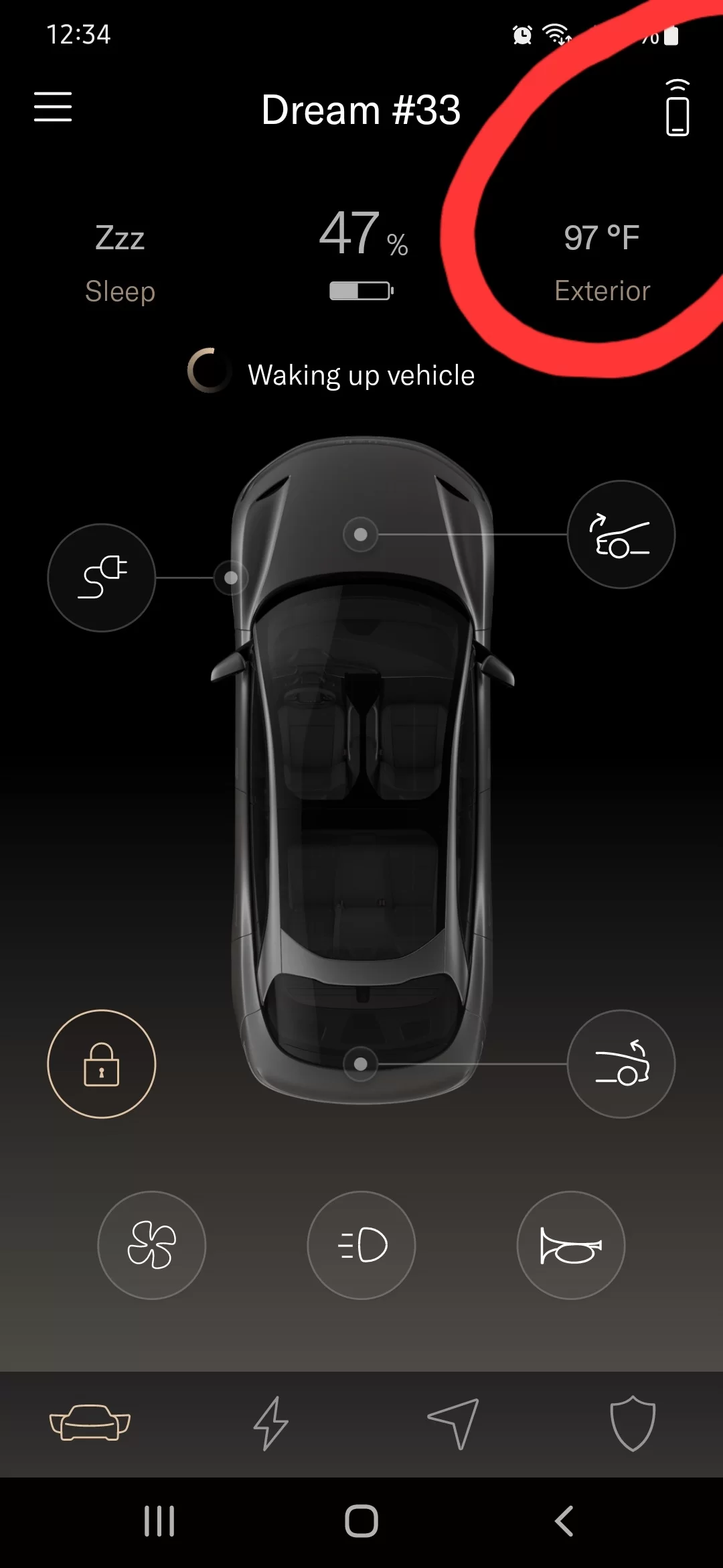

Whenever you fire-up the app, it wakes the car and the status shows as "parked". While it's doing that, it does say "Waking up... may take up to 30 seconds". You don't see that?
I usually way overdo things, so each fob is in its own Faraday pouch inside a Faraday box inside a drawer in my house, about 50’ away through three walls.
When I used to open the app, the car would show zzz/sleeping , transitioning into waking and then to park. Not only was my app showing the car staying “parked”, but the car was showing the same status for Customer Care on their end. That was what generated one of the comments from them that “it shouldn’t do that”. They were trying to watch it go into sleep mode, but said something about it not getting past “wink”, whatever that means.
