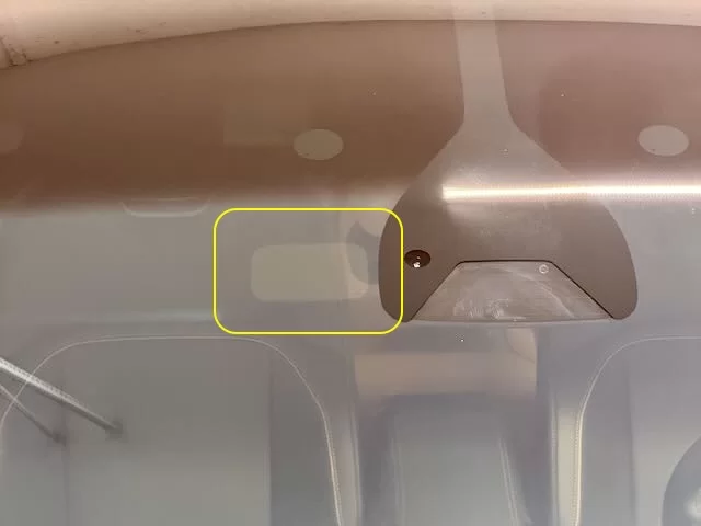

I plan to try mounting my EZPass behind the Glass Cockpit and have ordered the silicone black wrap for the transponder which arrives tomorrow from Amazon. But for what it's worth, I noticed that there seems to be an EZPass-sized gap in the windshield coating conveniently located to the right of where the rearview mirror is such that it wouldn't be in the driver's view. Still unsightly to see the transponder from the outside but could be a solution for those still having difficulties. Here's a picture of the windshield, taken from the outside, with the gap indicated in yellow.
I have the same on the windshield of my 2025 AT also. Been reading they've gone away with metallic windshield, but seems like it's back or they are recycling old windshield for some of the 2025's? I had placed ez pass transponder right below the rearview mirror with no success and was wondering what the heck was going on. I wonder why metallic windshield is back with 2025's
