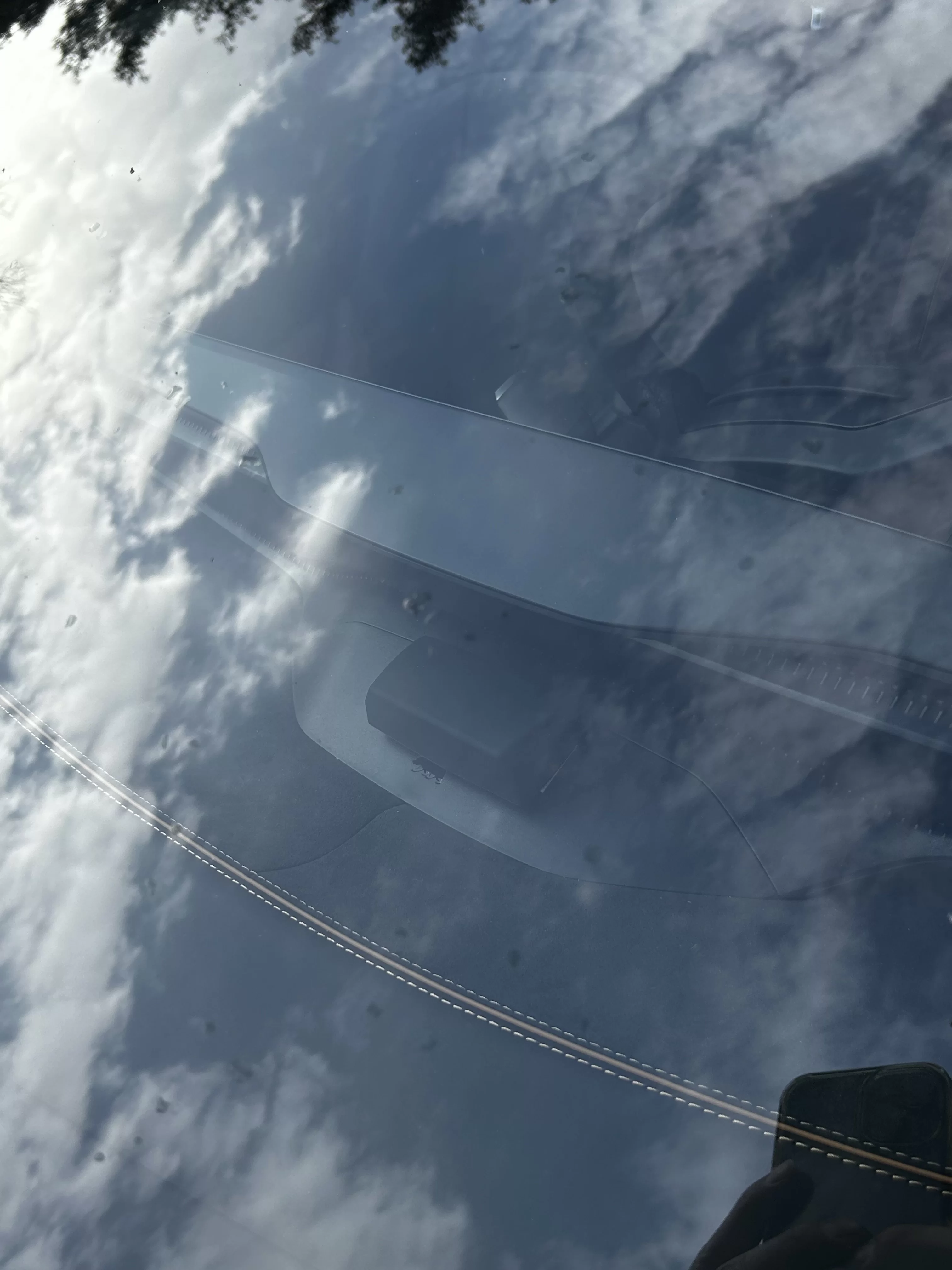

My EZ Pass (originating in VA) would not work through the presumably metallic windshield coating. The most effective spot (though not most aesthetic) is the passenger side lower corner. There you will note a section of the windshield that is lacking the metallic coating.

The windshield was revised since the days of DE. My Touring, build date 1/2023, doesn't have this issue. (Saying this for the benefit of people who may read this and worry that if they buy a newer Air they'll have a problem.)
For the record, I have a March 2022 build date GT that has the metallic windshield.
