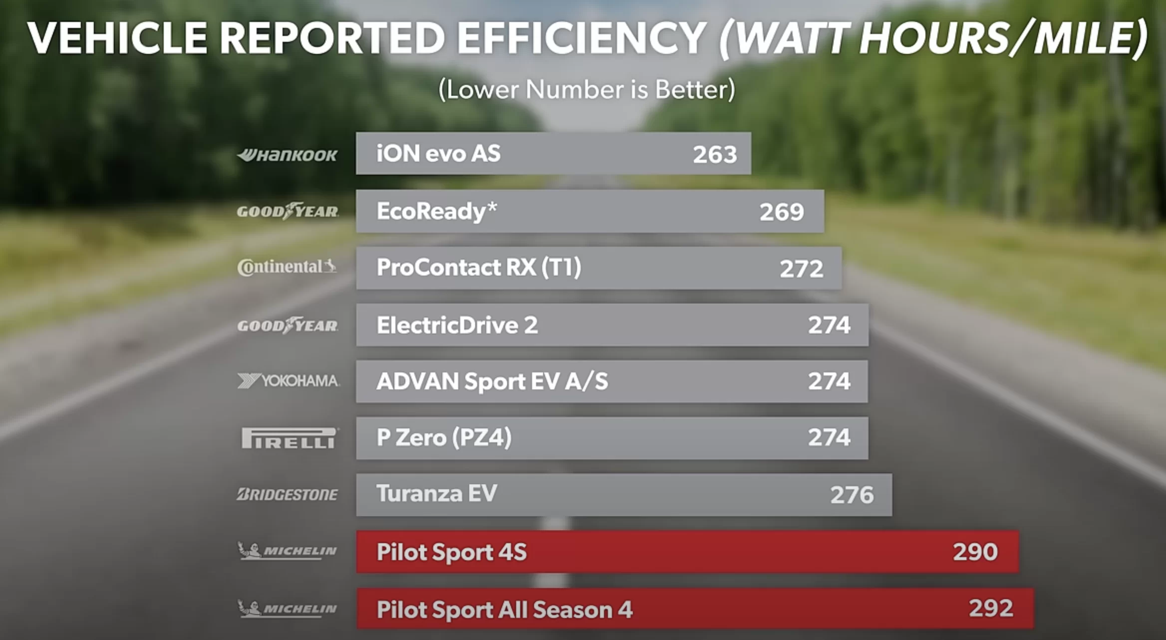

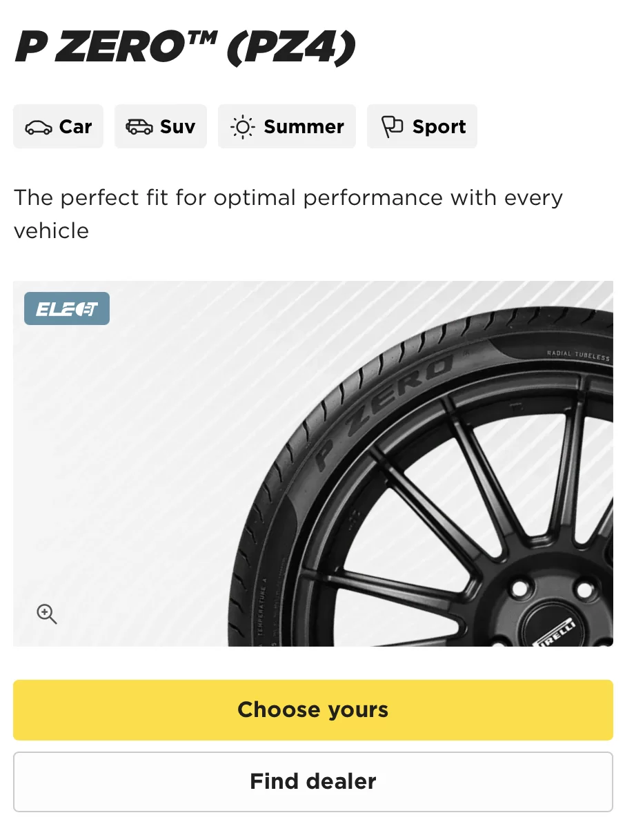

The P Zero PZ4 is part of Pirelli's Electric tire line:
And it might actually be pretty good on range. Note its range test results in a 100-mile test (on a Tesla Model 3) against the class leader, the Hankook iON evo AS that comes on the smallest Gravity wheels. And it ran right in the pack with EV tires from Goodyear, Yokohama, and Bridgestone.
